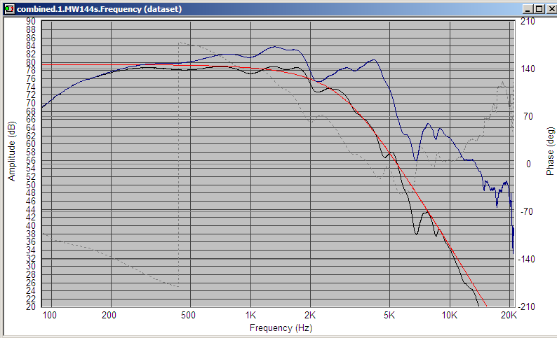

That daytons breakup is very nasty! I was going to suggest using a notch filter, but after seeing that curve I'm not so sure. you might need two tuned a bit to each side of the peak, as getting something broad enough would be difficult.
attached is a plot comparing original vs with notch filters and a some what standard 2nd order filter.
Tony.
Tony.
