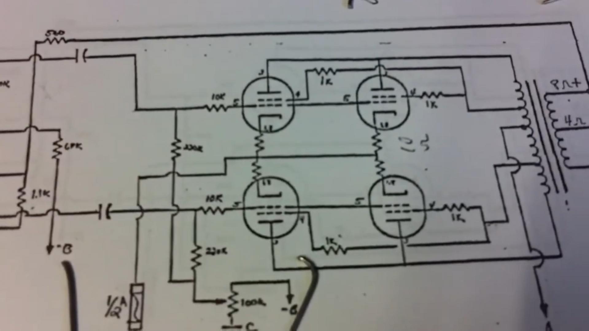

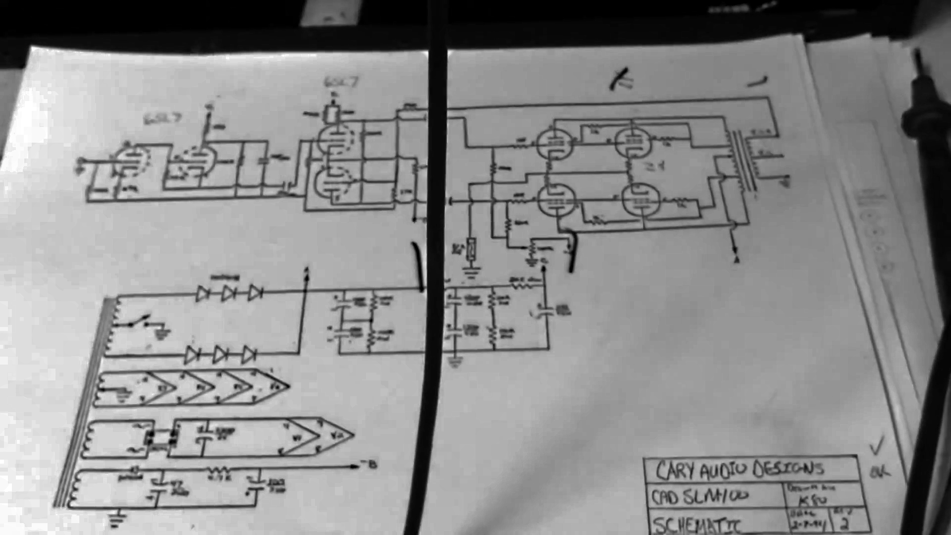

~Inspect & Repair~ Cary SLM-100 Tube Monoblock Amplifier - YouTube
There is a schematic in the above clip, but it's too blur, and not much data. Maybe OP will fill up the actual value of the components and operating points? So sim can be updated and for KT120 can be done as well.

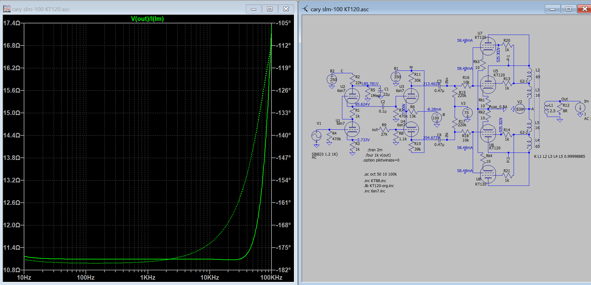

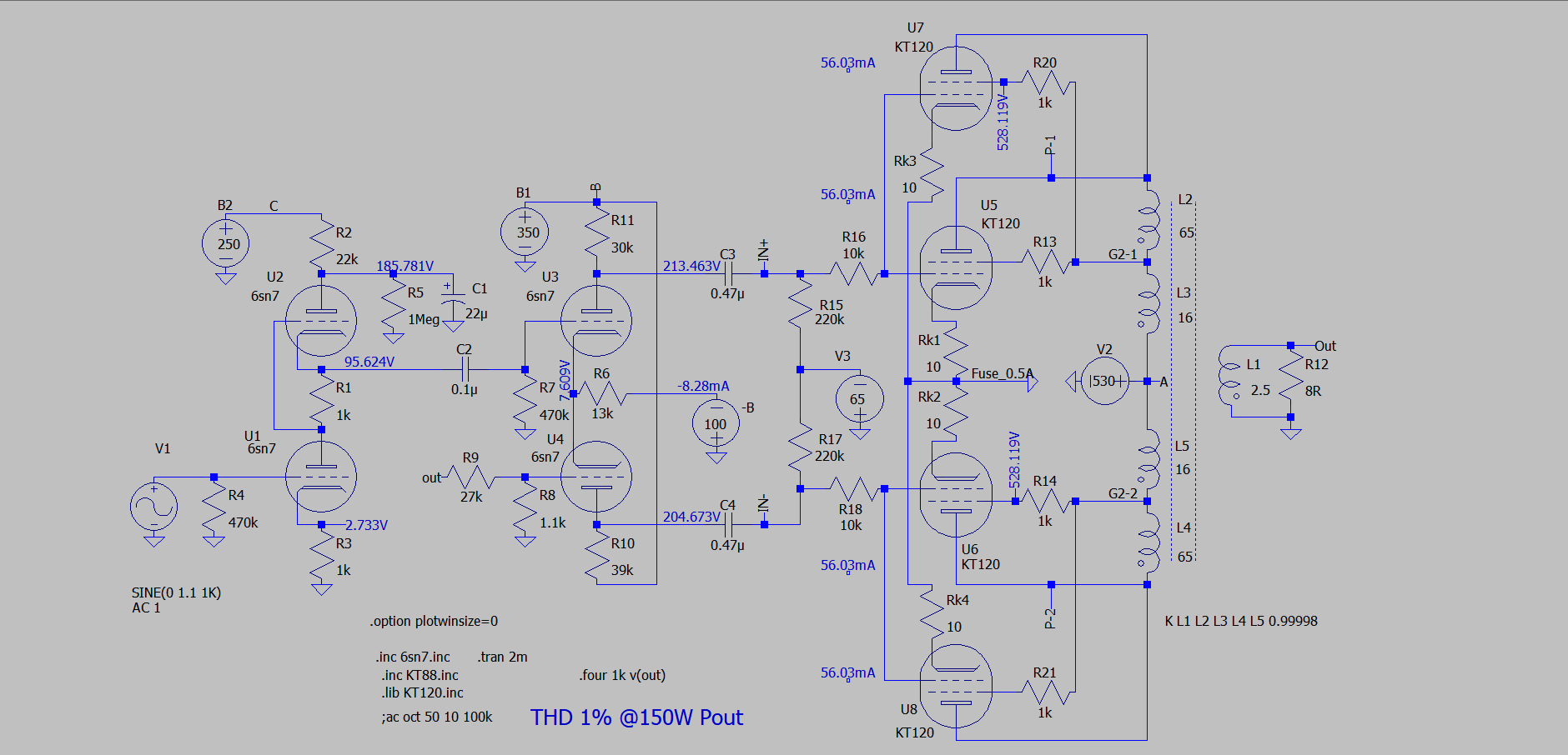

Thank you for your given feedback! Your LTSpice is very close to me current implementation. So simulation should show what's going on with KT88, KT90 & KT120. Like the shown freq. response as given from Stereophile.

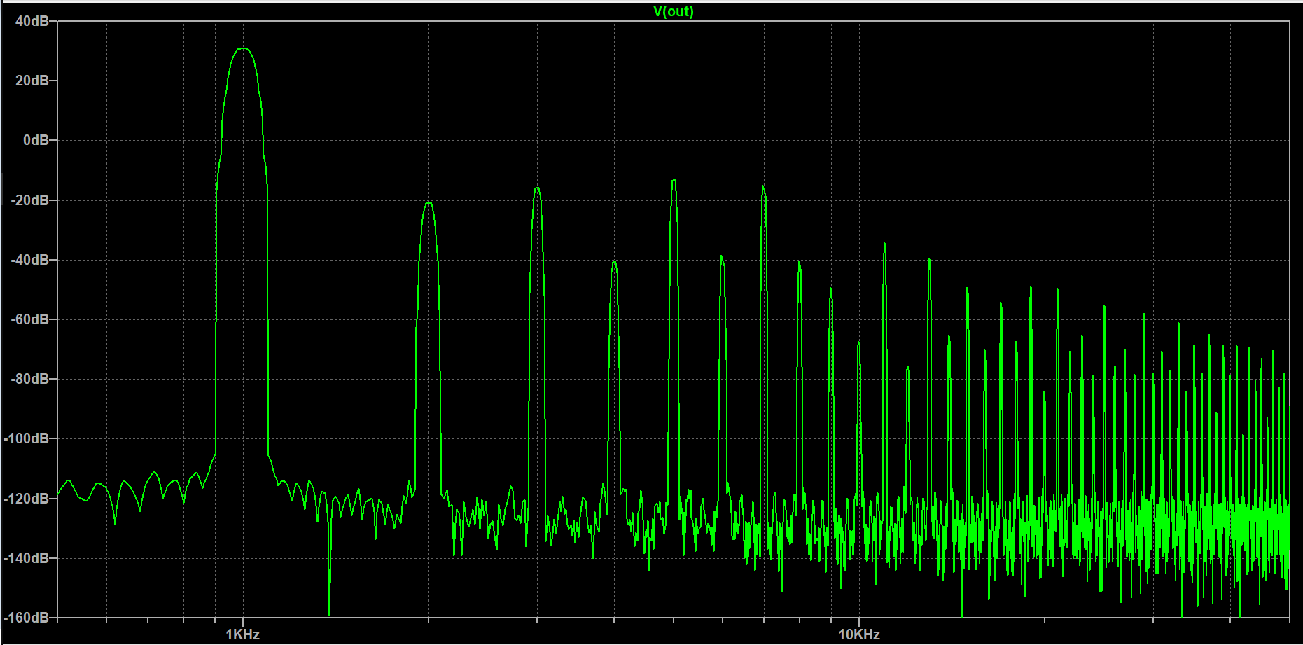

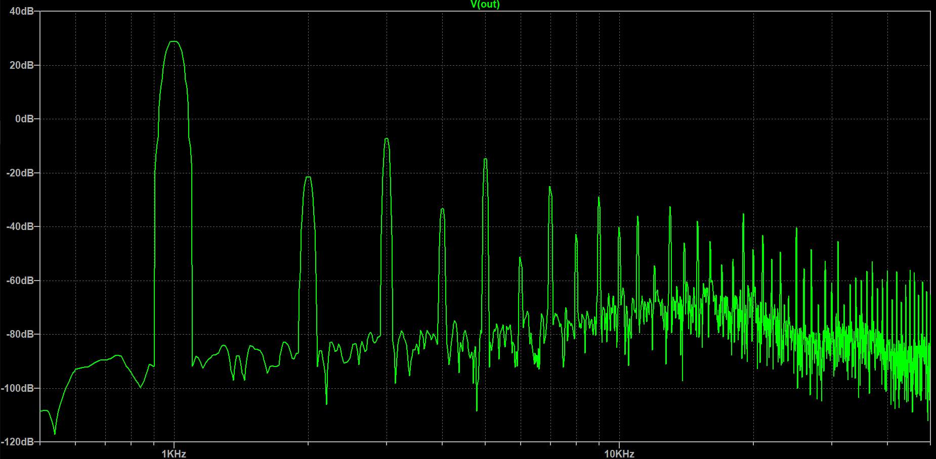

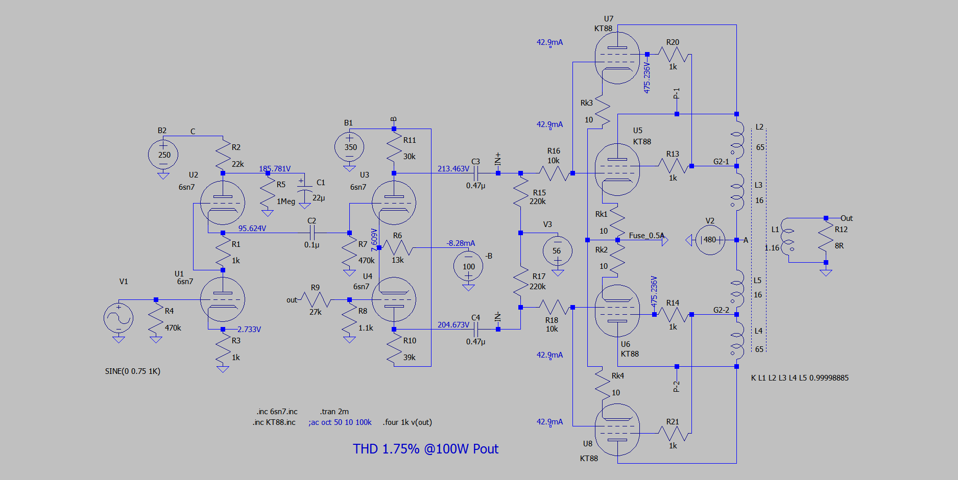

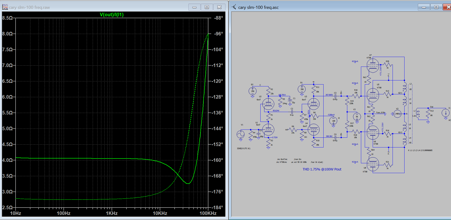

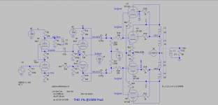

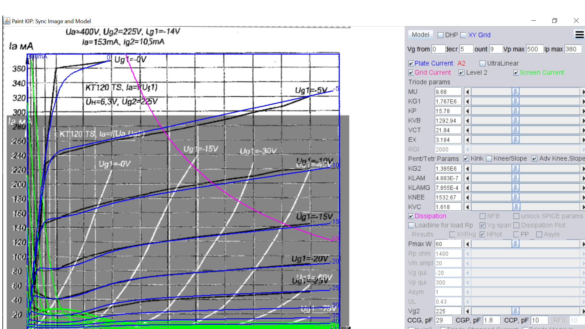

Here is LTSpice simulation for SLM-100 I share with you all. It would be closer if you also measure the actual data for the OT all the inductances and DCR. Here is an inductance/capacitance meter I bought recently, very handy and precise:
https://shopee.com.my/HANHAN-Induct...ectric-ABS-LCR-LC‑200A-i.269998608.7856276359
Also attached is model for KT120. You can download LTSpice here:

No it's not actual slm-100 OT, but it's a 4k Raa, the inductance is that of toroidal output transformer. I believe the actual inductance is lower. For KT88, 6500, EL34 4K OT is for PP and output 75W or so but compared to PPP (100W or more) it's output impedance is almost twice as high (7.8/4.2 Ohms) in same schematic. For KT120 it will need 2K Raa to output more than 100W, but the output Z is also higher if you want more power. The sim result output Z of about 4.2 Ohms is close to 5.5 Ohms of the report, so I believe 4K Raa is about right for KT88, 6550 EL34. You can use the same OT with CF winding to lower again the output Z. Or increase the GNFB. I have built 6p3p PPP only 50W, sound very detail and sharp in pentode mode, although output Z is more 10 Ohms, but if increase NFB, it sounds duller or less detail. I use IT driver so I can not apply too much NFB. Each output tube has separate bias adj and RC coupling.
A few snapshots, hope it'll help you to tailor your amp esp for KT120 and to verify the model accuracy. I can sim KT150 if you want. I use an older KT120 model in the previous post, this one is more accurate (g1, g2 and anode current) and same the .inc I posted earlier.
My power is about 530V... but do not overdrive with high current as 45..50mA
That's only around 26 watts on the KT120 (60 watt max) and hardly overdriving them, the KT120 can driven be closer to 40-50 watts. I have mine running at around 90ma (plates are at 420v). The KT120 tubes sound best to me at the higher currents...
