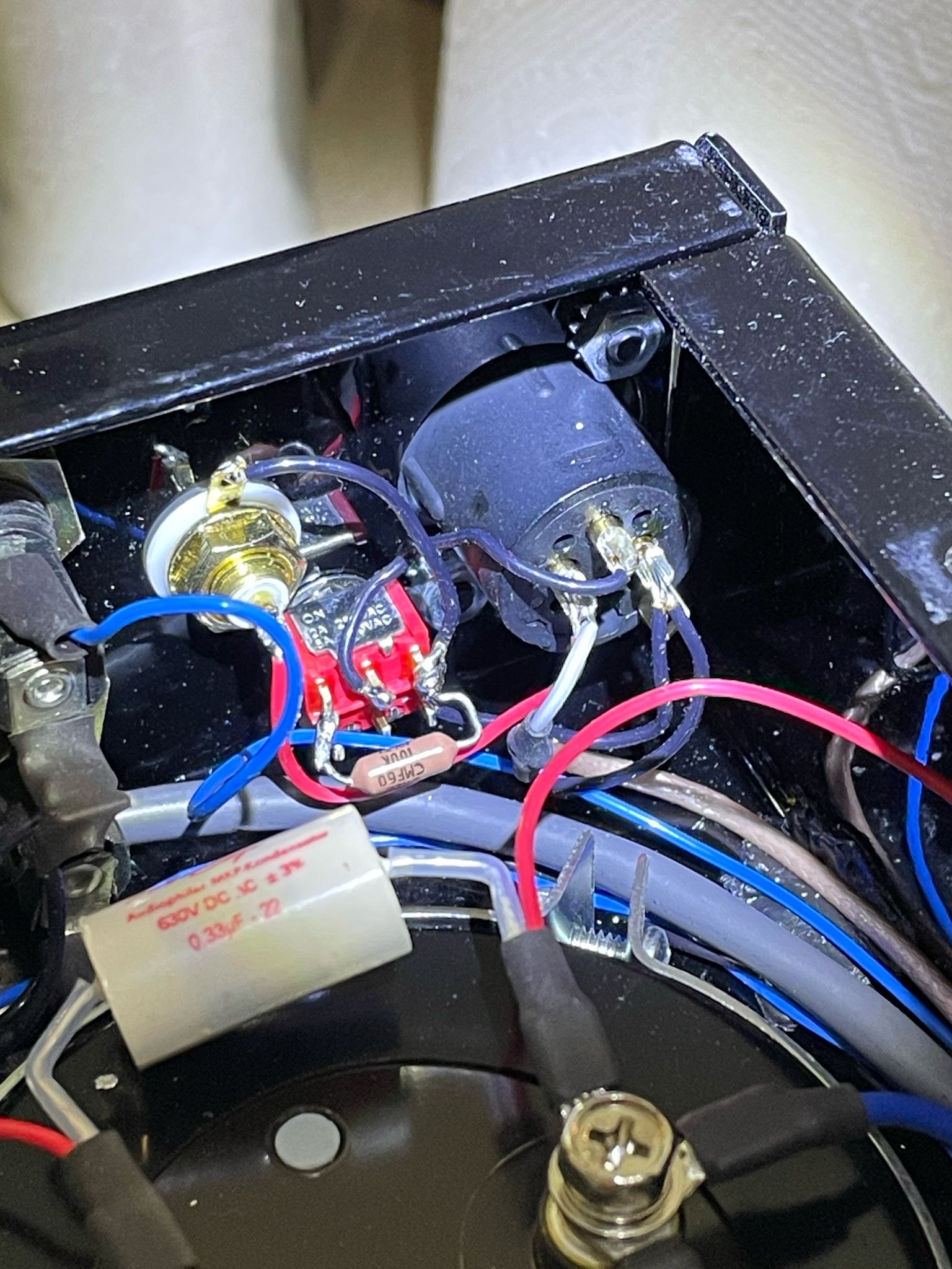

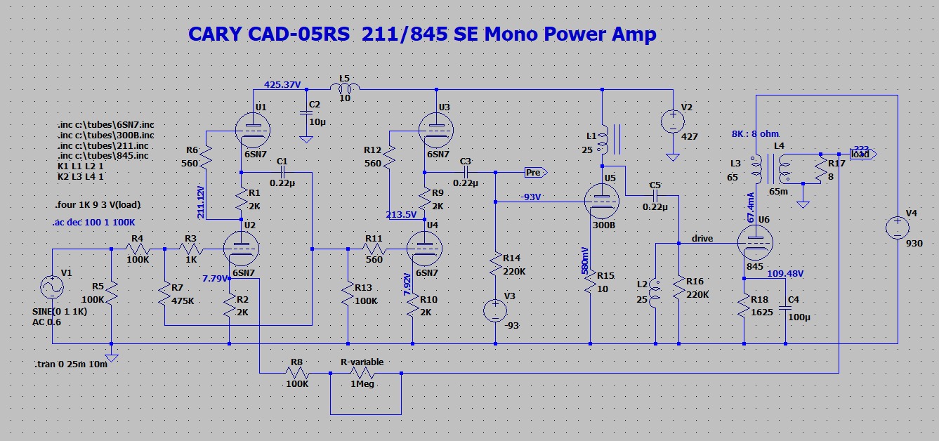

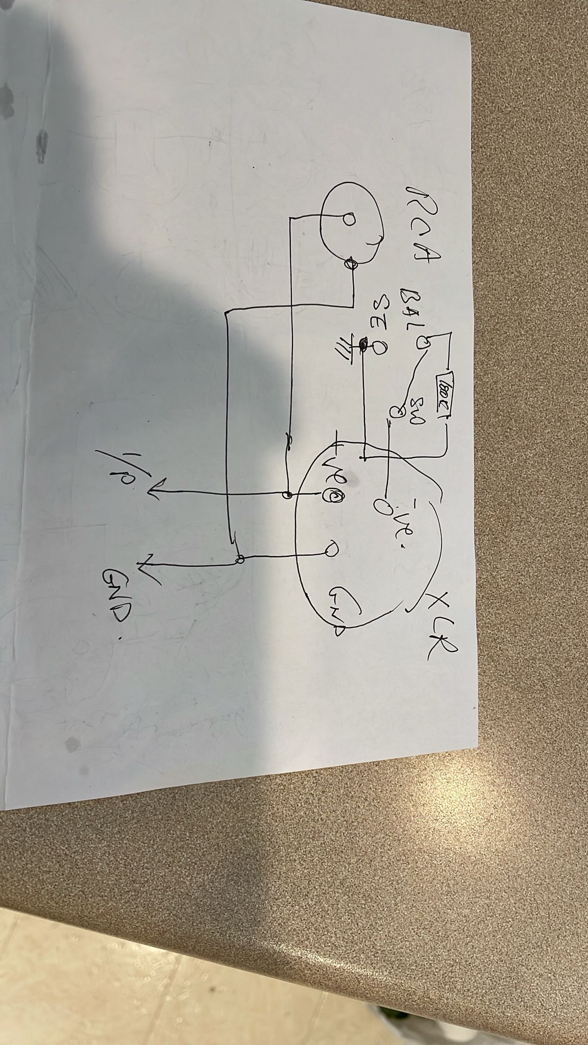

Today, I have the opportunity to inspect inside of this amp. Here's the schematic and picture I took.
