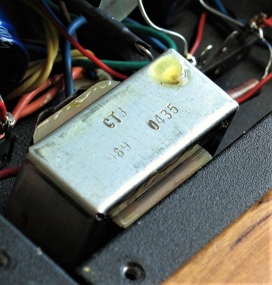

Anyone know what size the power supply choke is on the AE-3?

It can't be that large, because it fits under the chassis, and the chassis is probably only about 1.5 inches high. I bet it's about 1, or maybe 1.5 Henry. I'll pull the bottom off of mine and look this weekend. It may not be marked though.
