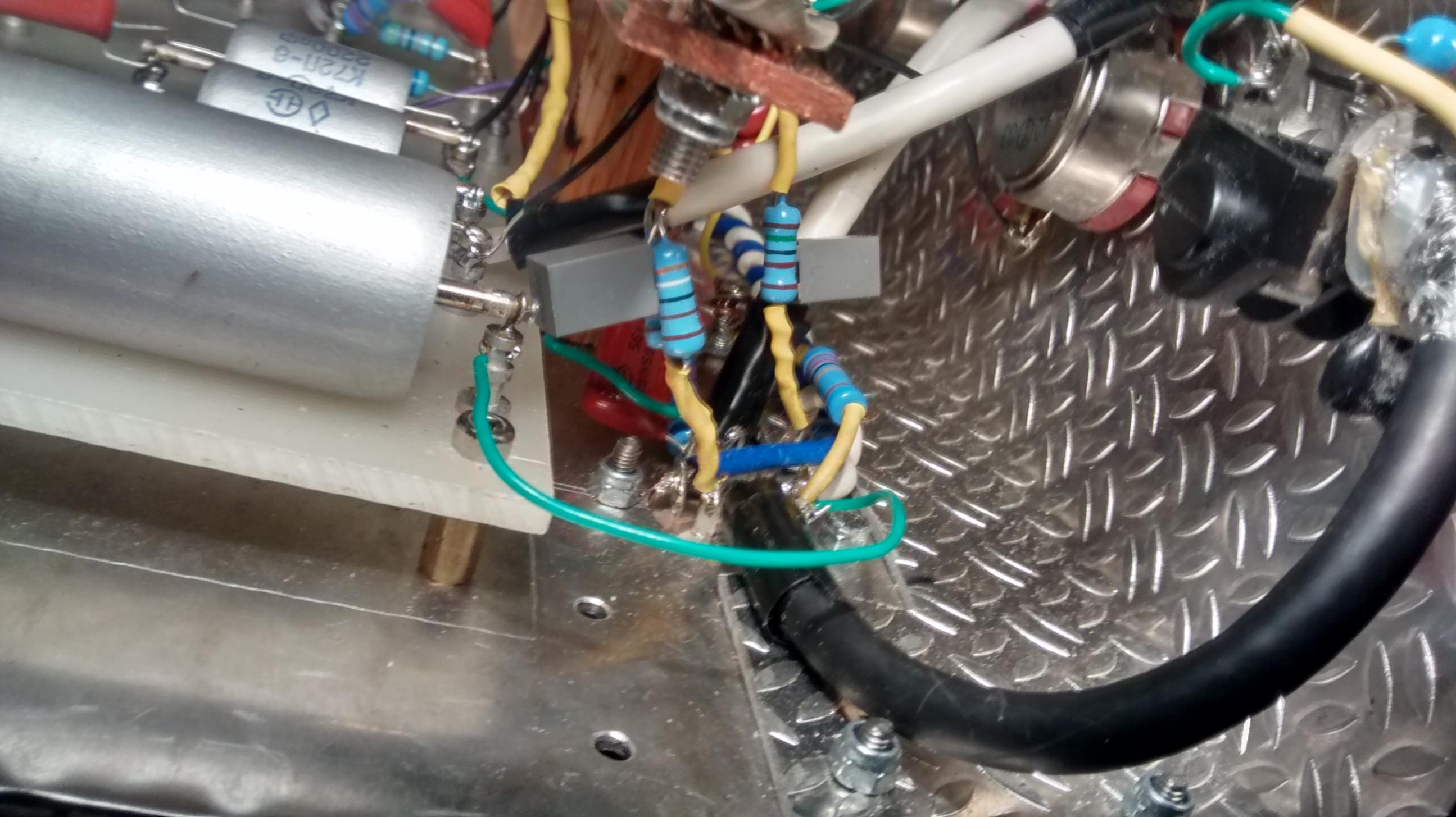

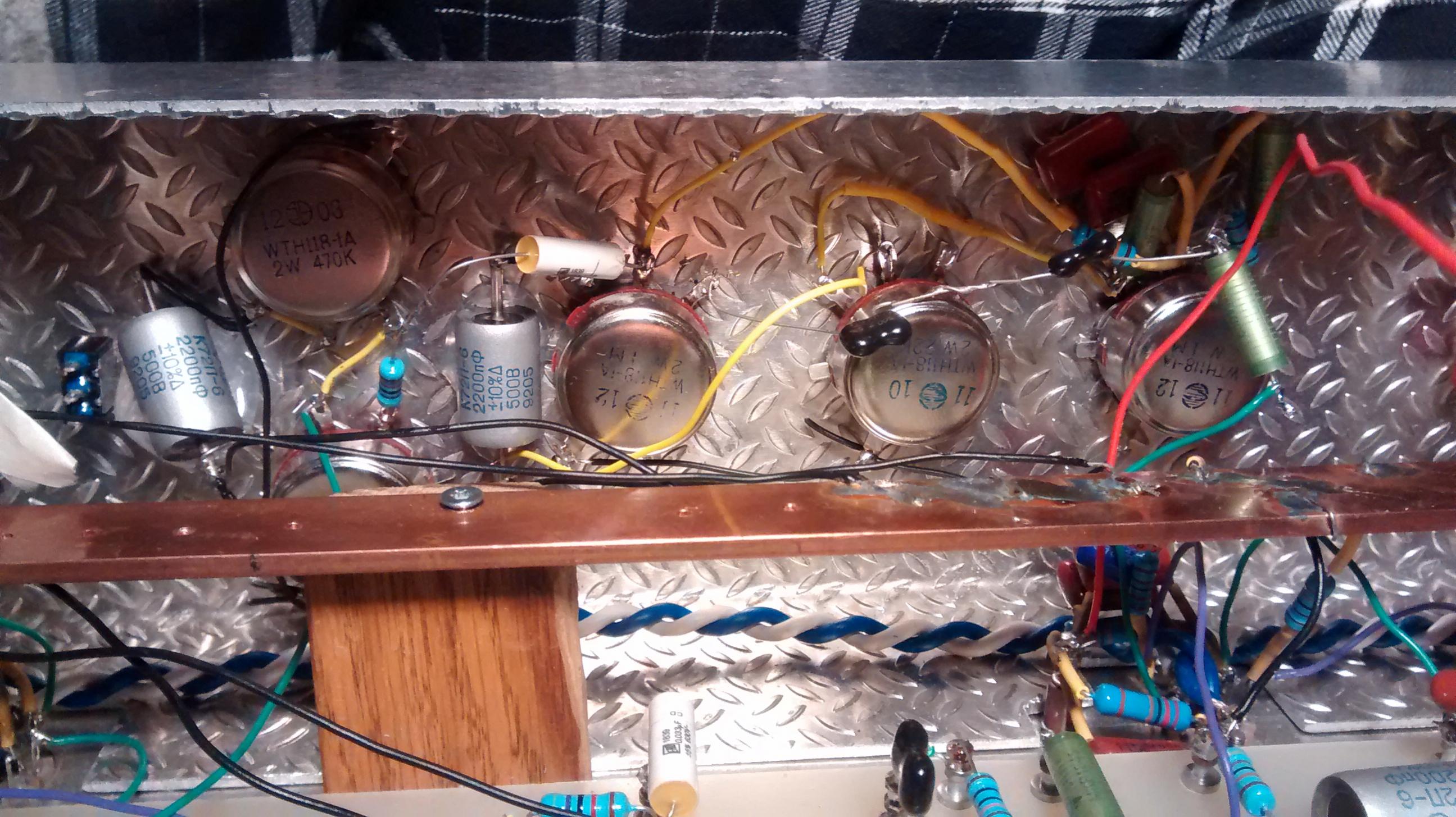

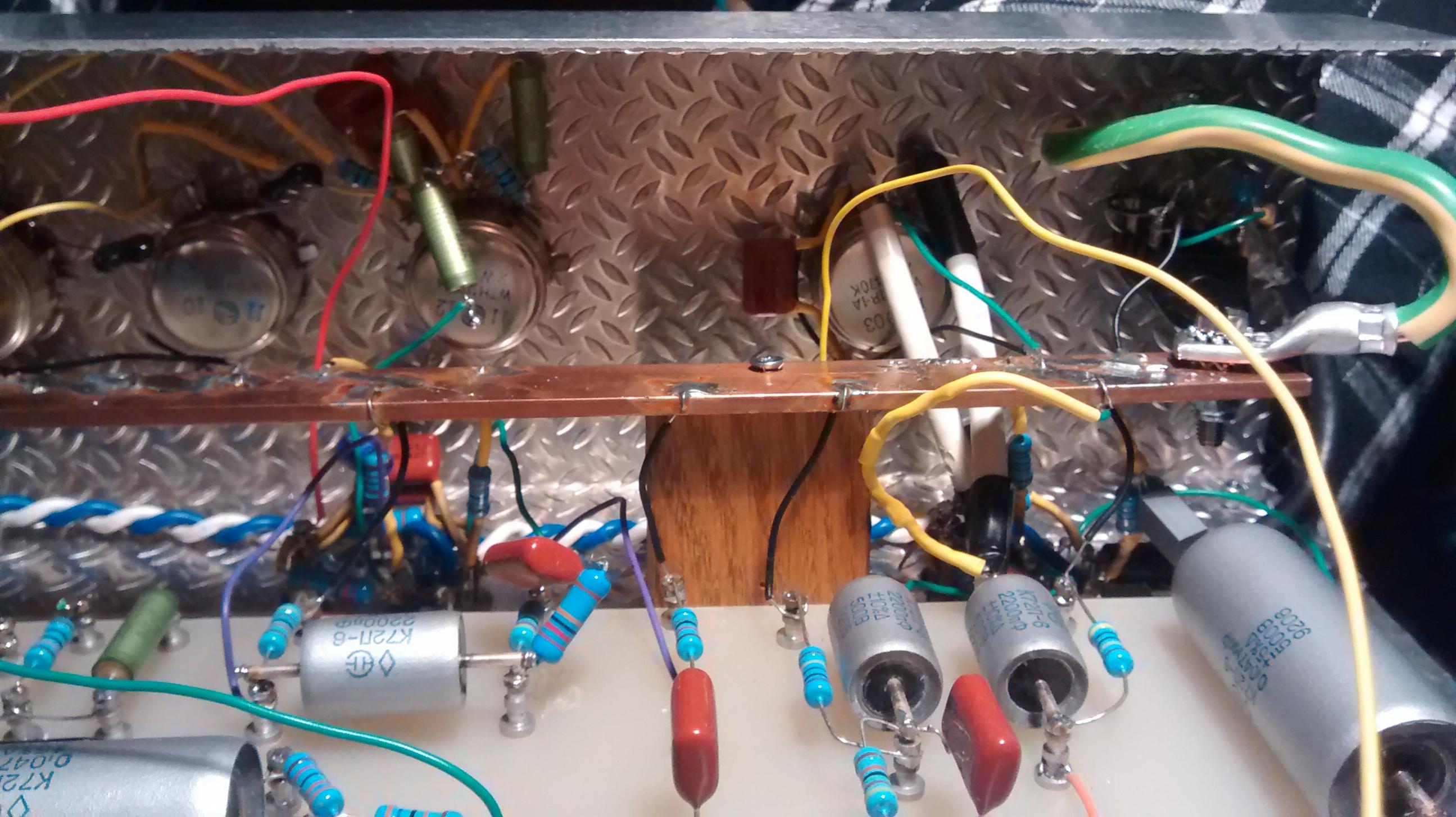

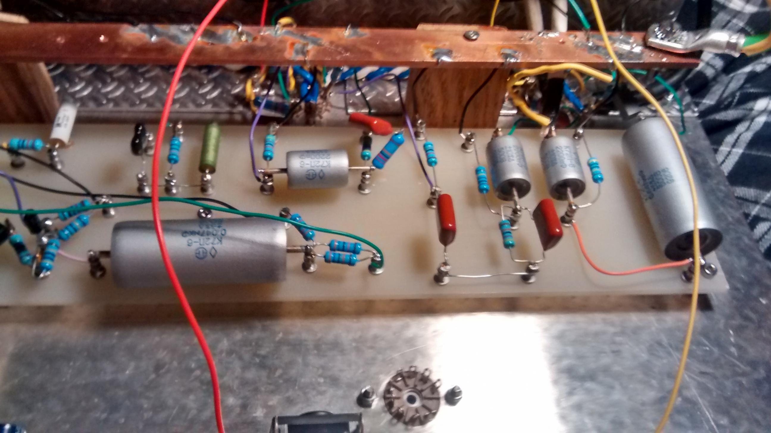

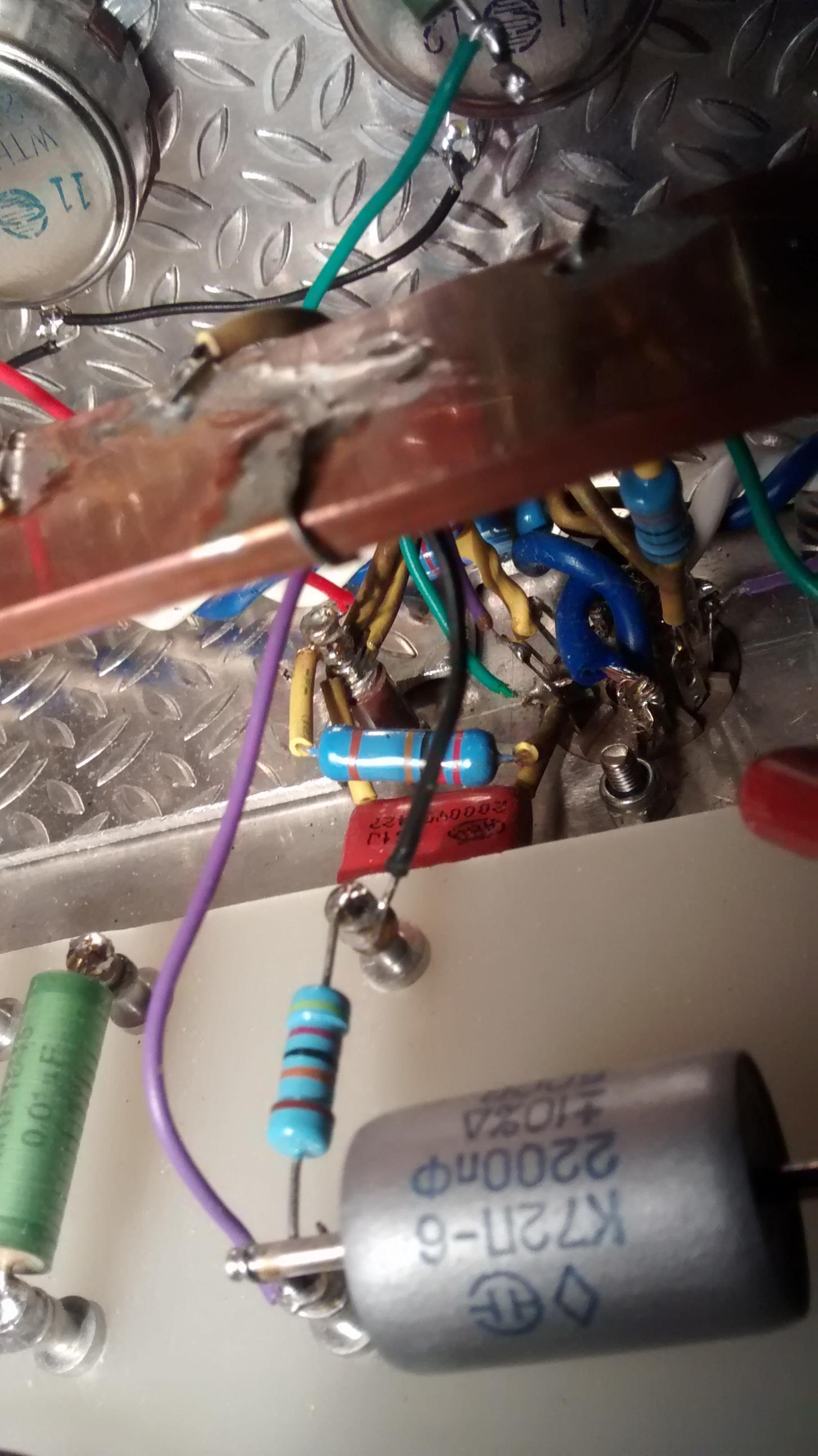

I have a few photos of the preamp board, tube sockets and the tone stack here.
The wiring is less neat than it was before I started my fault finding, and some parts are missing the final insulation as I moved some wires and components and tried shielding some of the wires, so the final wiring should be more neat than it is now.
The plate resistors are wired directly to the tube sockets and to a turret next to the sockets. Cathode resistors and capacitors are also wired to the sockets and go straigh to the buss bar running over them.

Carvin Legacy is high-gain preamp which are not easy to make without oscillation etc. You have got quite a long wires and sorry to say, not good layout!
I would propably start again by putting ALL components to tag board and re-think layout with shortest wires possible. If you need cross wires, cross them at 90 degrees angle.

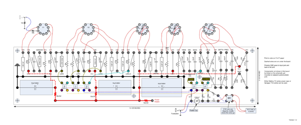

I am attaching you layout of famous very high-gain amplifier. This is how it should be done!
