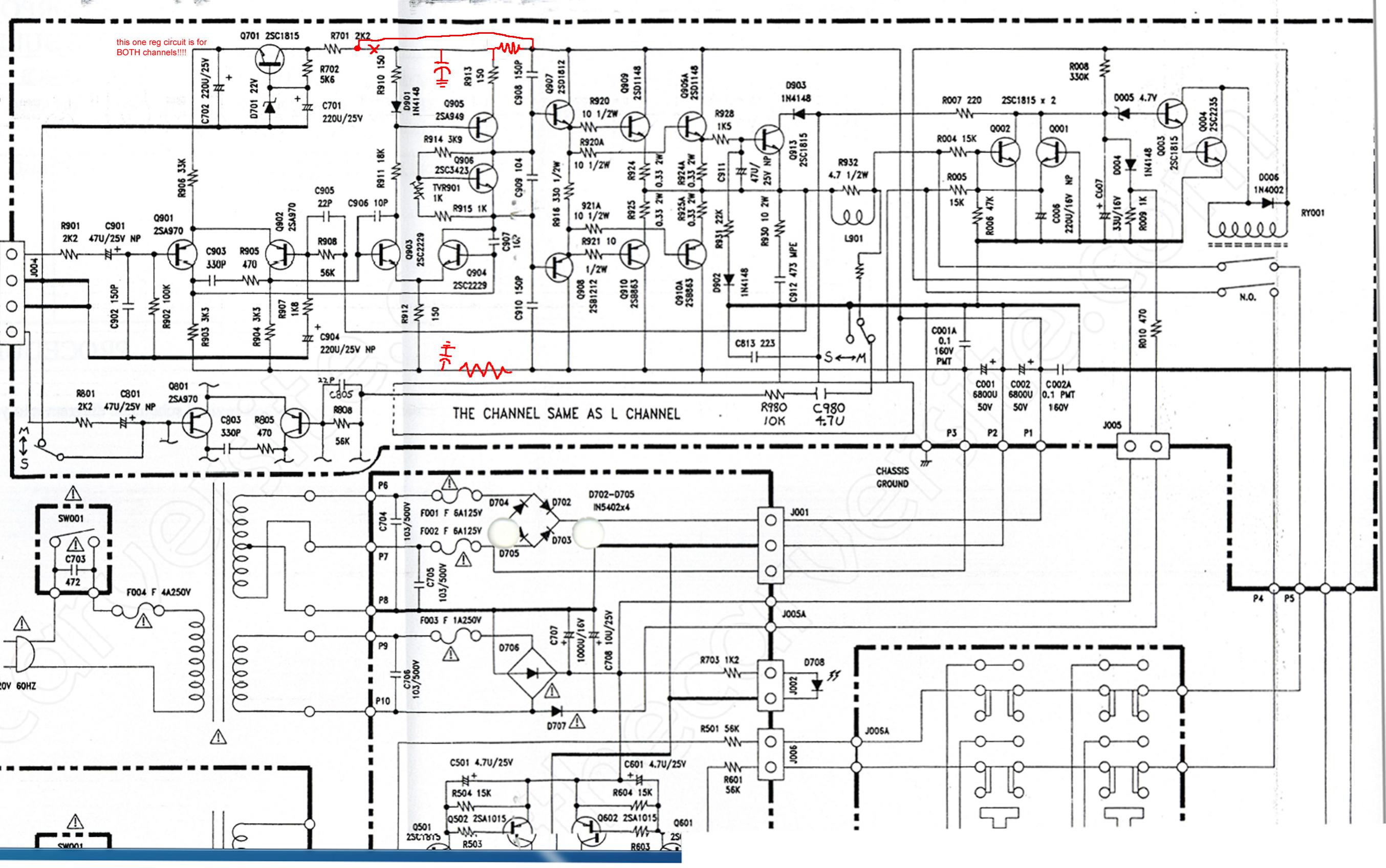

I am working on a Carver TFM-6 amplifier that exhibits DC offset pumping. With every bass note, there is a large DC offset on the output. this causes the woofers of my test speakers to bottom out on every Bump of a bass note. this starts at a low level..maybe 1 watt and gets worse as the volume goes up.
When I got the amp it would not come out of protect as it had a bad capacitor in the Protection circuit. I suspect all the capacitors will need to be replaced. I have ordered a few of the values I don't have on hand but while I wait. I was looking at the schematic...nothing special class AB amp. and thinking that maybe the capacitor in the feedback path that provides the AC coupling to ground is the fault?
The other odd thing I noticed is that the Diff pairs of the L and R channels are both feed off the SAME Current source? which seems odd and bad! is it worth duplicating a 2nd source and tacking it on?

recapping this POS didn't help! But I did some poking around and noticed there is no separation between front end and driver stage... Normally I see a resistor and a couple of caps to stiffen the front end supply at least...So I tried that. Added some 22 ohm resistors in series with some 47uf caps to ground after the resistors. That helped. But didn’t cure the problem. I can turn it up louder now before the swinging DC gets bad.
I recapped the whole amp except main PSU caps. I have to find some that will fit the narrow 1ru chassis height. But ripple is not bad so I don't expect the caps to be that out of shape.
Maybe if I play around with the resistor values for the front end and up the size of the caps it will help a bit more but...what in the world is up with this design?? there has to be a fix for this thing?

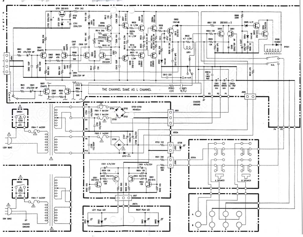

Thanks for the schematic. I wasn't aware that they are the same amp. I'm sure I have a HCA-800II somewhere waiting for my attention.

even the carver PCB has the holes for the different input DC blocking caps as shown on the Parasound layout! I just kept looking at the schematic thinking that I had seen it before. But it was driving me nut's where...then I remembered the Parasound has the same goofy Internal Heatsink layout! and sure enough....same amp!!

Regarding that Current Source, I think it's a voltage regulator. The resistor from the differential to the rails determines the standing current.
