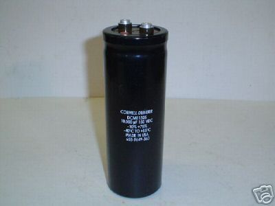

I need 9000 uf 125 v caps, or do I need orginal values very hard to find, any help would be great
That is an odd value, but a pair of 4700uf in parallel might be easier to find. 4700 is a standard value.
