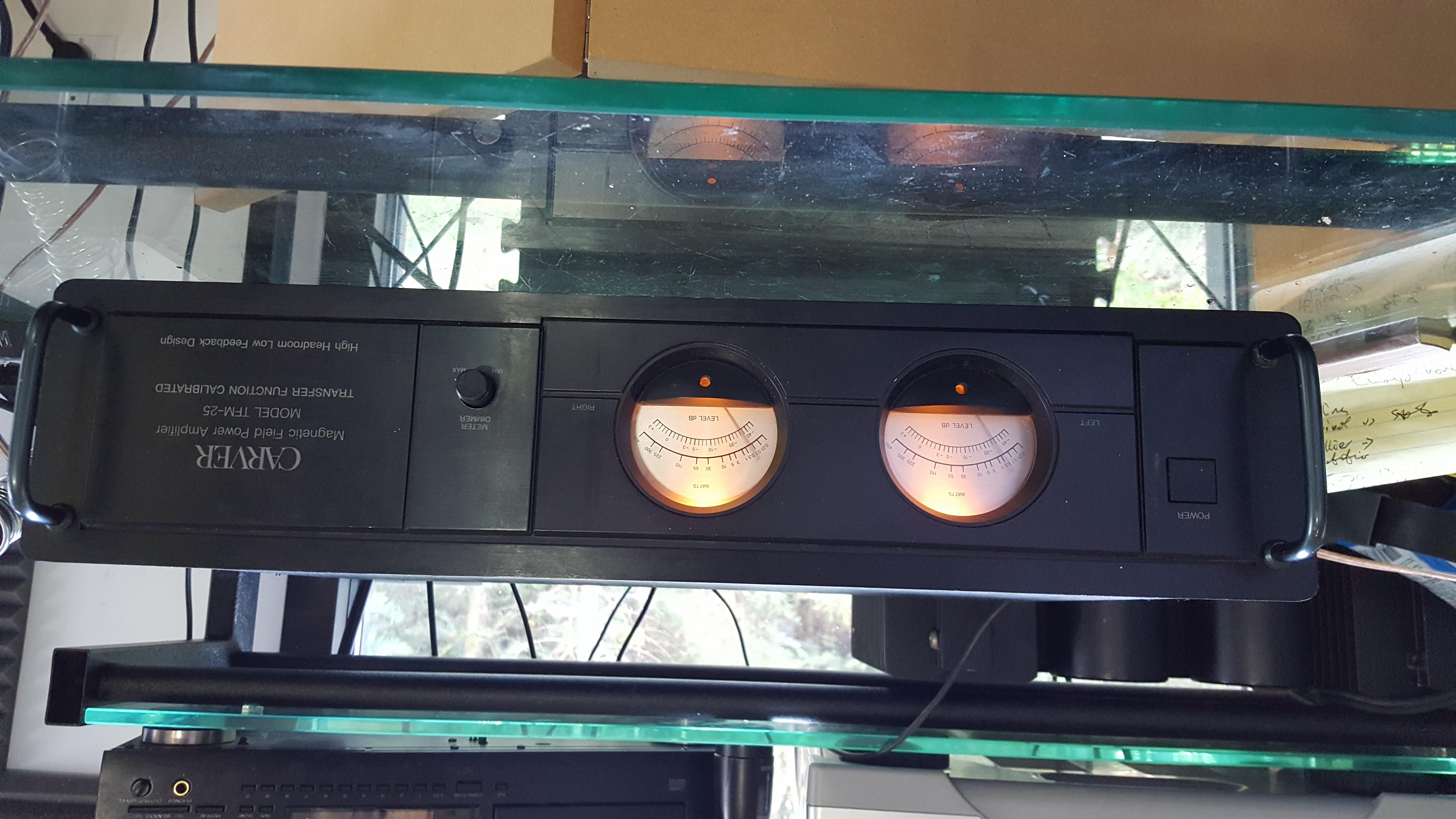

Update from Original post
I wanted to update about this project. I replaced most of the capacitors, a diode and several transistors in the lamp circuit - including new lamps.
Honestly, I cannot remember them all. I was getting odd voltages that did not make sense. I redid my close inspection of the solder joints and found a micro-break in a trace that was only visible under high magnification. I bridged it with a bit of solder and then insulated the bridge with drop of liquid electrical tape.
The amp sprung to life and the result is a great sounding happy amp. I set the bias per factory specs and it works great. I love seeing the meters dance.

P.S. I am not sure why the picture is upside down?

Congratulations. Thanks for reporting your success, lots of times there is no end to these threads. Great diagnosis skill finding a micro-break in a PC board land.
