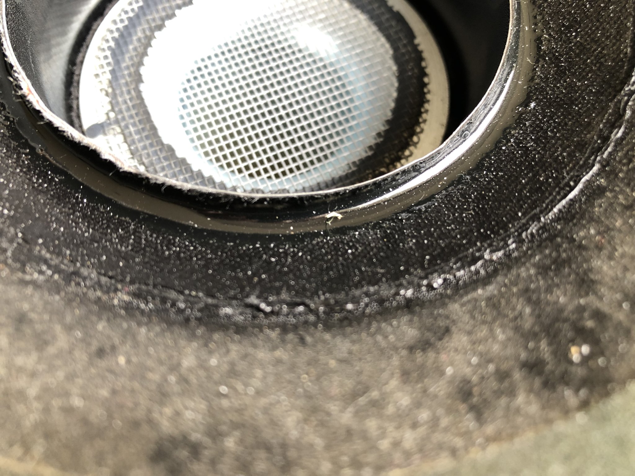

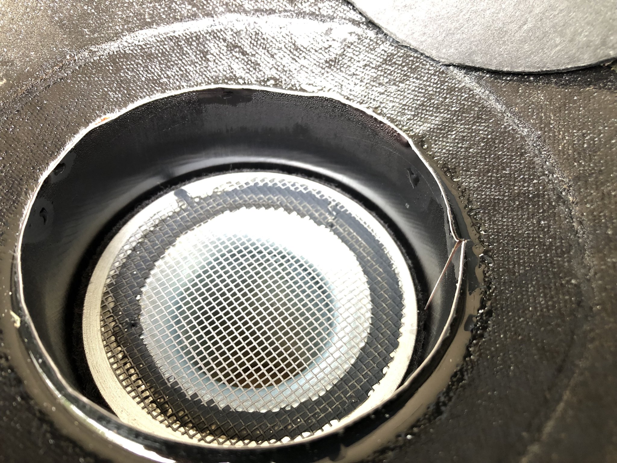

Hey guys, the sub in my Carver Knight Shadow is making a rattling sound on some frequencies at louder volumes. It even rattles when the sub is being played out of the box. I find no breaks in the cone, spider or cap seal, to my eye. When i push down on the sub, the DC resistance goes to 0. Pushing up it gets a variable reading as I would expect. Is this a sign of a defective driver? The rattle sounds like something is being hit against the cone, getting louder as the volume increases. I would like to inspect inside the dust cap but have no idea how to get the cap off. I encourage your thoughts for remedy.

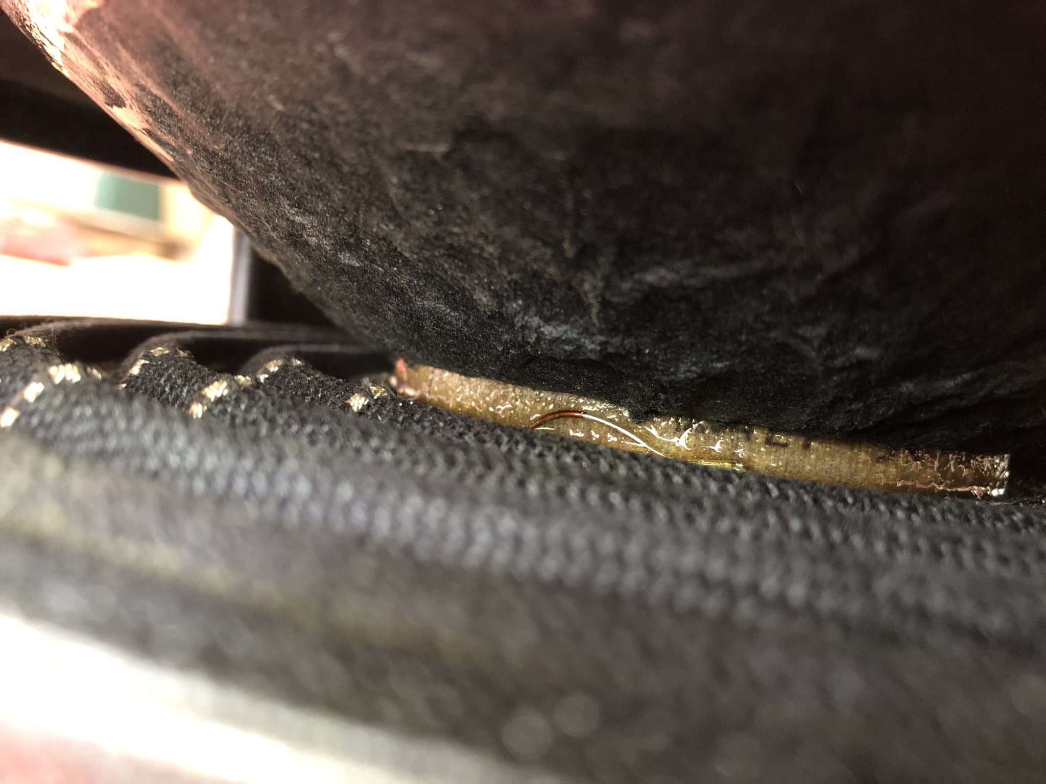

The tinsel leads could also be intermittent at high excursion. You could try wiggling them while reading resistance of the voice coil, though if they're woven into the spider that might not show you everything that's going on.

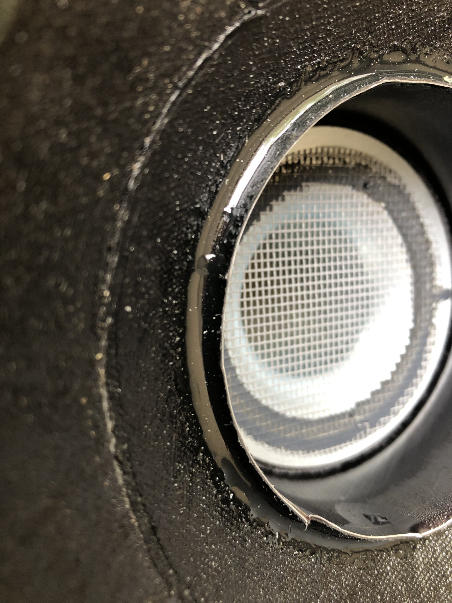

Aside from that dent at the top of the coil in the last pict.
No resistance or friction pushing cone in and out. Other than this rattle it operates fine.

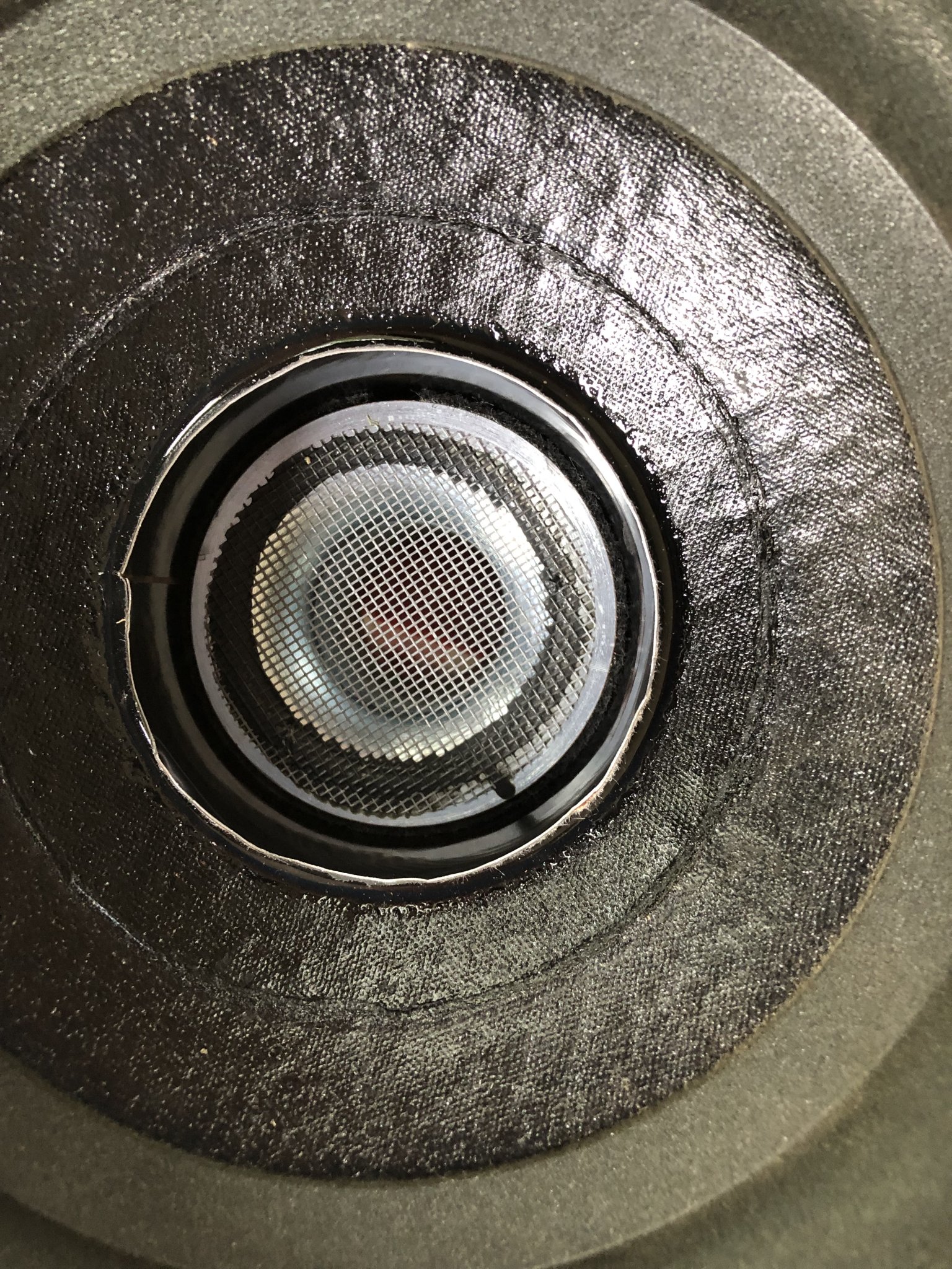

The VC former is heavily damaged (did that happen when you cut off the dust cap?) and it's definitely off-center. The distance of the VC former to the pole core is very close on the 12-2 o'clock range and very far away (last pic), same can be seen in all other pics too. The rattling is likely because the membrane makes a tumbling movement and the VC former hits the pole core or front pole plate. Did you drop the subwoofer? The pole core might have moved or the whole motor moved. Or the basket is bent. That would more likely some kind of a scratching noise unless the VC is hitting something. Does the driver have any vents below the spider? If it does, there's maybe some debris in the air volume in the magnet structure and is moved around with high excursions.
Is the protection screen/grid in the pole core bore loose? Anything in the pole core bore?
Three's no recone-kit for the subwoofer. You could theoretically remove the spider, surround, fix the VC former, replace the foam surround (can't be removed without damaging it, what dissolves the glue also destroys the foam) and re-assemble it again, carefully re-center it. Well, if the magnet hasn't moved or the pole core. Low chance of success though if you haven't done it yet.

That doesnt sound promising. I'm not the guy for that job although a heat gun and removal of cap easy. The very top of the former is bent up, but when i run my finger just below on the inside, its smooth & uniform as can be. The rattle must be coming from behind the spider.

I'm not judging about the driver quality but some construction details just scream 'I'm cheap'. Nonetheless, I try to help but it seems to replace the driver is the only option.
