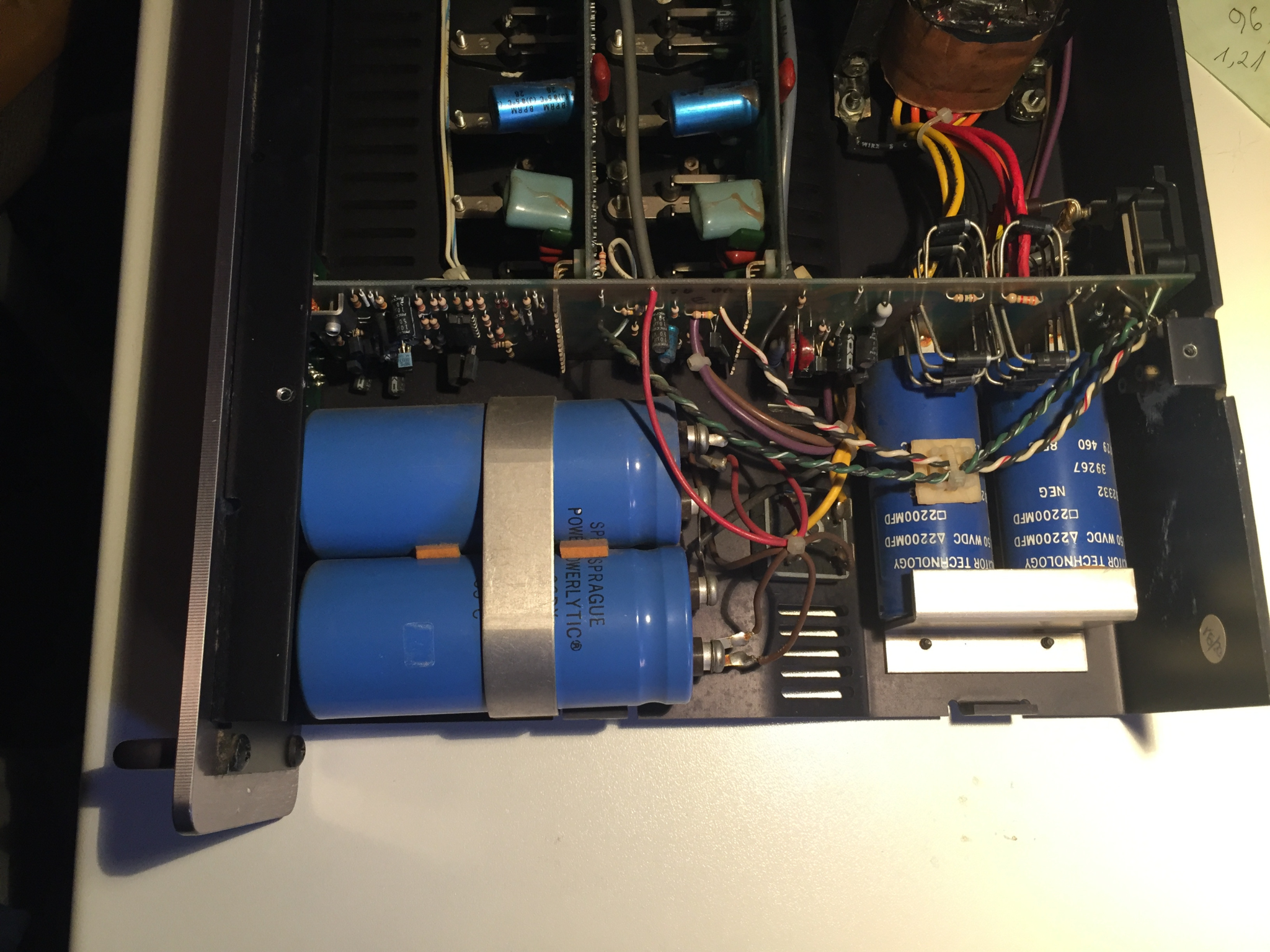

My original Carver, as it arrived from the United States over 30 years ago. the only modification that can be seen is the power cable and the plug, because it was fitted with the American one.

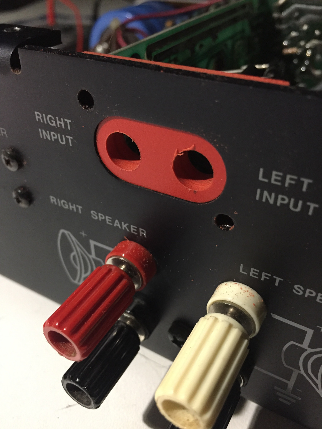

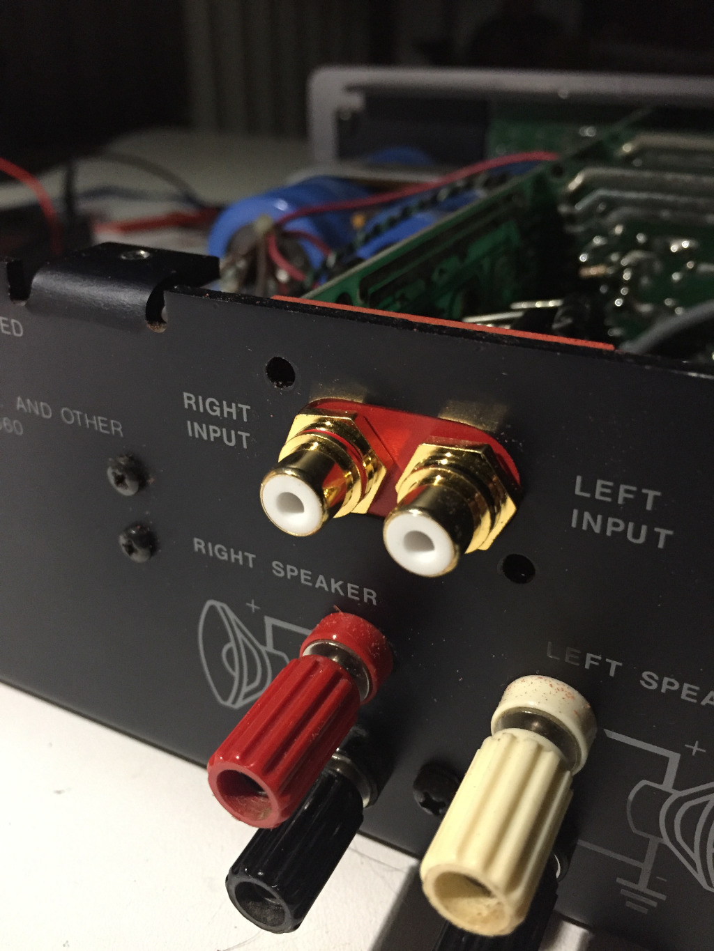

I remove the RCA and put the new ones in the same socket

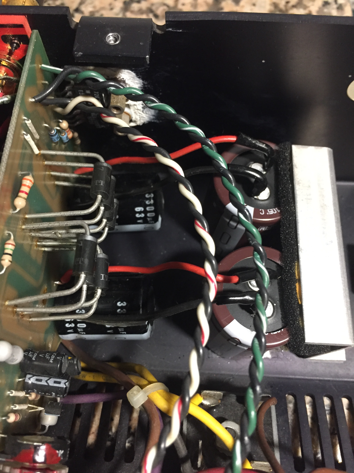

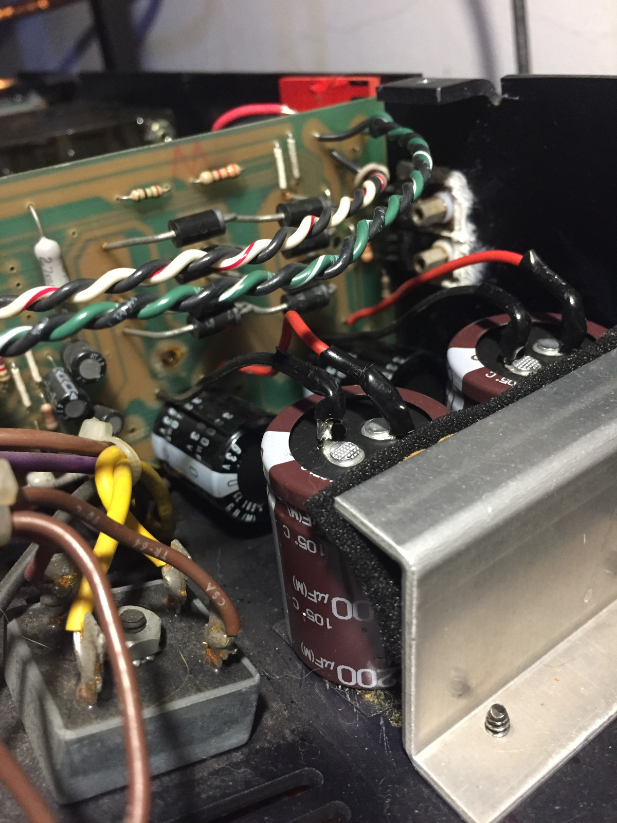

in these, which I just took, you can see the caps I used and positioned. I saved the S-bracket and used it to hold the two larger ones.
If I remember correctly, I did the recap in this period of 2024.
in my Carver there is always a hum coming from the power supply and apparently no one has ever figured out how to remove it.

CAPS,

The dual capacitors should be replaced with something equivalent to the Carver factory replacement PCB. Capacitors on leads simply will not cut it, if that was done, take them out and do it properly. Note that Carver service never supplied the PCBs only, it was a complete assembly and I still have one (which will not be sold). I make exact duplicates for my own service use. The boards need the heavy pins, not skinny leads.
