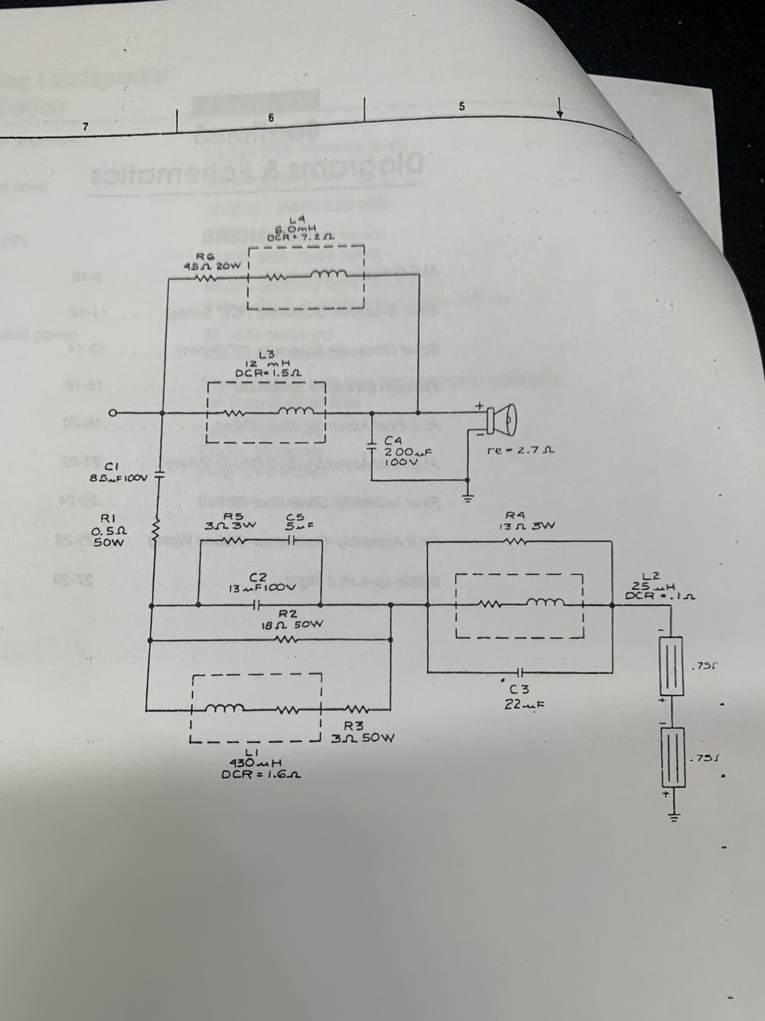

My issue is in the factory service manual the value for L2 in the schematic is 25uH but in the parts list it’s 50uH. The component itself has no markings on it.
Does anyone here have any insight on the correct value?

L2, C3 and R4 form a parallel notch filter with the function of removing a peak in the frequency response of the ribbons.

It's possible that the difference in uH values may not be hugely significant in terms of the notch filter action.
It's common to tweak component values in order to adjust notch filter action, so you may be worrying unduly.

The resonance frequency is easily calculated. https://en.wikipedia.org/wiki/RLC_circuit
By my quick calculation, 39uH would put the second notch filter's resonance at the third harmonic of the first.

We could work out the respective frequencies and bandwidths of the two possible filter configurations, but we still wouldn't know which one is applicable to the frequency response characteristic of the ribbon tweeter as it is unknown to us.
That makes sense. On a Carver forum most agree that the schematic is probably correct so Im going to go with that and see what happens. Now to try to find a 25uH inductor that will take some power. The biggest one I have found is only 18 gauge or about 300watts🤔We could work out the respective frequencies and bandwidths of the two possible filter configurations, but we still wouldn't know which one is applicable to the frequency response characteristic of the ribbon tweeter as it is unknown to us.

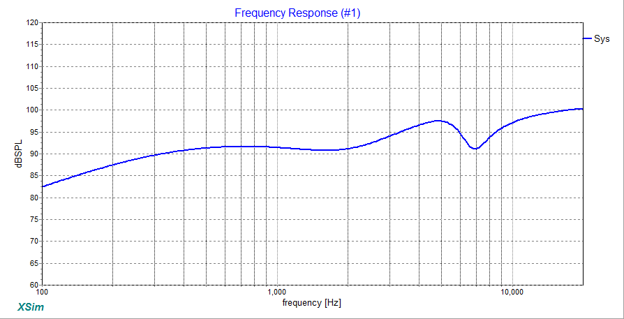

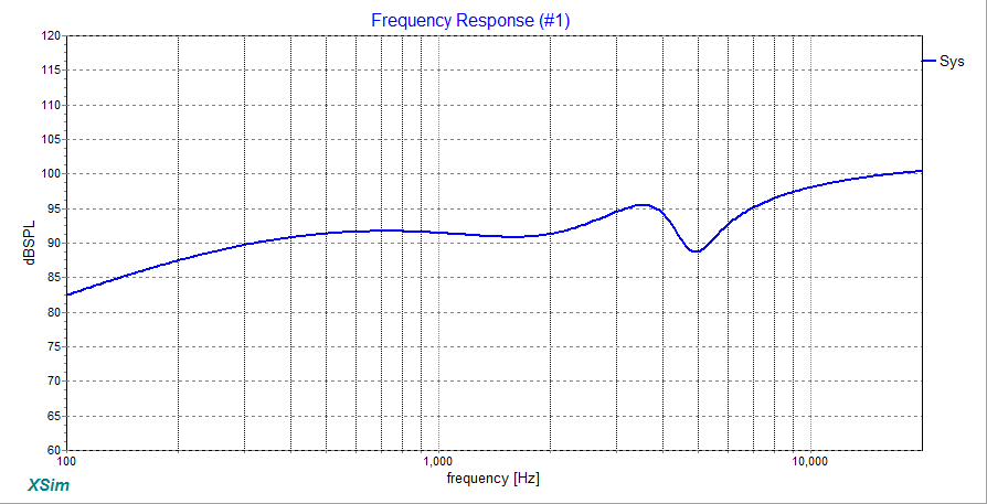

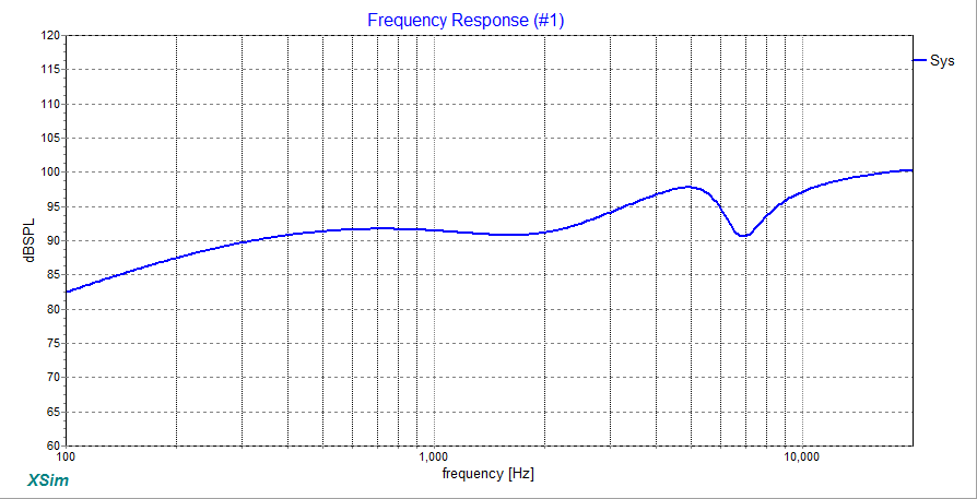

I'm no expert on them, but was involved with a discussion about them previously. I honestly forgot I had modeled the ribbon section. Sorry for the delay.
https://www.diyaudio.com/community/threads/carver-amazing-bi-amping-question.390162/
Filter response with L2 at 25 µH, 0.1 ohm
L2 at 25 µH, 0.07 ohm
L2 at 50 µH

I did read that post but there didn’t seem to be an answer to the correct value of L2. At least the difference between .1 and .07 ohms look very minimal so I think I’m going to go with the .25uL .07 ohm and see what happens. Thank you for the graphs BTW.I'm no expert on them, but was involved with a discussion about them previously. I honestly forgot I had modeled the ribbon section. Sorry for the delay.
