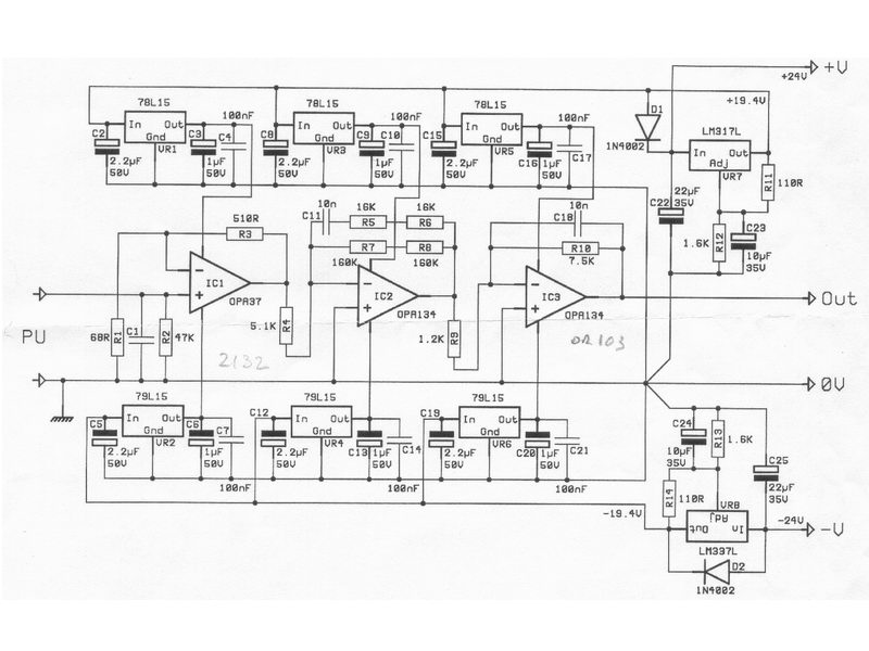

Im having a right nightmate at the moment trying to locate a fault. Iv'e built a op-amp phono stage, well a kit anyway thats worked fine for a couple of year's or so i thought!
On a couple of occasions iv'e had one channel of the cartridge go down..ie no sound at all..when iv'e switched on..and Len gregory's MM mkii are expensive to say the least.

My pre amp is passive diy home brew, which has a selector switch made up of three wafer's. One for channel and the other operates a row of blue led's, just so i know what's in use ie cd,tuner, phono..etc...
Could it be that DC from the led wafer nearest to the phono input is some how tracking across, and feeding back through the phono stage into the cartridge, bearing in mind that only one channel blows.

Your nightmare could be a DC problem. Only accurate measuring can tell. Do you have DC blocking caps at the input?

Blocking caps on the input to the pre or phono stage ??? Niether would be the answer to that.

Hmm.... failure of either 15 volt regulator that supplies the OPA137 could cause a DC presence on the input connector.
Much more likely IMO is some intermittent short circuit.
Another thought is intermittent SCR latchup occuring on the OPA137 during power-up. C23 and C24 (10uF) are for ripple rejection, but also cause slow power-up. If they are not the same value, ie one has dried up, it could cause a problem. Also, check to see that the power wiring is identical between channels.

SCR= Silicon Controlled Rectifier.
It's a 4 layer device that, once switched on, cannot switch off until the power is removed.
The elements of some integrated circuits can behave in this fashion when reverse biased. this can happen when a supply rail goes missing, or is slow to appear.
Actually, there are parasitic SCR's (or thyristors, as we call them here) all over the place in any integrated circuit with a semiconductive substrate, and almost all IC's have a semiconductive substrate. Some IC's have more sensitive SCR's than others, though. Some of the SCR's are connected straight between the positive and negative supply lines and can cause the IC's to self-destruct in seconds when the power supply is powerful enough.

I did some testing on this unit ages ago with a mate of mine using a pc based scope..and we didn't find much wrong on power up /down.
This is what puzzles me... could it be the pre causing the problem.😕
