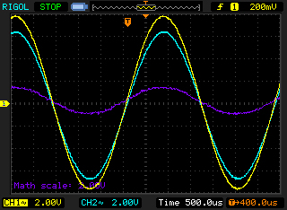

First of all, since the cartridge signal is probably too low (especially on MC ones) I m measuring the signal on the phono output (which also gives us RIAAed signal).
We really need a record that includes frequency tracks on both stereo channels (together and independently) (need your proposal here... already have the HiFi news one but it only has separate noise tracks)
It s also nice to have a 2 channel oscilloscope so that we can see both signals at once and use the math/fft functions of the scope.
On the first screenshot, I have the two signals on top of each other. The difference is almost 1v, which is rather substantial. Probably due to bad azimouth (unfortunately the SL1200 MK2 shell does not offer azimouth adjustment... I should get a Jelco or something)
The purple line show the difference between the two channels (math A-B)

Unfortunately the HiFi news record does not have separate channel tracks with frequencies. Only noise which makes it difficult to get a measure of the crosstalk (or am I missing something?).

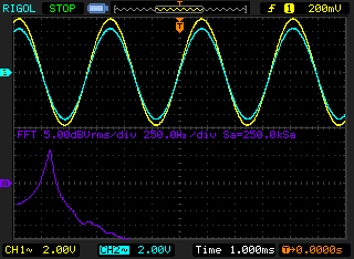

The second screenshot shows FFT of the left channel. We see some small spikes on the right of the 300Hz signal, probably showing some distortion? I need your help here on how to better understand what we can see in an FFT graph.

Measuring the frequency is very easy using the relevant measure options of the scope. For me both channels had a small deviation from the 300Hz of the disk (around 320Hz on both channels) which points rather to a deviation on how the disk was cut, or a deviation in the phono RIAA.
The phono RIAA filter does not change the frequency of the signal. It only changes the level of the signal.
Your observed difference is either the result of of the disk being cut at that frequency and/or your turntable running fast. I assume that it's both of those: the frequency on the record could easily be 315Hz and the remaining difference could be the contribution of your turntable.

could the 1v come from anti skate?
i guess I'm asking if the A.S. was off would it show up like that.....or how would it look?
also what if the R&L side of your phono pre isn't matched? like right side 20db of gain and left is 21, or whatever.
should you adjust for that at the cart? will that mess up lps?

Azimuth and anti-skating do NOT significantly affect channel balance, so if you see an imbalance its cause has to be found elsewhere. More often than not it is shoddy cartridge build.
Azimuth DOES affect channel separation, and one of the easiest ways for quantifying this is with the HFN test disc noise tracks, which you record, import into a computer, and subject to spectral analysis averaged over some 10 seconds.
