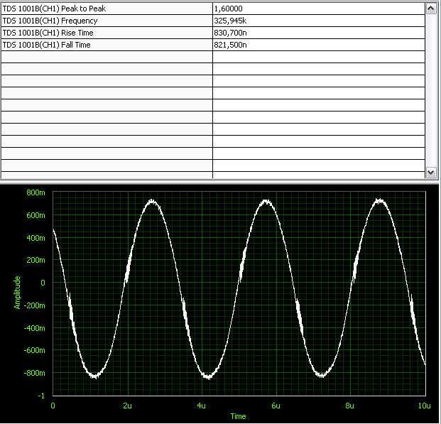

Hi !
I built a D amp, it sounds very nice, much better than I was expecting.

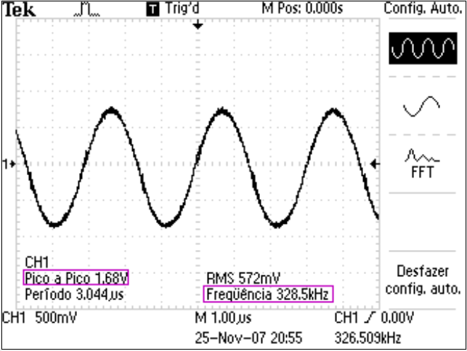

Well, althought it works fine, I can measure 1,7V peak to peak of switching waveform on the speaker output. The frequency is 325Khz.
Inductor is 22uH and capacitor is 680nF.
I don't know if it's related, but it heats considerably when IDLE, and just a little bit more when playing at full power. I was expecting it to be cold during idle period and slightly warm when playing.
Is it fine, or is my output filter faultly ?
Thank you very much !
Best Regards

You cannot eliminate carrier waveform completely, only thing you can do is attenuate it using filter.......so the 1.7pk residual is just fine.....nothing to worry.....
regarding heating at idle i think its a more shoot through or low deadtime problem......post some waveforms.....of output
If you make selfoscilating UCD style, this residual is needed to keep the amp working. If you eliminate this, the amp won't work at all. But if you make classD with feedback before LC, its a different story.
I've tried to eliminate this residual by using another LC (after feedback point, that makes it 2 sets of LC), the residual is almost 0.
The amp is a TDA8920BJ. 😉

This is a little off topic, but there is a way to all but eliminate the residual without filtering. Instead of connecting the speaker to ground you can connect it to the output of a noninverting amplifier/buffer whose input signal is the residual. Since the residual voltage is relatively low a class ab amp with low rail voltages can be used so there is minimal power dissipation from this extra output stage. I believe I saw this method shown in a patent that was linked to or described somewhere in this forum. It was a while ago but it is an interesting way to solve the problem (even though it really isn't a problem).
The residual is not a problem at all for speakers. Furthermore, residual cancellation methods (also class BD modulation) actually change the differential-mode residual into a more harmful common-mode thus resulting higher EMI.
In my opinion, the ideal approach would produce equal residuals in both output speaker wires, but with inverse polarity (for zero common mode component). A straight full bridge (no BD modulation) achieves this.
BTW: Nando, I think that your waveforms actually contain substantial RF ringing after each switching transient that is almost hidden because it seems to be outside the frequency response of your oscilloscope or measurement. Note how the carrier residual becomes noisy for a long time after each zero crossing (when switching takes place). If this RF is actually there, you will have still a lot of work to do to get a good amplifier...
Hi Eva !
This is a very experimental through hole approach, the layout isn't that good and... Maybe is this RF is making my amp oscillate and get warmer than it should ?
There's absolutelly nothing special with the power supply, probably the noise is coming from there... :dodgy:
All the 100nF bypass caps are placed as close as possible of the pins, and connected directly to the massive ground. Actually its out of the layout and it is placed manually bellow the chipamp. They are polyester types, 63v epcos (the blue package). Would ceramic caps be better?

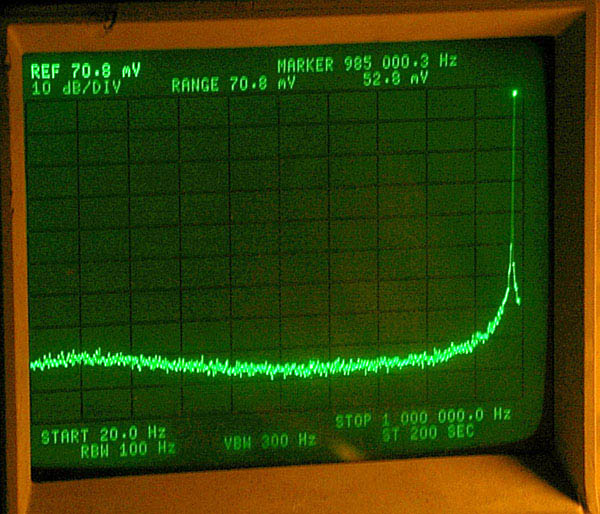

raise the pwm freq
u can get lower noise output
mcd-255, 250w version 50mV. frequenc res 0~150k -3db
or u can use 2xLC filter to make it lower, but phase shift will be large, and the freq-res will be worst.
