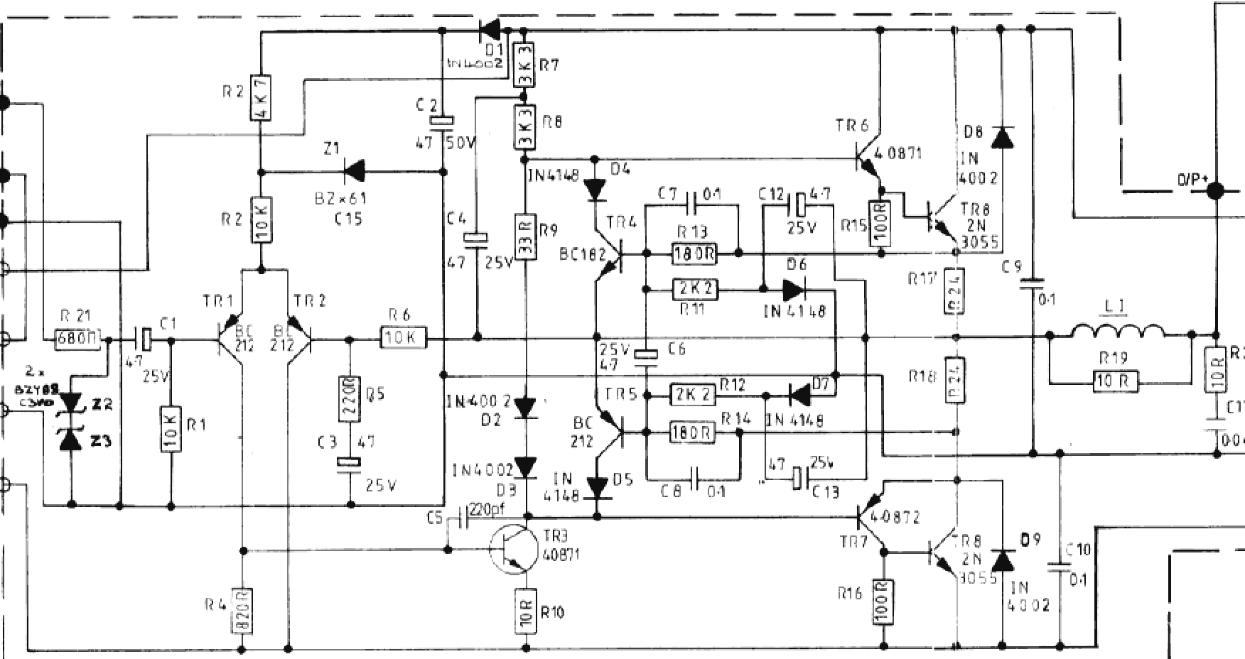

Most of this vintage used a common amplifier, similar to the H&H range but without the 741 op amp.

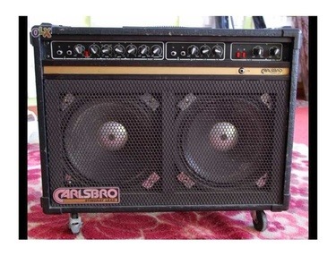

Hi all,newbie here.
Ive just bought a 1978 Carlsbro Stingray combo similiar to the one detailed in this thread and have deduced the heat sink may have been removed.The back panel looks identical to the last pic in Page 1 of this thread...multiple holes on the backboard where,I assume,the original would have been.
My queston is this: is it safe for me to use this amp at low volume e.g. not above 9 o’clock on the Master Volume or should i get a heat sink added? If so do I just mount a new heat sink onto the back panel using TO3’s and a fin shaped heat sink or is it more complicated than that? I have no experience in this area so apologies if my questions are amateur.
