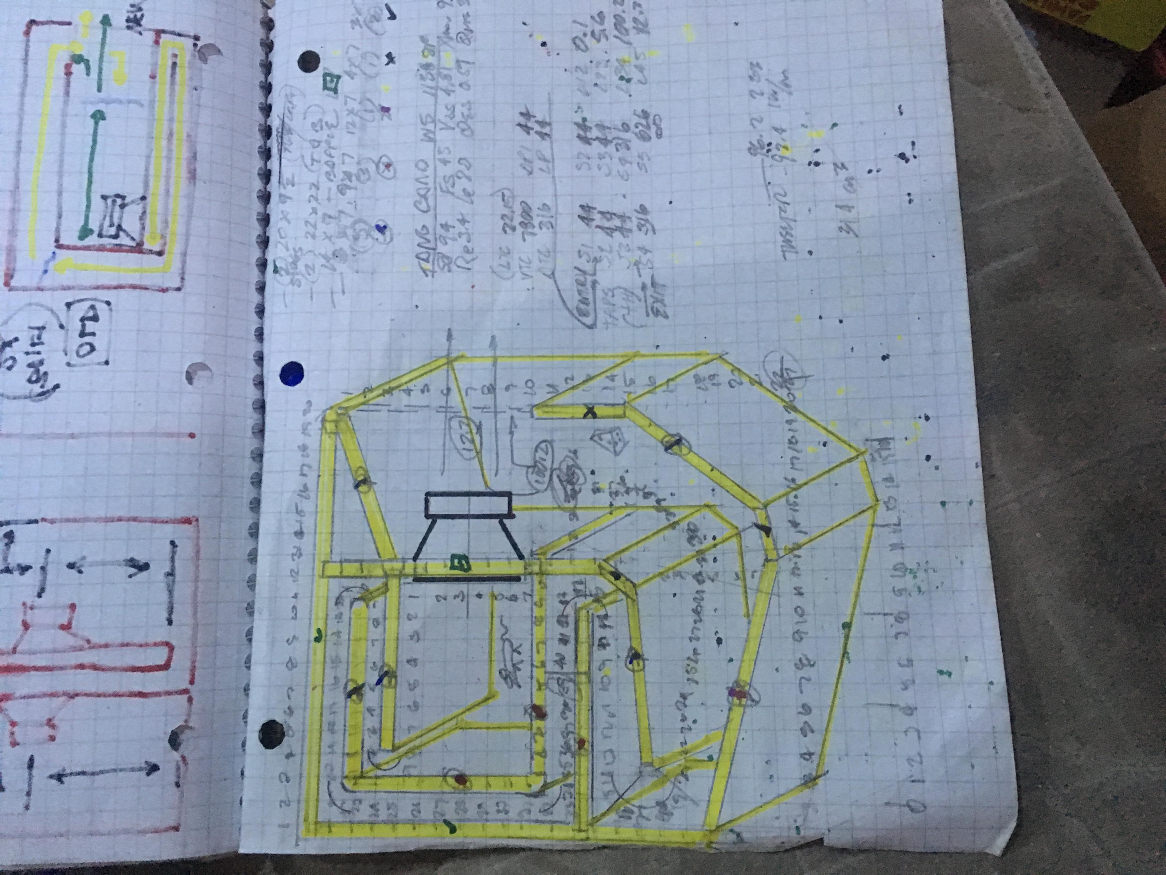

I plan to build 2 subwoofers for my office / desk setup. I was thinking of maybe starting with 1 and seeing how it goes, but figured it would be more economical to go for 2 in one shot and why not have 2 anyway! 🙂
This system is strictly for music. My mains are Micca RB42s which I'm quite impressed with and will probably keep for a while. That said I have an aging Energy ES-8 subwoofer (20+ yrs) and the amp is on its way out.
I found Paul Carmody's fantastic Voxel design and wanted to integrate the amp into the cabinet and try to get down to 30-32 Hz f3. My width and depth limit are 11" or so, and height up to 20". I decided to go with the Dayton SA70 plate amp.
I went with a slot port to help with chuffing as even a 2" port was peaking close to 23 m/s at 35W power. With a 3/4" x 8.5" (full width) slot at almost 30" long, this goes down to below 11.3 m/s. At the full 70W it is under 16 m/s. Much better.
That said, 35W is the highest I can go in WinISD with this design while obeying x-max, after adding in the 18 Hz highpass filter that is apparently built into the SA70 (according to a Q/A on the product page). I figure (hope) I won't pump more than that as I already have my current setup turned quite low. I like bass extension to fill in the lows but not high volume or "obvious" bass. That said even Paul's original design seems to exceed x-max at one point, so hopefully this will be a non-issue in the real world.
Here are some SketchUp drawings:
And some WinISD screenshots:
Full pack of pics:
hv6478's take on the Voxel - Album on Imgur
The 3 "slats" at the bottom to form the port are from 1/2" material rather than 3/4" like the rest. This helped me stay more comfortably under my 20" height limit, but if I end up "having" to use 3/4" material, I'd end up at 19 3/4" (to keep the interior volume the same, that is).
I'd really like to know if this generally looks like a good approach. I know it's conceptual in this form and I look forward to building these, but I'd like to be as best prepared as possible beforehand. Any critique, suggestions, big red flags or alike would be greatly appreciated.
I'll be building with a very experienced friend, and I'm not too bad around a shop though I consider my woodworking skills quite basic, hence my friend's help.
The plan is to cut a 45" angle around all the edges of each face as you'll see in the sketch. I feel like this would provide a cool look, and it will "hide" the butt seams too. I'll be using 3/4" void-free Baltic Birch (the proper stuff, 5' x 5' panels) from a local lumber yard. I plan to stain them a dark chocolate brown.

Greets!
The vent's aspect ratio is > 9:1 and combined with all those 90 deg bends it will be somewhat aperiodic, so expect a more rolled off response than predicted.

Thanks very much for the greetings and reply!
I imagine you mean a steeper roll off on the low end?
I was worried about that. Was considering going narrower and taller.
Would something more like 1x4 combat those bends enough?
I thought that the much higher velocity of a 2" round port would leave me worse off. I do have some plans for that as well (ends up being 2" shorter as well).
Otherwise I suppose the built-in amp is making it a bit harder to make a simpler and more effective slot port. Perhaps a modest outboard power amp would work if I could figure out a good way to hide it in the setup.

I suppose my concern is the overall approach, layout and whether my bracing is adequate. I can switch to a 1x4 port and have it just under 20", which saves at least one pair of 90-degree bends.
I tried modeling some PRs, even some pairs, and it seems that I can't really get the f3 down below 40Hz, not sure if I'm doing something wrong.

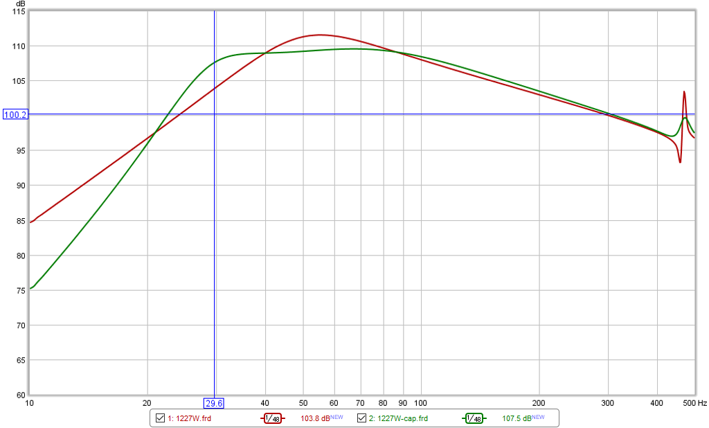

Add mass to the PRs to drop the tuning frequency.

A good PR system will sound like a good ported box, but with subtle differences:
- So long as you have enough PR cone area, they won't compress at high levels
- A PR box tends to be smaller because you're not trying to fit a 1m+ port in there
- PRs will add a little harmonic distortion as excursion increases, just as the main driver will. That will probably lead to a more even distortion profile.
When I say "distortion", we're talking a couple of percent THD, but it will be level-dependent. I've pushed drivers to >100% THD before now, but it doesn't sound pretty.

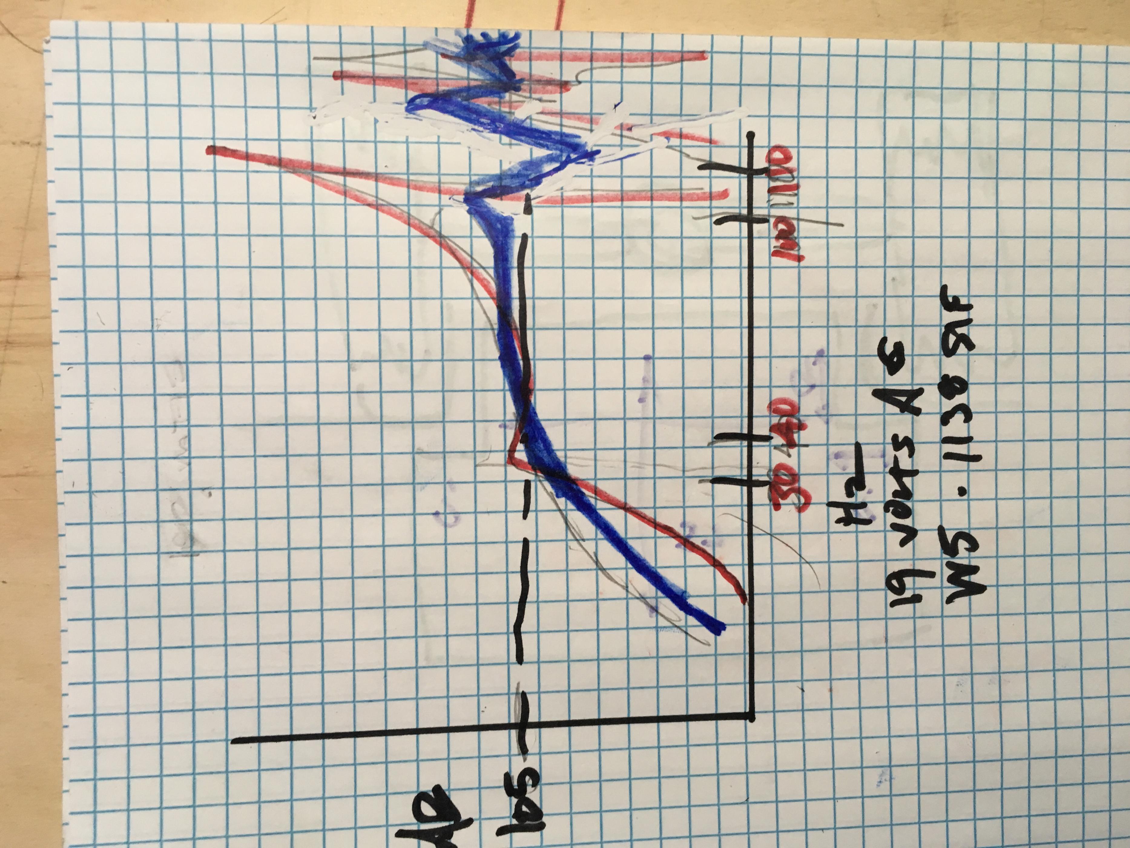

I hadn't thought of the distortion again, but yes, seems to be correct based on measurements of my current build. Luckily we're not very sensitive to distortion at low frequencies, particularly when it involves music rather than sine waves.
BTW, that driver seems to have quite a bit of excursion potential. I wonder if a passively-assisted design for it might work? I'm actually about to try just that sort of alignment with two 12" drivers that I have lying about. Lots of decent Xmax and they will be used nearfield, so I will likely not be running them anywhere near max linear output anyway.
You're welcome!
No, a higher F3, slower roll-off; the bend's cumulative friction adds a resistive component.
A 1.273:1 rectangular ratio is the optimum with up to a [1.273*9]^0.5 = 3.3848:1 not much worse, so 4:1 is fine and one I often used in the 8 - 30 ft^3 towers I use to build, still recommend for Altec, et al low tuned HE vented alignments [aka MLTL in recent decades].
It won't be a 'Voxel' anymore, but this type alignment tends to perform better overall morphed into an inverse tapered TQWT and if needing fine tuning can add a 'stub' vent [ML-TQWT].

Great info here and I'm going to consider those options. Maybe start with one due to the cost.
Seems to be quite a lot of love for PR and other builds have successfully used this driver for them as well, so definitely going to consider this an option. Would shrink the footprint a bit as well. Are you doing dual 12" passives with a single driver in your setup? And is it mostly for music as well?

"Passively-assisted" doesn't involve the use of passive radiators. Basically you add a whole bunch of capacitance in series with the driver mounted in a sealed box. Get the amount right, and the result is an extended response (the graph I provided is one such alignment). It also seems to knock down the inductance hump a bit. The graph is a sim of 12" drivers in a 1 cu.ft. (!) box. Basically the speaker baffle for the box will be just slightly bigger than the speaker itself.
It's the first time that I'll be trying it out. But the sims look good. The plan, if it comes to fruition, is to mount each 12" passively-assisted subwoofer on each side of the couch in the living room, for some nearfield subwoofer goodness.
Were I a bit more brave I'd love to try this myself but I will patiently await your outcome (if it happens) and maybe use it for a future project. The world of audio/speakers is extremely fascinating.
Have been a bit busier than usual with work (no complaints!) but will get some new drawings out soon. For simplicity and given that this is my first build, I'm leaning towards sticking with a 4:1 ratio slot port and finding the right external amplifier for it. The Monoprice 100W simple one seems like it would fit the bill quite nicely (65 WPC at 4 ohms) though I don't think it has a high pass / subsonic filter built in.
I did this(yellow pic) with that little tangband and it simmed as the red response curve in the bare cabinet using horn response. The blue was what I got from the RTA in REW(with smoothing drawn). I considered redoing it with a smaller throat chamber and without the expansion, but it’s all broken in now and is pretty fun for a 5.25”. Pretty sure you’ll enjoy it. If I see one @ parts express restock or on sale I’ll be jumping for another.
