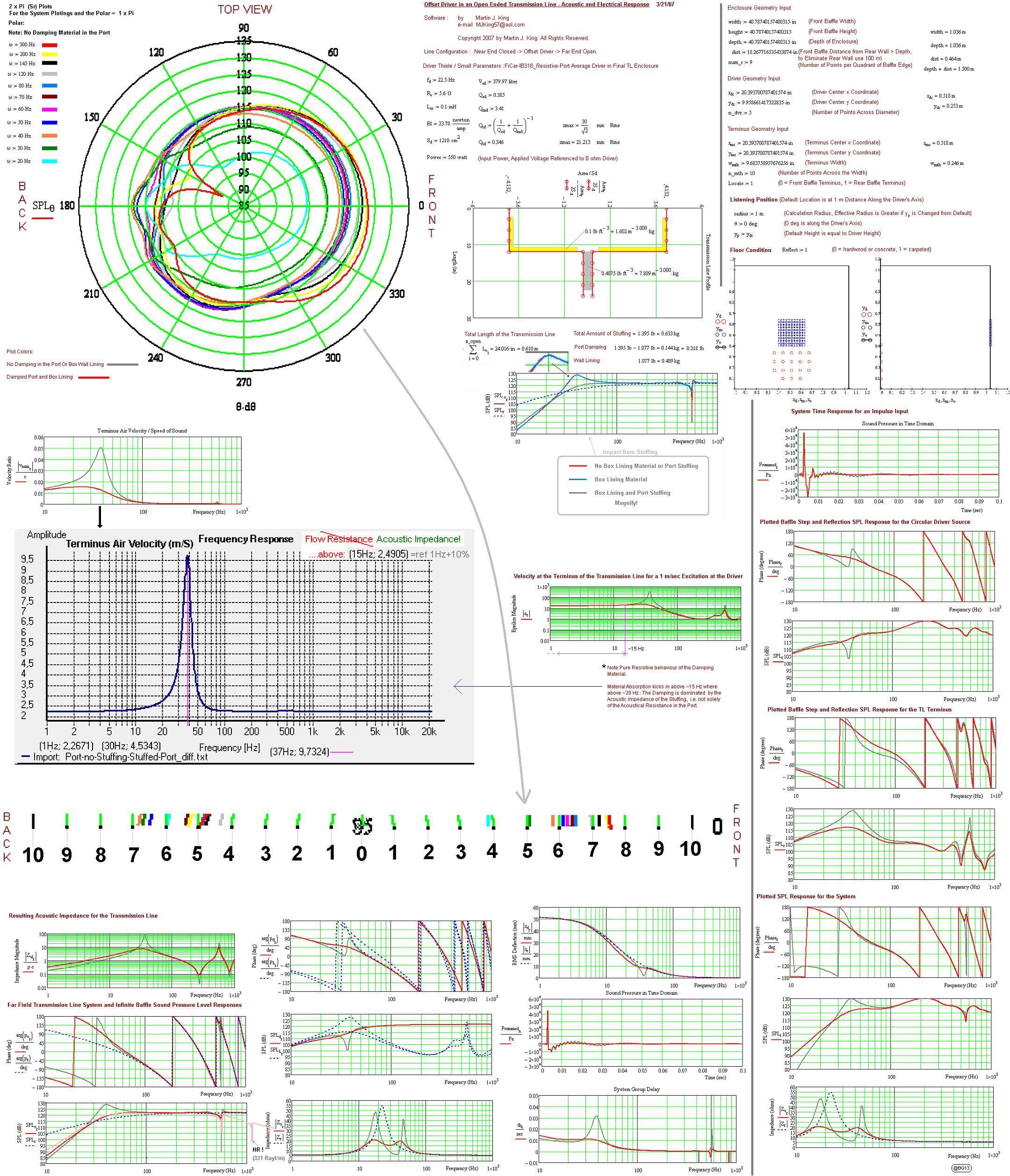

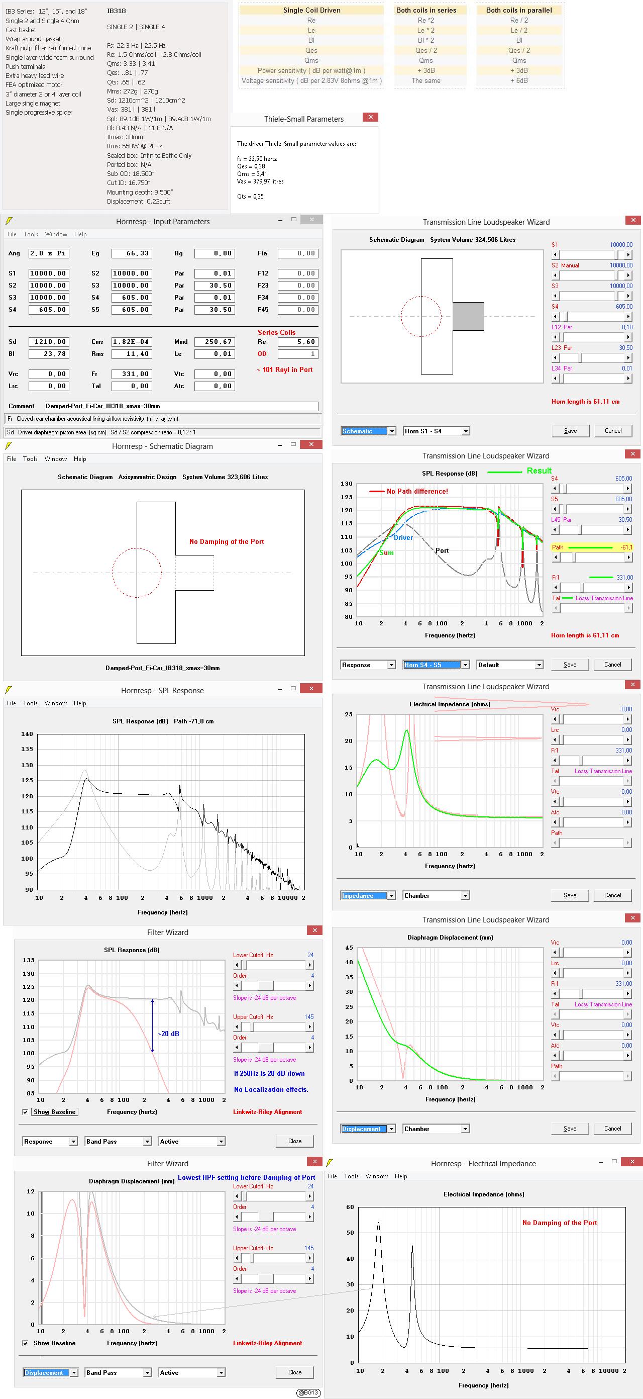

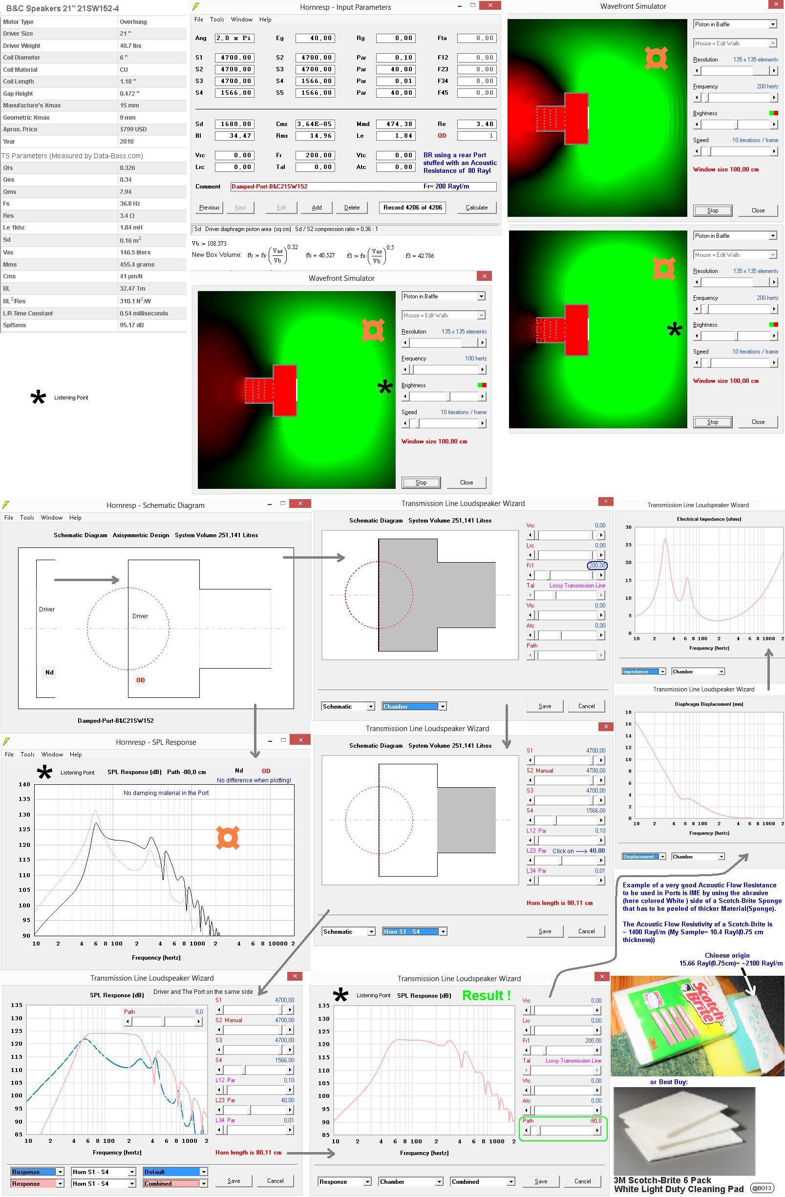

There will be no big deal I guess to experiment. What else concerns me, distortions in resistance ports, up to turbulent air flow. Let's see...
Agree with weltersys. Submitting a few simulations:
b🙂
How did you measure the Rayls values?
