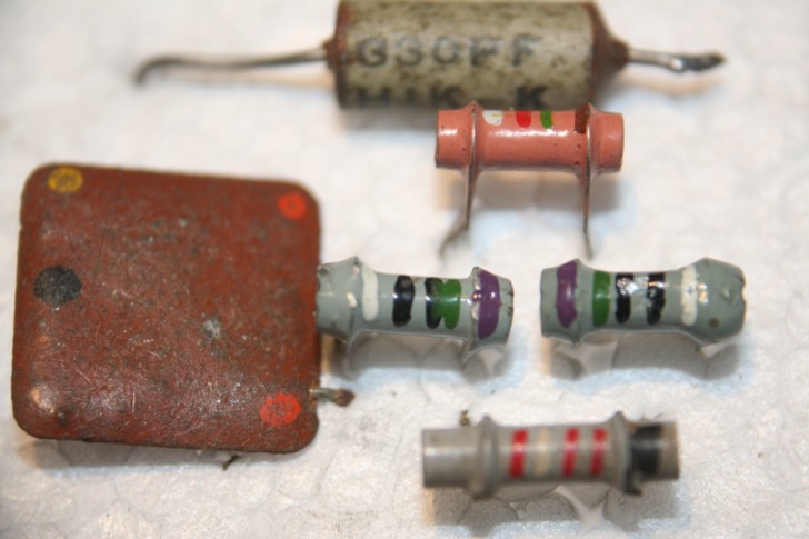

richj
Stuff from the junk box. Top LHS older vintage wax impregnated rod power carbons. Nom cold value as stated. Hot value +50% not unusual..
Top RHS rare wax impregnated <high stab cracked reworked carbon> with pink and other stability ind bands.These held values within stated % cold and hot. Hard to find.
Lower RHS bog standard carbon res. Some 20% values measure 50% Ohmage increase. Drift with time. Most vintage carbons can survive massive B+ surges whereas m/o types can change.
Lower LHS modern 1% 2% m/o film and glass TRW lowest. Stable cold and hot.
The most signifigant change is wattage v.s downsizing. The metal film power grey (lower left) can accept same power with hardly any coefficient change compared to wild temp drift of the top left rod types.
Considering most of the carbon types were fitted during the 1940-60‘s TV and audio sets, the sound quality of some vintage tube amps with these resistors fitted is still just as good as the modern stuff. Proof that tight tolerance is never required for tube work.
Carboot sales in the UK often come up with such goodies.
When you say "cracked" do mean that the resistor was cracked and they repaired it? possibly with wax?
The lowest on the LHS may be a TRW metal film, but it is not a carbon composition. TRW cc are molded dark brown. I don't think there is any glass in the TRW.
The fourth from the top on the RHS is a RCR20 (M39008) military carbon comp. That is about as good as they get. They are out of production worldwide. NASA published a bulletin about how they have no supplier. I found the NASA document on the web while googling carbon comp.
The three at the top on the RHS are what you are calling wax impregnated? They are so dirty they would have to have wax on them.
I recognize those, from sometime somewhere. Are those of British origin? The pink band is strange. Have you broken one open to see if they are carbon? Some of that type are wire as I recall.
It's the carbon that's "cracked" not the resistor
Are you speaking of a chemical process, or are you talking about spiraled resistors? Is it "cracked" in the sense that it has a crack spiraled into the film?

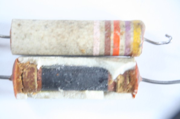

The pink salmon end colour types are high stab, the cracked carbon is a solid composition but the carbon has been structually altered, (akin to annealing steel etc at the upper critical temperature structure is finer grained then processed.)
Farnell also stocks a carbon ceramic but that is spiralled with restricted values i.e stock no's 1219226.
I squeezed the larger 47K, this is cat cracked carbon BS.1852 1952 stock and despite faulty end caps the carbon is finer in one rod. I can bust some other open but need more time to set up EOS etc.
This may seem the perfect specimen which one is after, soon after carbons were no longer manufactured, the world went into helix/spiral construction.
I will look for a typical specimen out of the junk box.

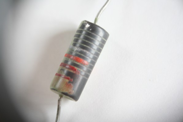

Here is another variant...a 22K 2W with eroded surface with spiral cut clearly visible. This was typ manu of early 1970's. On the package had limited working volts to 350V. I am probably correct that this is the type that everyone seems to loathe.

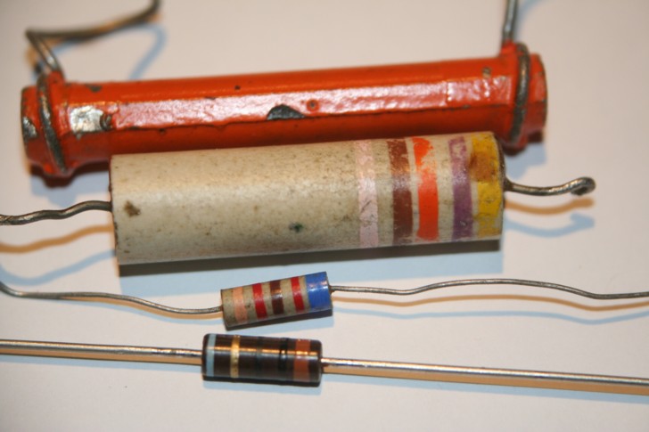

Are the resistors in the pics soft? They look like cement.
What are the colors on the 4th resistor from the top on the RHS? Is that org-blk-blk-gold-blue? If so, what is the blue 5th band?

I'll get back later and look at your pics. Post a close-up of the one with the blue 5th band.
After a closer look at your first pic, there are five of the old type that you are opening up, and only one has a silver or gold tolerance band. These are strange. Are the black and pink 4th bands the tolerance? Is that a brown 4th band and a pink 5th band on the large one at the top?
"Cracked" in this context refers to a process of depositing a carbon film on a ceramic rod out of a very hot hydro-carbon vapour. A spiral is then cut in the film to form the resistor. The "cracking" means separating out, in this context, and is not to do with grinding carbon into a powder. There is a clear explanation in Dummer's book, "Fixed resistors" (Pitman 1956).

I've enclosed a close up of the resistor in question. None are spiral but encased in a ceramic sheath. There were xmillions made of phenol bakelite ones too.
The lower one in the photo someone pointed out was US MiL = correct. that reads 10R
The large 47K is a 1953 Standard Telephone Cables UK, High stab (pink band) brown is 1% tolerance. (which it is)
The same applies for the small 620R.
Anyone guess the value of the single colour carbon rod resistor ? The second part is who can guess the measured value ?

So what looks like an orange band is really brown? 10 ohms on a meter?
The blue (is it really blue?) band is not a US military designation. This is what is strange. This may be a UK military resistor. I don't know where to get the carbon spec from UKMOD. They may be also published under NATO.
Is that a white band, instead of blue? MIL-R-22684 metal films, RL20, use a white fifth band as an identifier. TRW made them in brown molded, I have a few.

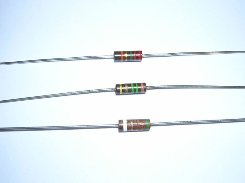

Here is a pic of three types of color-band military resistors.
The top one is and RCR20 (carbon comp-slug type element) with orange fifth band. Orange means failure-rate R. This type could also have a yellow band.
The middle one is a TRW RCR20 (carbon comp-the type with the glass tube inside) with yellow fifth band. Yellow means failure-rate S. S is the best of the failure rates.
The bottom is an RL20 semi-precision metal film Mil-R-22684. The white fifth band is the unique designation for this type of mil resistor. This is the only place a fifth white band is used on a mil-resistor in USA.
If your fifth band is really blue, and not white altered by the flash of the camera, then you have something that is not from USA. As far as I have ever seen, and I think I have seen all types.

I have identified the resistor with the blue fifth band.
The wide first band does mean wirewound.
It is an IRC 1W flameproof wire, SP20F. The 1995 IRC catalog says it is the size of a 1/2W.
The blue band means flameproof.
The resistor above it has a wide blue band for the first band. This should also be a wire.
