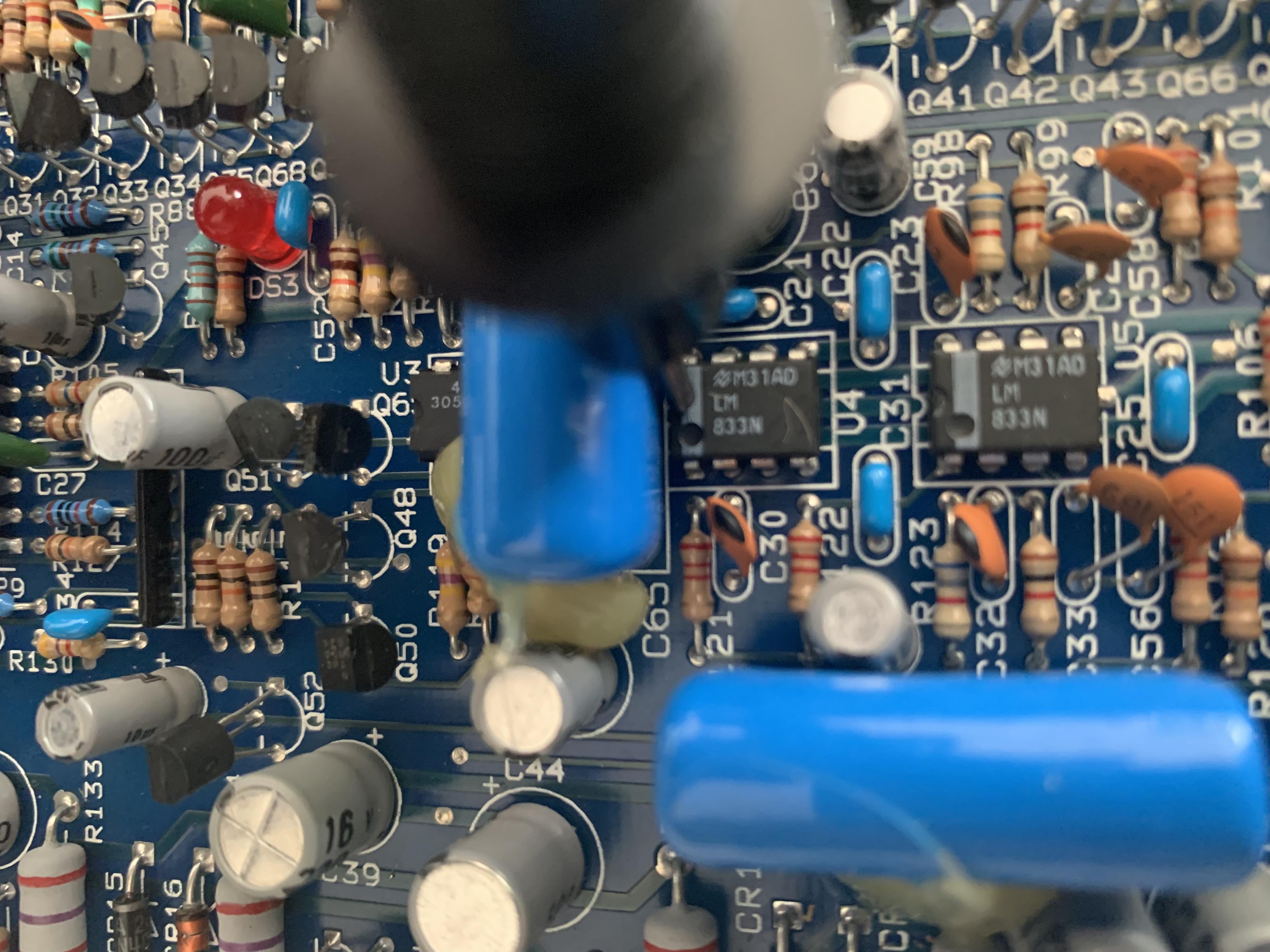

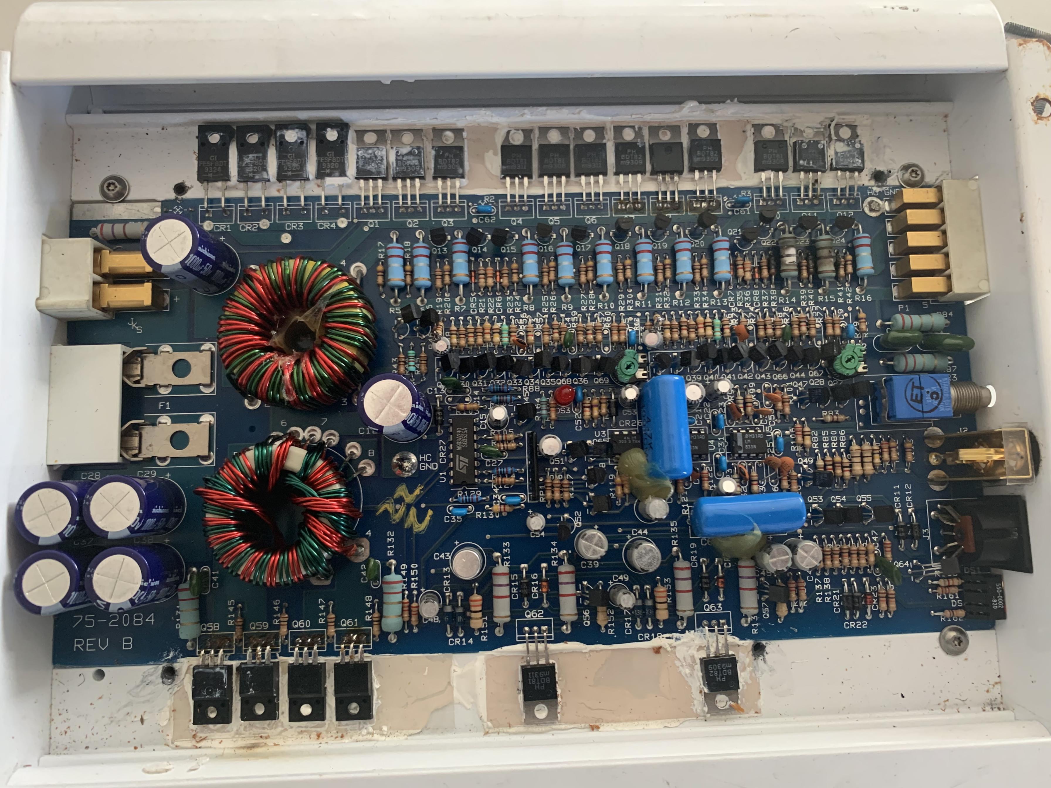

Ok so I’ve had this amp sitting around for a while and I decided to open it up and see what the problem may be. Right off of the bat I noticed 4 blow resistors. Without hesitation I decided to order them up so that they can be replaced. After I calm down from thinking I solved the problem so easily I realized to myself that they blew for a reason. Why did they blow. After a little more digging I found a short in one of the ic’s. Does this sound like a cut and dry reason in why the resistors blew or should I keep digging and all of what I found is part of a bigger problem? Sorry if everything I said is a bit elementary but I’m quite new at this so any help would be more than appreciated. I’ve uploaded a picture of the amp and the parts in question. To add it looks like someone has been digging around in this amp quite a bit. Thanks again !

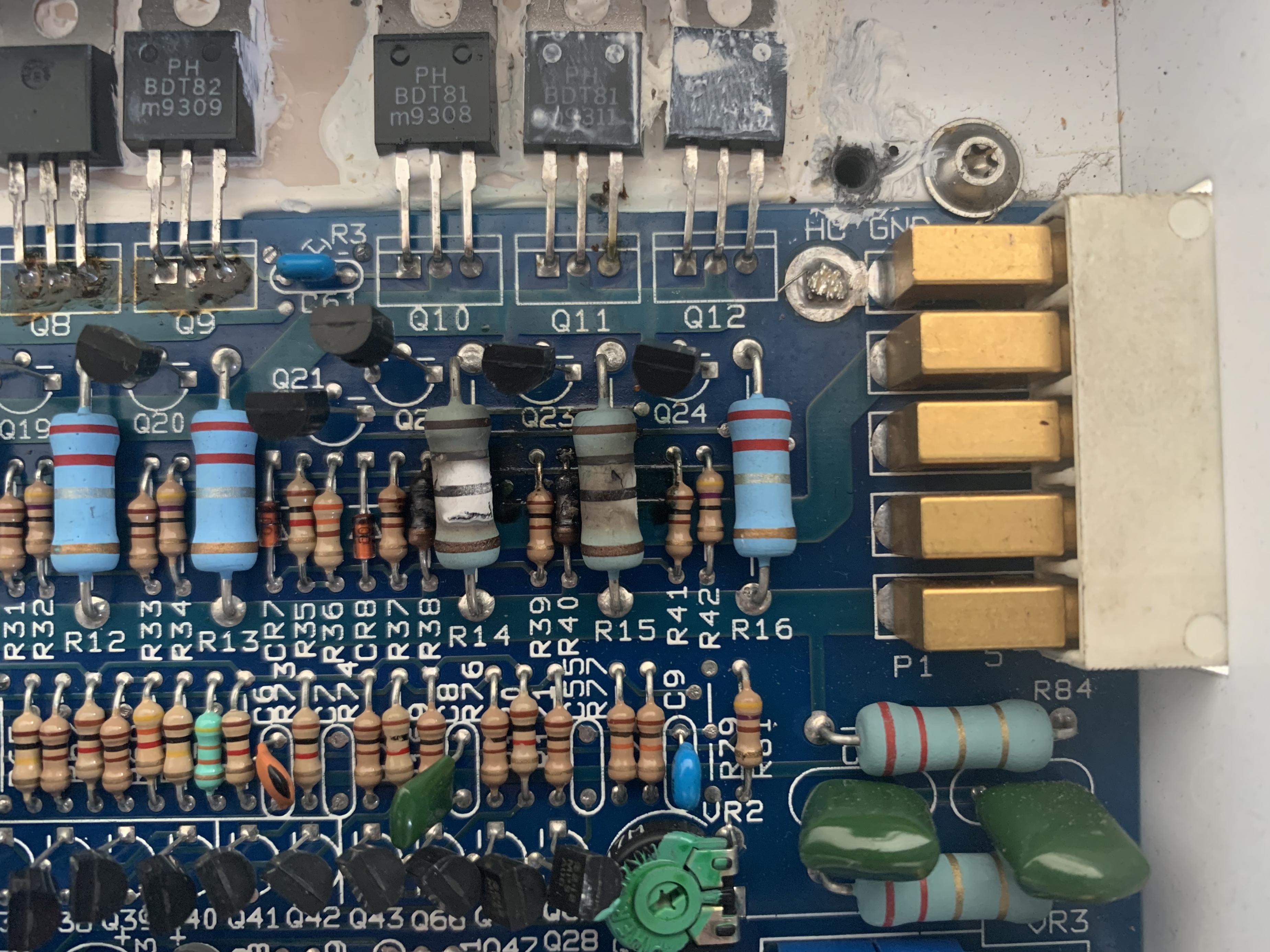

Are you referring to IC4 when you say you found a shorted IC?Idid t's not likely that a shorted IC alone did the damage to the Resistors.
The shorted IC and burned resistors may be due to shorted output transistors(Q10,Q11,Q12) and/or the drivers(Q22,Q23,Q24).
Remove the output transistors and drivers one at a time, and recheck the IC, and then the location of outputs and drivers.You may find one or several shorted transistors. It's also possible the IC is shorted.

One other thing. This amp uses bias pots and you will need to rotate all pots CCW before you power the amp up. I'm not familiar with this amps biasing adjustment, but someone here should be able to walk you through it.

Ok so the more I dig in this amp I’m starting to think I need to replace all of the midgets on the output side of the amp. My next hurdle will be finding a comparable or better option to replace them with. Unfortunately they don’t make the this specific transistor anymore. Could someone point me in the right direction ?
You should check them before blindly replacing them.
Speaker Load and Amplifier Failure
Are you referring to the BDT81/82?
2N6488 and 2N6491

If the power supply fets are isolated package you may want to change them out too. The plastic package does not transfer heat near as well as a metal tab TO-220. I think those used IRFZ48 as standard.
Seems like the more I search for parts the more I come up with nothing. Bdt81 and bdt82 are no longer. Also the power supply side has 30n06e in there and they seem to be no more as well. Sheew. Hats off to you fellas that can that source equivalent parts without blowing a brain cell.
The 6488/91 will work for the outputs. I'd wait on replacing the FETs until after the amp is otherwise repaired.
Ok so I took some readings on the fets on the power supply and the bjt’s. As for the fets they all measured out the same and had a good reading at.444. Only reason I was considering putting new fets in was because it looks as though they have been replaced at one point and if I was going to fresehen up the rest of the amp why not them as well. On to the bjt. They all seem to read the same. Q1-3 bdt82 measure .45 on the base .35 on the collector. Q4-6 bdt81 measure .47 on the base and .35 on the emitter. Q7-9 .45 on the base .35 on the collector. Q10-12 so and open. Sorry for the long drawn out post. I’m just trying to convey my findings. Hope I’m on the right path. I appreciate everyone’s help!
I also meant to add that all measurements were taken with everything installed in the board. Please advise is I should remove for further testing.
