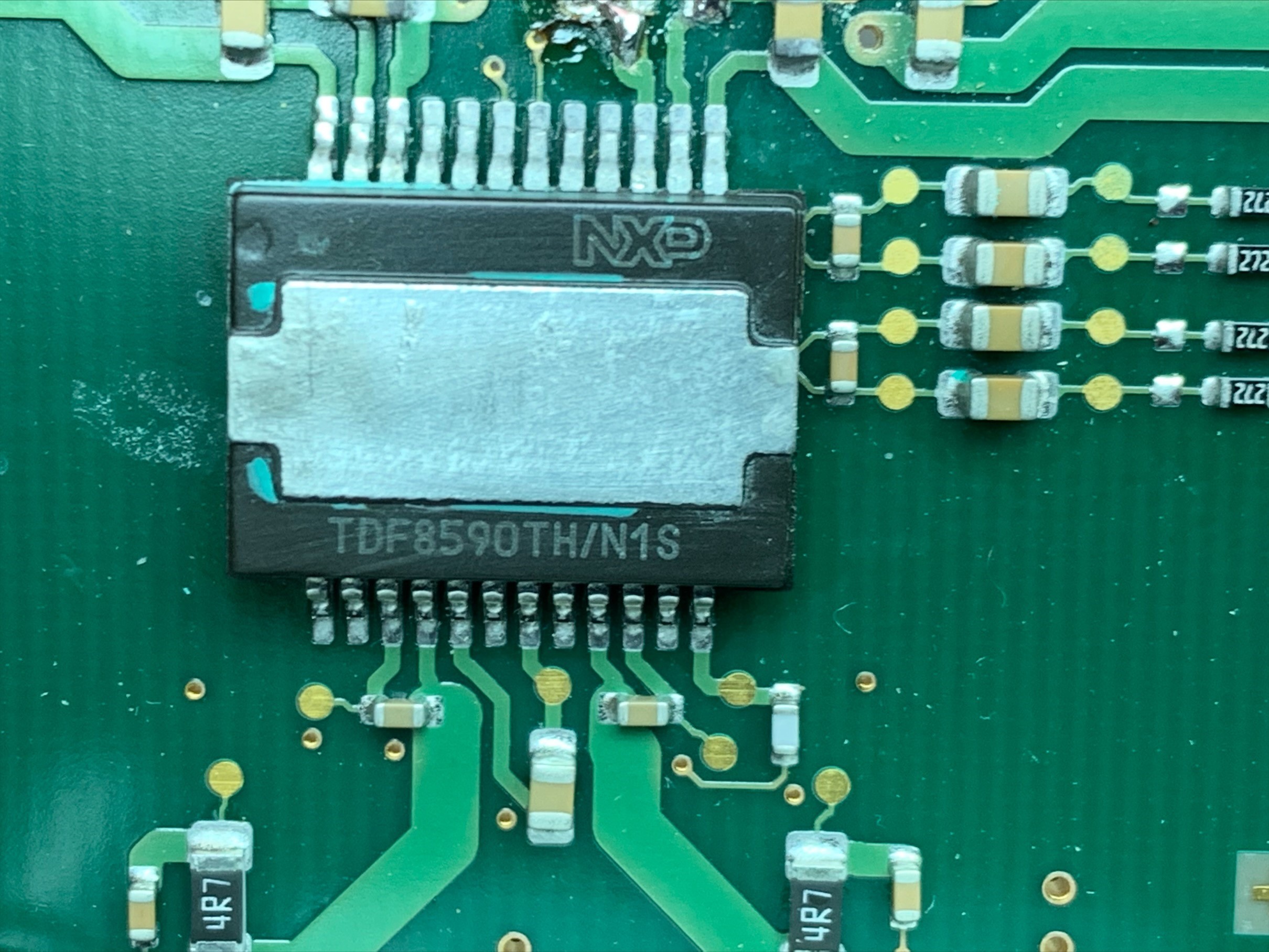

Hi there - one speaker (of 8) in my car audio system is not working. The speaker has been tested independently and works fine. The amp was located under the drivers seat and suffered road salt corrosion, some of which is visible on the PCB. In fact a surface mount capacitor has now fallen off. I think the cap is shot (open circuit when I put the multi-meter on the electrodes, which are almost corroded off). I could unsolder a similar cap and test the value, but I was wondering if there is an alternative "trial and error" approach I could take to validate if this is the source of the problem? I have attached 2 pics - one of the full amp, the second a zoom in on the cap in question (before it fell off, you can see the green corrosion).
If you remove the rest of the thermal pad from the IC, can you read the part number?
Using the corresponding parts from another channel is a well used practice.
In the attached image, the via looks like it might be damaged. This may be the case for other vias as well, especially those that are green.
Hi Perry - It looks like an NXP TDF8590TH/N1S audio power amp. See attached picture. I'll track down a data sheet.
Is there an effective way to check the vias? Can I simply use my multimeter to test for continuity between the top and bottom of the holes?

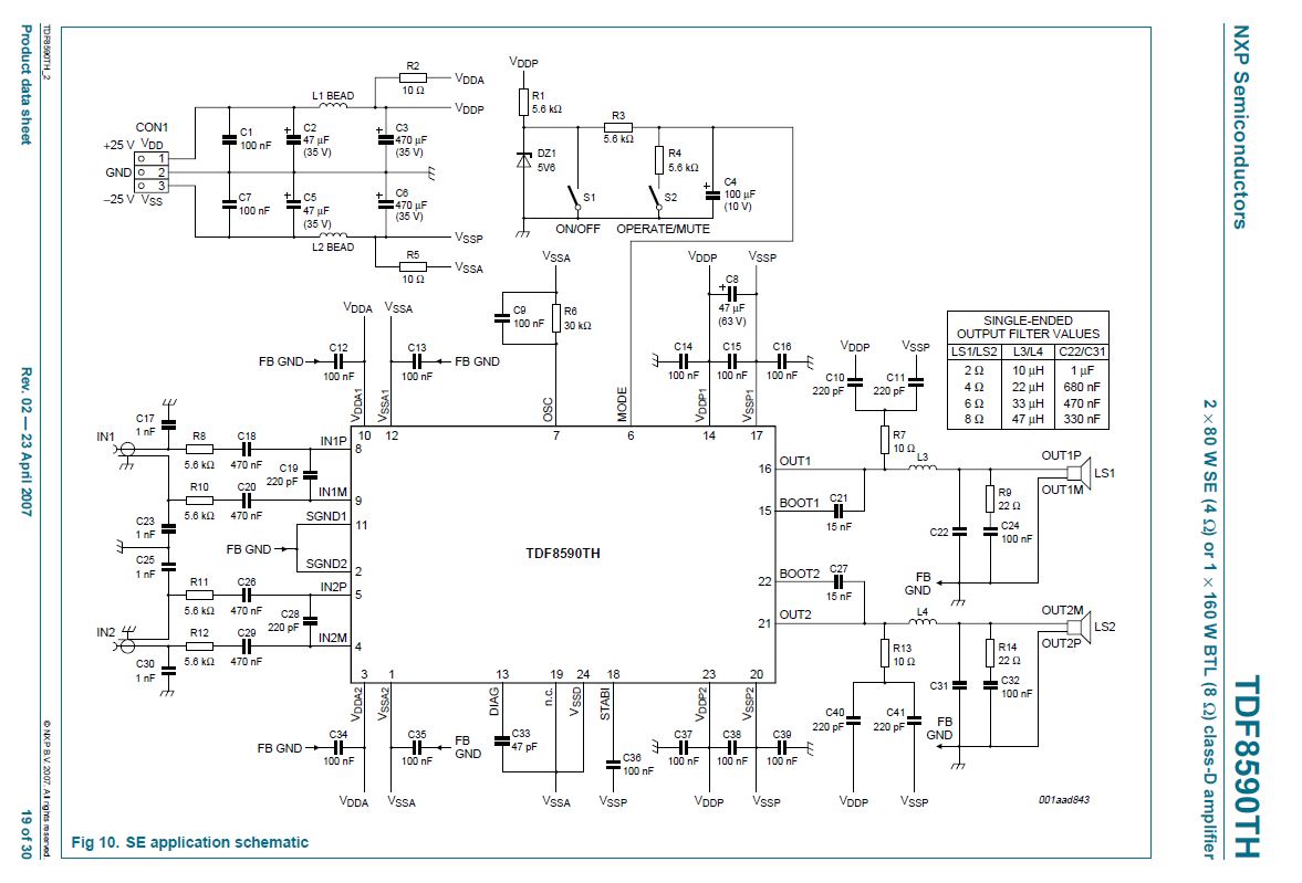

Hi again - I found a datasheet here:
Datasheet for TDF8590TH/N1S,118 NXP Semiconductors Amplifiers - Audio | Octopart
I think the circuit is shown in Fig 10 (attached), but I'm not 100% sure. My car has 8 speakers, and there are 4 of the TDF8590's on the board, so I am assuming they are configured in the 2-channel mode (per Fig 10).
Checking with a meter isn't definitive. It may show continuity but doesn't show the condition. If the pads look different (corroded/burned) and it reads like a dead short, I'd scrape the copper clean on each side of the board and use a wire to reinforce the path.
It looks like the caps are 0.1uF. That's a typical value for local bypass caps.
Perry - I replaced the cap and repaired the via and it works!!!
