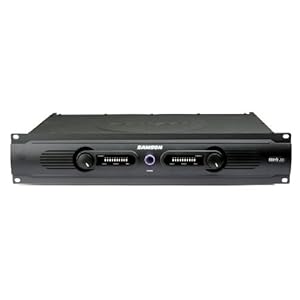

There are quite few "studio" amplifiers and PA amplifiers that are simply
moreorless the same as car amplifiers driven by an SMPS, only they are
more suited to 4 ohms per channel and 8 ohms bridged than 2 and 4.
Amazon.com: Samson Servo 200 Stereo Power Amplifier, 200 Watts: Musical Instruments
$200. So very little point messing about with 12V car amplifiers.

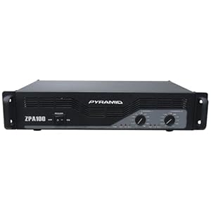

$100 for 1000W - very car like :
http://www.amazon.com/Pyramid-ZPA10...7978913&sr=1-4&keywords=100w+amplifier+studio
rgds, sreten.
