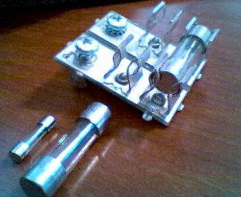

Car amplifiers work on low voltage DC and draw high current.
A simple 75w x 2 @ 4 ohm car amp that is not 2 ohm stable
will be fused at 15 amperes.
Look at your amplifier's fuse rating to get a ballpark on
what you need. 1.2A is not even close to be enough.
12VDC x 1.2A = 14.4 watts
thylantyr is right - you need plenty of current for a car amplifier. You might be able to use an old PC power supply as these have reasonable high current rating on the 12v rail (I believe PC PSU is rated at 12v @ 16A continious).

Actually, you can use the little transformer to check how much voltage the car amp actually runs on (open up the amp and check voltages at the rails), and then build a nice 400 VA supply for it.
Or run off car batteries. The small transformer will make a nice charger.
i made some speakers that used a car amp about 4 years ago, worked well, i used a 300va tranny and some nice big caps, you can get away with a smaller power supply by adding large caps on the rails, you'd need to make an RC cirucit for them to charge at first switch on. there are some 1F caps out there going cheap atm.
The caps would be enough to supply a large amount of current in bursts without the need for a massive tranny. but a car amp at that power will draw loads of current, if it is opperating at say 2 x 100w thats 200w total output and amps are only about 40-60% efficient so you'd be looking at about 400w inputpower. which is a lot of power for 12 volts tho amps can be 24v too.
