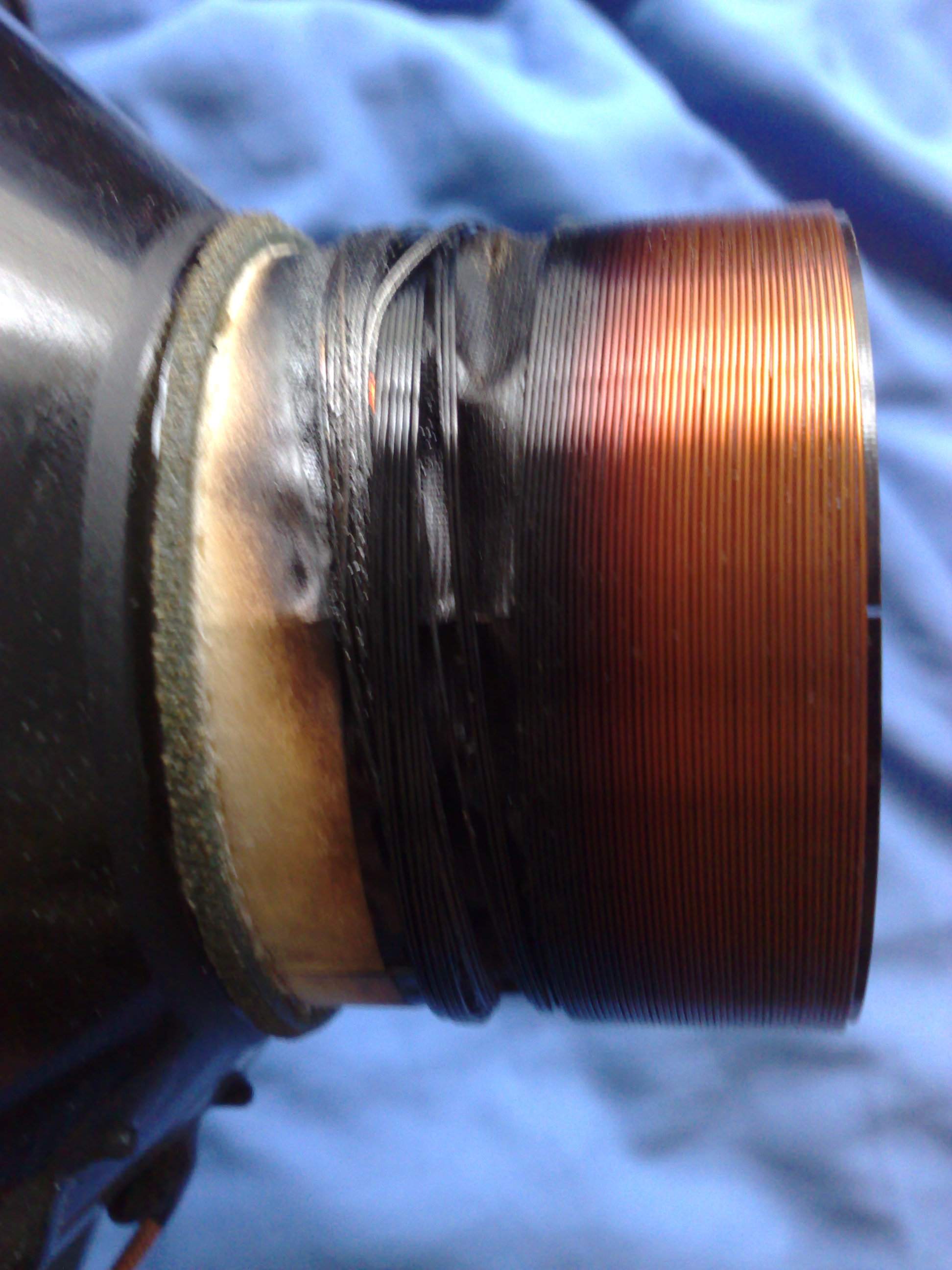

My new problem is a 4 channel digital amp – 2 channels being out. The source of the problem was careless removal of the bridged sub it was driving. The output was shorted, it would appear that the protection was not sufficient.
Now the amp seems to deliver full output from channels 3 & 4, when reconnecting the sub ( which blew on reconnection to faulty amp) a largish spark appears – protection kicks in and channels 1 & 2 stop until the connection is removed. I tried a second speaker and it dispatched that instantly.

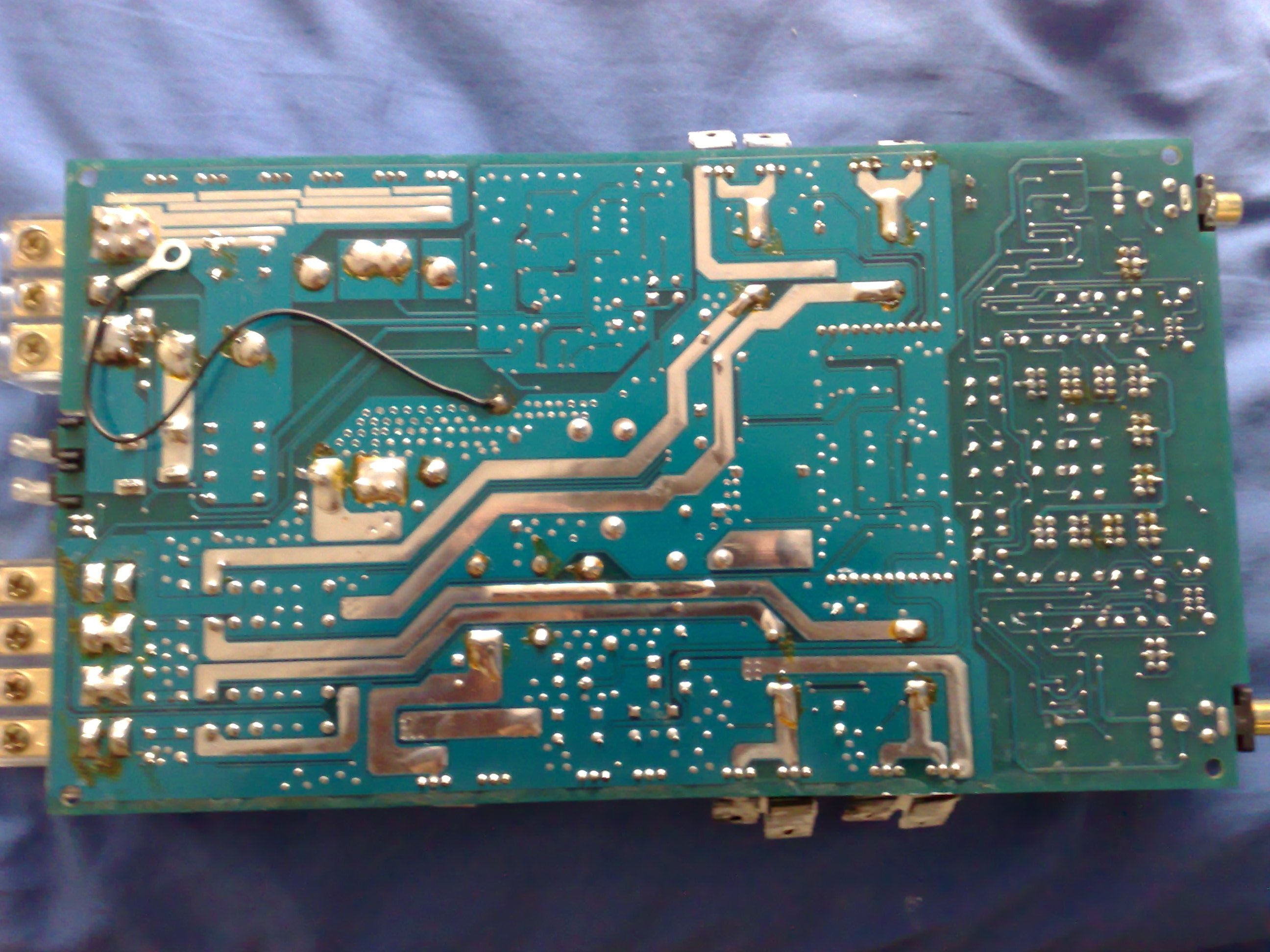

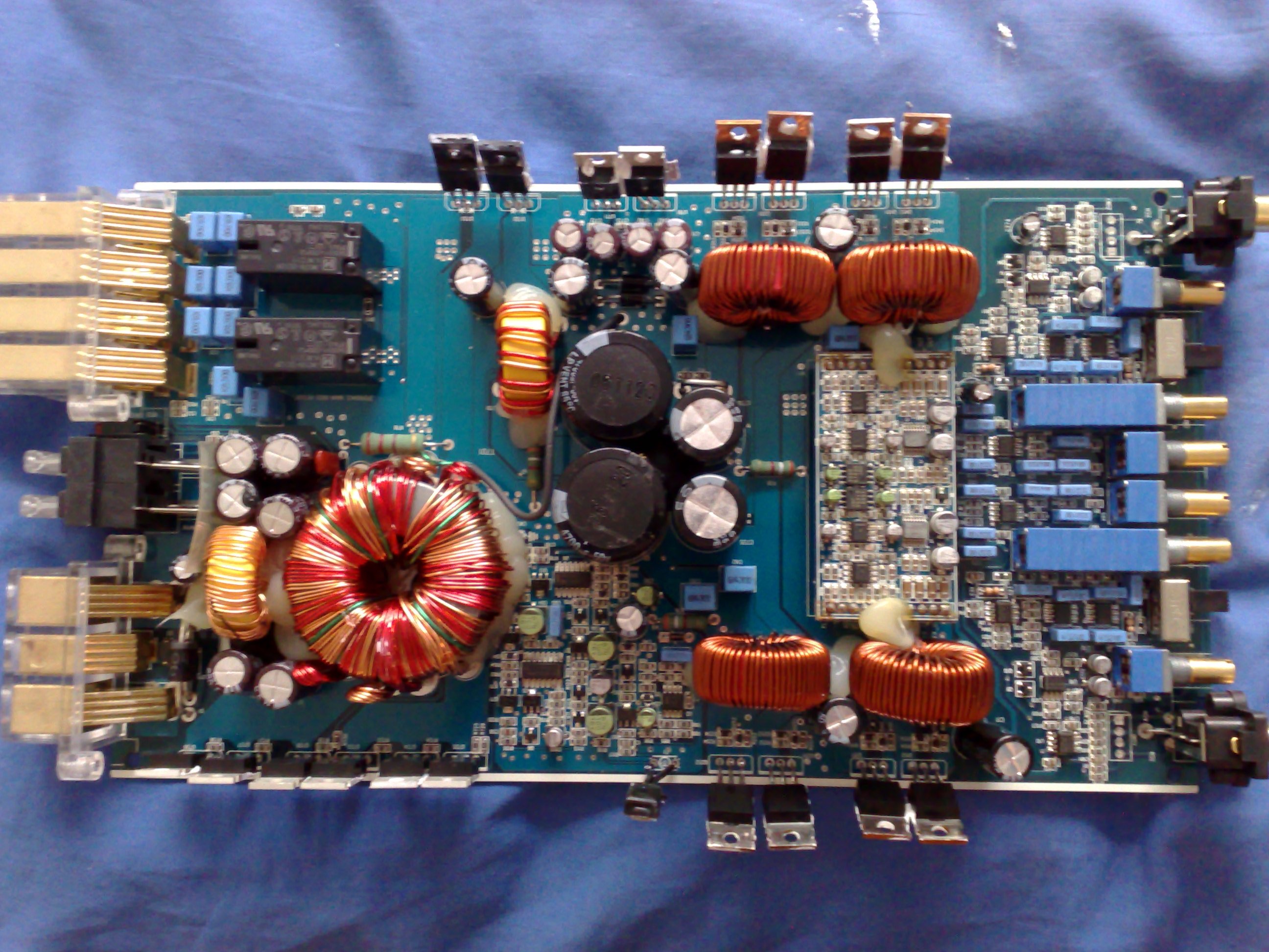

This amp has a design such that it is very difficult to work on in it’s case – the heatsink is the case, so powering up and testing is a problem without an involved removal/install process. Basically the underside of the PCB is inaccessible while the heatsinks are in operation.
So if I can diagnose without powering up all is the better. I suspect that the output transistors may have failed. Was hoping given the symptoms some guidance could be given on the best plan of attack for remedying the problem. I am not very good at this stuff so please do not assume too much knowledge . Thanks for any help given.

At the very least you have some blown output devices (the FET pairs next to each output inductor). Check them for shorts. Hopefully nothing blew on the modulator/driver daughter board.

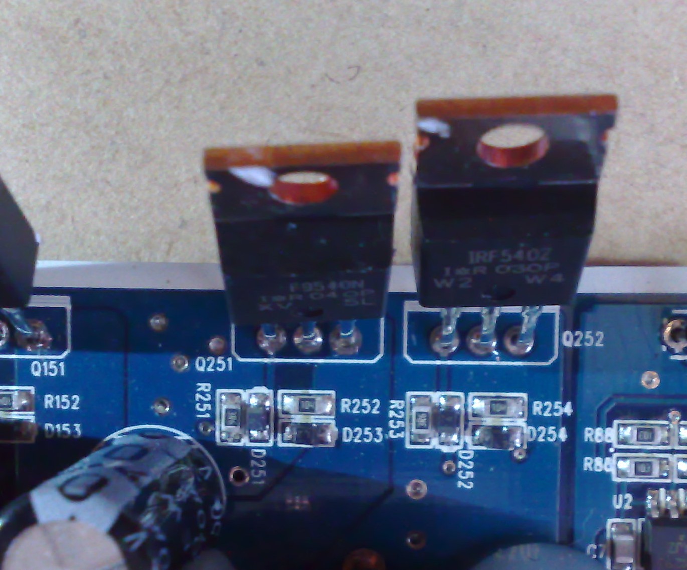

That reading is in circuit on 200 setting for resistance and am guessing it is the driver circuit as the diode is connected to the FET and sits on the pcb. I have no schematics and can only photograph the pcb. The reason I am thinking it is the other mosfets is that I can measure resistance (then the meter will go open circuit) when I connect the probe to one of the failed outputs and an original FET.
These are the diodes I am measuring, all the gate diodes reading 4 ohms, no reading on any of the diodes such as d253, however on diode test they are showing around the 900 level. The exception is on one of the 9540 & and one of the 540 original FETs, which are very low almost zero - all are being meaured in circuit. Given that they are measured in circuit could it be a fault with one of the original FETS or the driver diodes or both?

You need to remove the suspect devices to measure them... to be certain. Again without knowing circuit details it's difficult. Hard to make out in the picture but those resistors look to be marked 3R6 (3.6 ohm ?). Could that be the 4 you measured.
Removing them is the only way in an unknown circuit. The resistors... it looked from the pic that the 3.6 ohms could be across one of the diodes. That would read around 4 on a DVM when meter lead resistance was added.
