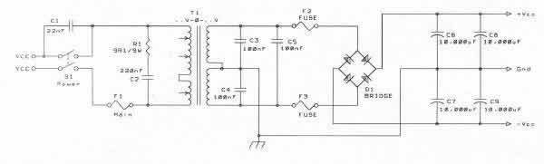

maybe a stupid question but...using a power supply scheme for a dual voltage(+/-35V) and 1 rectifier bridge the filter capacitors form a capacitor voltage divider; so the max voltage of the capacitors is 70V or 35V?because i remember that in a capacitive voltage divider it's mandatory to use the max imput voltage as max voltage for the capacitors...am I wrong?
As long as the caps aren't connected rail-to-rail but rail-to-ground, and this is the standard method, 35V rated caps should be fine. DON'T connect one 35V cap directly from +35V to -35V.

what is the open circuit output voltage of the transformer when connected to a nominal mains supply voltage?
How high can the output voltage go when the mains supply voltage is at maximum?
In the UK this is +6%. i.e 254Vac for a nominal 240Vac supply
Now calculate the maximum peak voltage on each of the smoothing caps.
Select a voltage rating to suit the rail to ground voltage.

your 2*25Vac will produce a nominal +-34Vdc.
The upper and lower voltage limits, assuming 6% regulation, will be 31Vdc to 38Vdc.
Your choice of 50V caps is just fine.

yes, considering also that italian mains will vary more than 6% i think it's a good choice, thanx a lot!!
Gonna need a 80v+ cap for C5.
It's gonna see the Peak to Peak voltage of both secondaries because the cap sees them wired in series.
wait wait...are you sure?that was my problem...i thought this too, cos it's a voltage divider...probably during a transient it will go upper 50 volts...damn...does anybody has a sure experience with this schematic??please!!!
I have already told you the answer, as has Andrew in post 7. The C5 across the whole transformer does need to be rated higher... because it's across the whole thing.
I'm not sure what your confusion is now, please can you explain?
head_spqaz says i need 80v caps!!but i have +-35v and the caps are connected between voltage and ground, but he says that they see the whole differential voltage, so 70v, is it true?i think maybe during transient could be true...

No you can't use resistors. They will be hot, waste power and make regulation even worse.

The following link show the principle of the PSU supply. My main question is whether or not it will be safe using capasitors close to their nominal rated limit, when their surge limit is somewhat higher. In my case - 60v VDC nom. tolerance and 75VDC surge. I was hoping to bring the voltage down to 58-59 volts with the use of power resistors. Hope the link will enable you to see what I 'm getting at. The resistors will be connected in series with the + and - out of the rectifier before the caps.

you have an RCLC supply with a very small R.
The problem is slightly worse than you described.
Have you measured the secondary voltage of the transformer when the mains input is exactly at the nominal specified voltage?
You need to correct for any variation here first.
Now add on the +6% mains voltage variation that is permitted in the UK.
You could end up with a considerable overvoltage when doing it this way.
BTW the Vsurge rating would take account of the +6% on the mains and other glitches that get fed into your house wiring.
