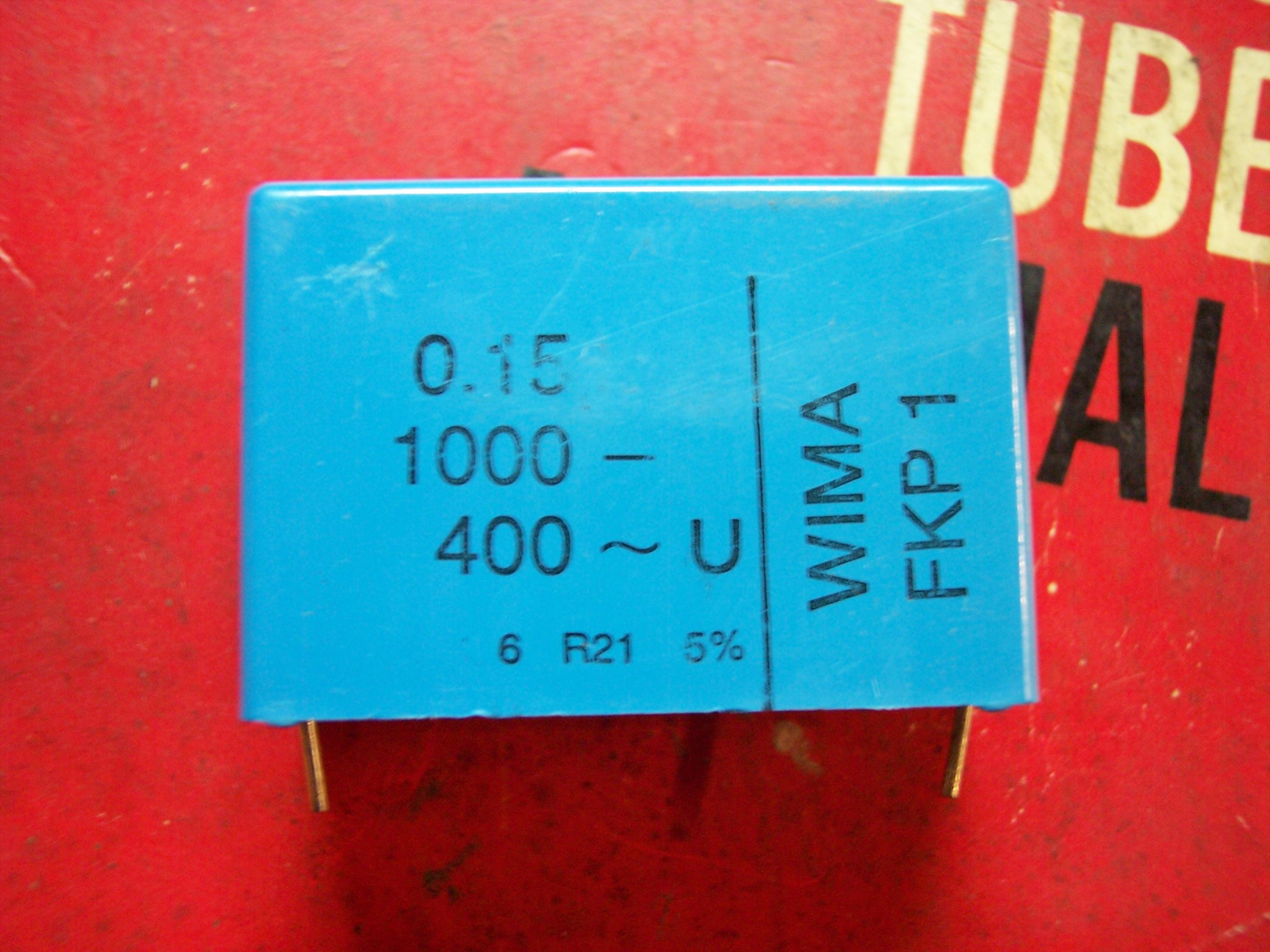

I have found these FKP capacitors cheap, and have never used this type before.
Have any of you used these in your tube circuits, and if you have, are they any good?
I am asking, prior to purchasing the entire lot for cheap, but I don't want a bunch of useless junk in the shop if you know what I mean.

hello.
these are high quality polypropylene film caps made by wima (germany). used in power applications (monitors,switched mode psu,.......). datasheets should be available.
blue case = old style,without rohs conformity.perhaps that is the reason why they are so cheap.
the new ones (with rohs) have a red case with a yellow bottom.

It is the classic capacitor you find in (CRT) TV boards, in the high voltage section. They have a yellow bottom, like the other WIMAs. They are found in every electronic parts shop here. I got some, but i found them difficult to use in point to -point wiring.

These are very good cap's. and for 5c why even give it a thought?
Made for PCB but you may extend the leads to use with point-to-point.

Assuming they're genuine, they are excellent caps. For audio applications, there's really nothing better.
cheap component mightbe sources from PRC wich currently found lots of fake copies,u name it they have it,beware!
agreed..don't think twice on this FKP1, no metal film inside 🙂..watch out also for green FKP2's...

I have seen similar caps in tv power sections before, but these are much larger than the ones that I have. (more than likely due to the age ?)
As far as being fakes, not likely as I am buying them from a 86yr old man who has much NOS parts and has not ordered anything new in the last 20yrs because of the large supply warehouse. (His hobby business)
(I had to scrape a 1/8" of dust off the top of the box these were in...)
Anyway, enough rambling here, Just a local lucky spot 😛.
