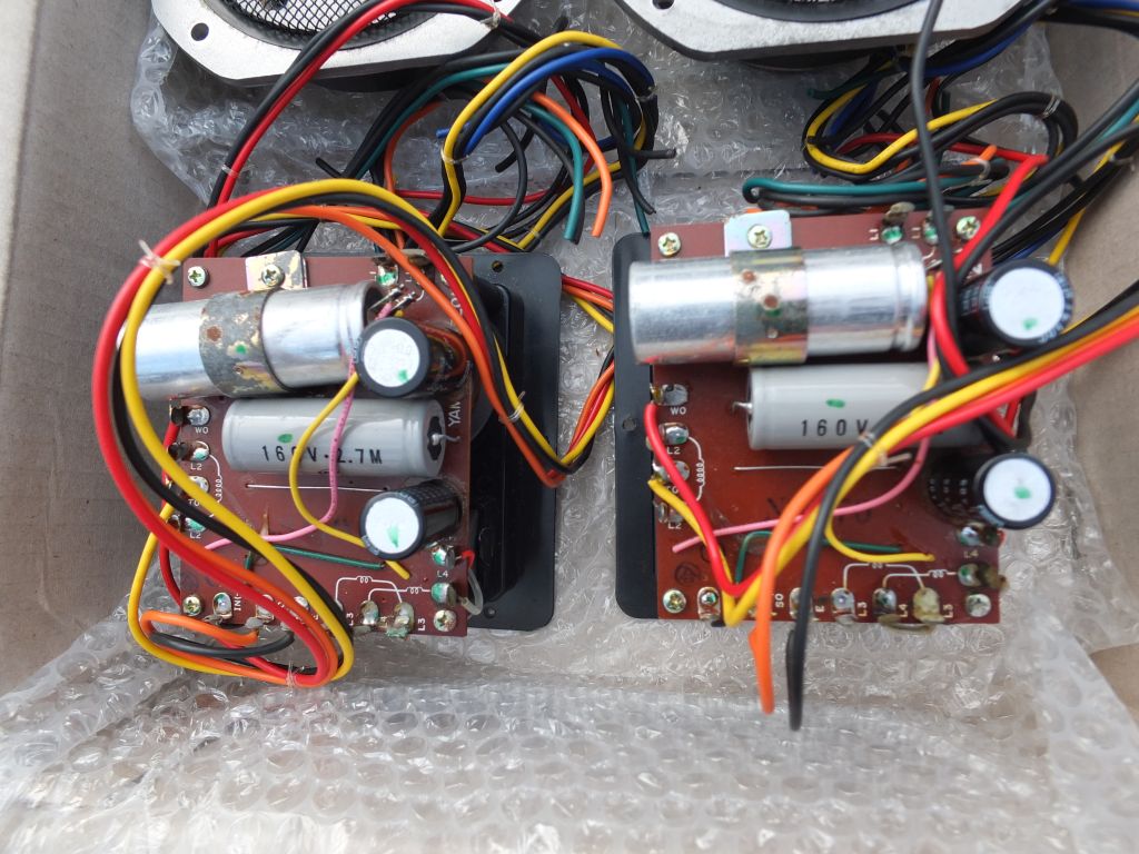

I'm looking at freshening up the crossovers in a pair of NS 670 Loudspeakers.
Each crossover includes: 2 upright electrolytic cans. One is marked 18µF(M) 50V CE P, the other is marked 47µF(M) 50V CE P
Two cylindrical cans lying down: One is marked 3.5µF(M) 100 WV MPM AC, the other is marked 2.7 M 160V
The one marked 2.7 M, I'm not sure of.
Are they all µF values?
The 47µF poly's I have on hand is much bigger than the old electrolytic ones and connect at each end rather than at the base on the existing upright style.
Would you recommend fitting them to a secondary outboard circuit board via wiring?
Is this recap exercise worthwhile?

To aid the identification of components, photographs are most useful (see attachment).
I presume the puzzling cap is 2.7uF - to be absolutely sure, you would have to measure it on the capacitance scale on your multimeter, or use your ESR meter.
diymore LCR-T4 ESR Meter Transistor Tester Diode Triode Capacitance SCR Inductance Mega328 MOS PNP NPN With Test Hooks (Battery buckle with Case): Amazon.co.uk: Business, Industry & Science
Yes, it's OK to be creative when substituting different size/orientation capacitors - they may be mounted 'off-board' in the way you suggest.
The recap exercise is only really necessary if the original caps are out of spec (high capacitance/ESR). Again, measurement is your friend.
Replacing the capacitors with different types may alter the balance of the crossover network as Yamaha intented it to be, and alter the sound of the speaker - different capacitors are not necessarily better capacitors! 😉

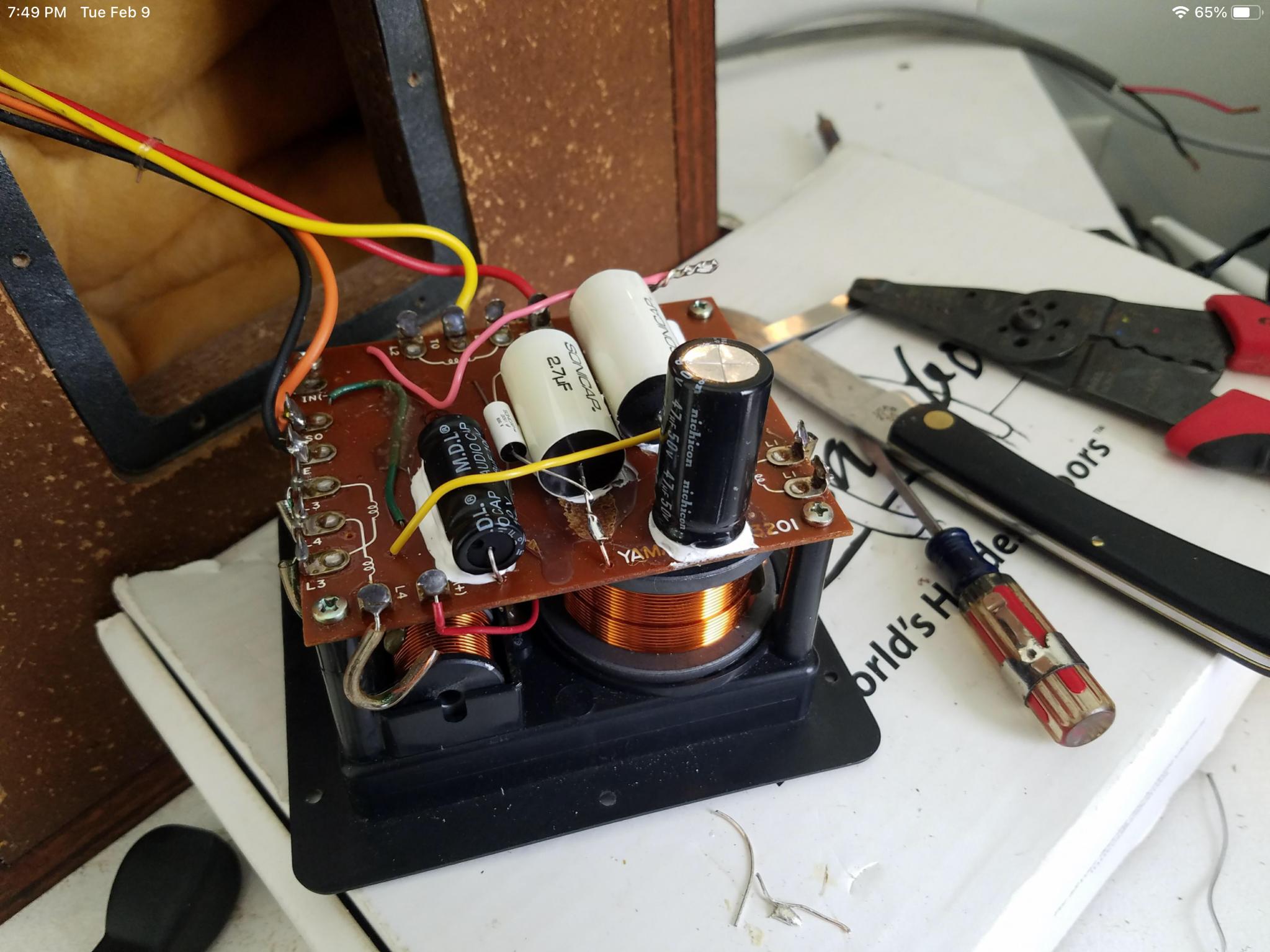

Here’s the ones I just did......I was skeptical about using electrolytics for the shunt caps but it worked awesome. The sonicap poly have a nice neutral sound for the series cap on tweet and mid.

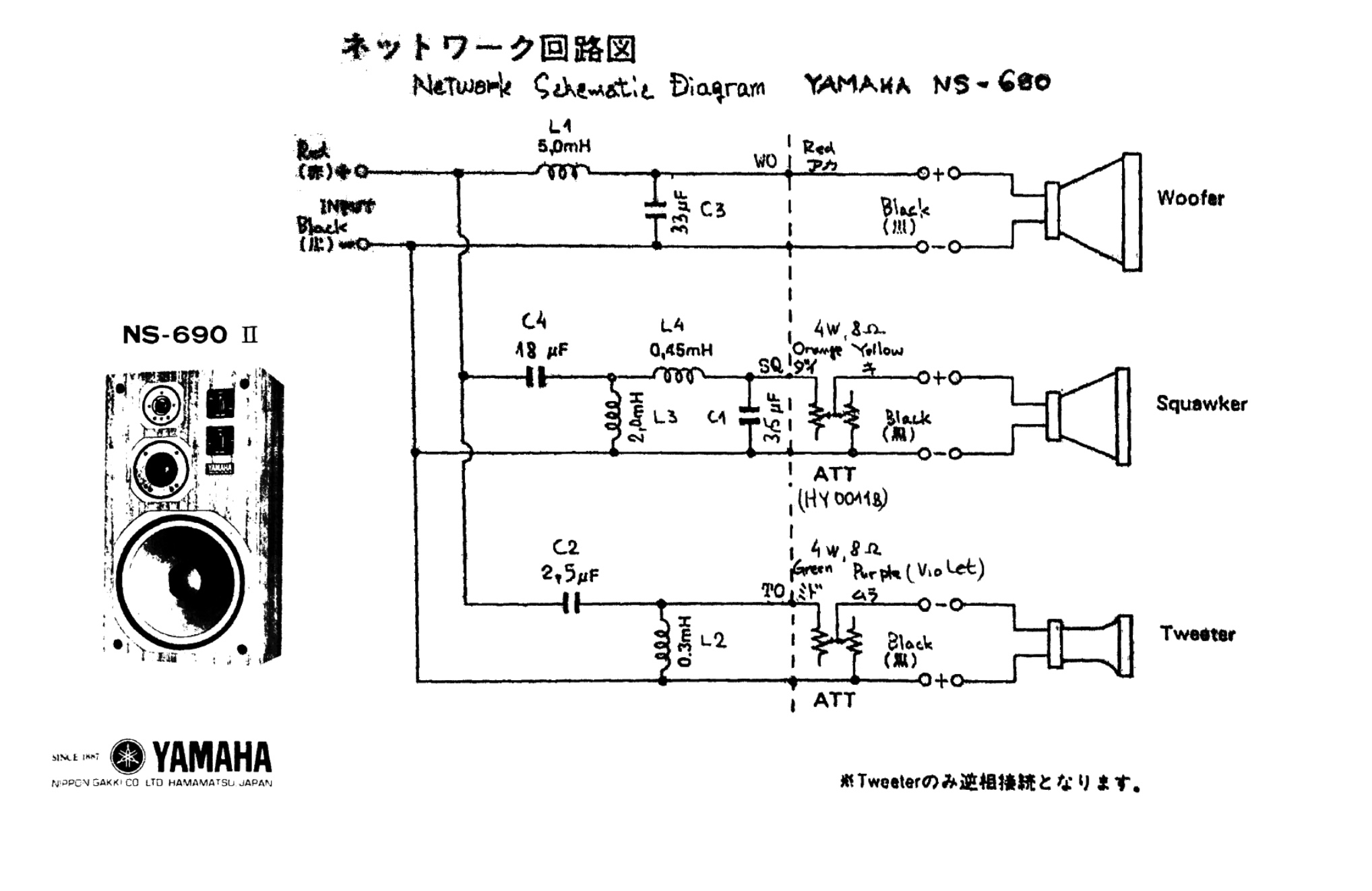

Couldn’t find the 670 ....Here’s the 690 pretty sure it’s exactly the same configuration just a couple different values....mid seems the same.
Edit...I hadn’t found this schematic when I did mine and did not realize the 18uf was a series cap for the mid......I might have used poly there if I’d known, still sounds good with the electrolytic though.

OK Cliff, thanks to Bob we now know the location of the capacitors in your crossover:
The 47uF is in parallel with the woofer (the woofer "shunt").
The 18uF is in series with the midrange, and the 3.5uF is in parallel with the midrange.
The 2.7uF is in series with the tweeter.
The large value woofer cap can be an electrolytic type when a film cap of the same value would be physically too large to fit on a compact circuit board.
The large value woofer cap can be an electrolytic type.

1. First time I've come across parallel vs series when connecting caps to Drivers??
2. If I stick to the same circuit boards caps termination points would the parallel and series issues automatically be taken care of?
3. Also I have two spare 47uF film caps left over from the Technics job. Is it still worth using them?
1. In a basic LC filter circuit, the low frequency voltages appear across the capacitor (C) while the high frequency voltages appear across the inductor (L).
Therefore the woofer is connected in parallel with the capacitor in its section of the crossover, while the tweeter is connected in parallel with the inductor (leaving the capacitor in series) in its section of the crossover.
