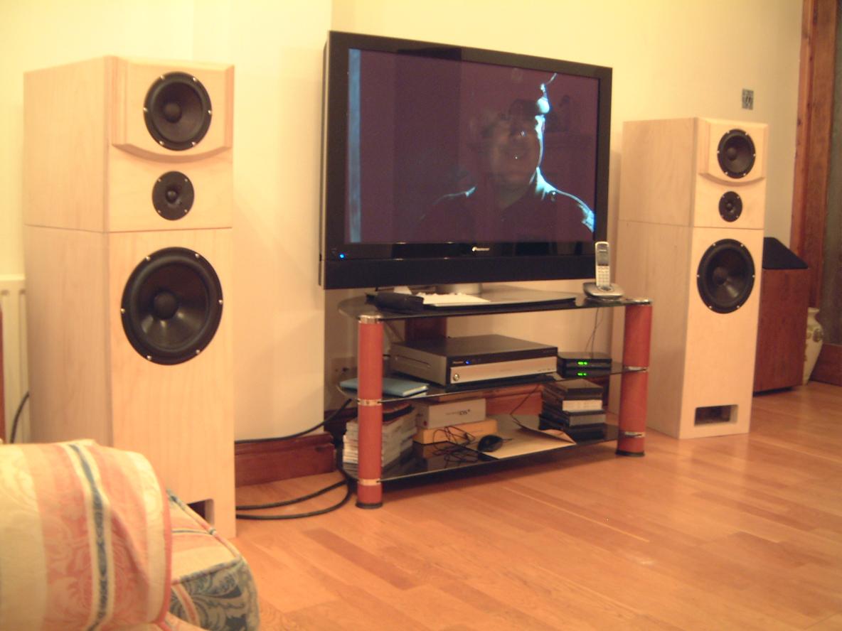

Hi folks , has anyone replaced an inexpensive capacitor with an expensive one in a speaker crossover, I have built a troels gravessen design 3 way speaker and the capacitors that I am thinking about replacing are for the midrange speaker a SEAS ER18RNX, they require between 80 and 100 uf
I have fitted 4 clarity cap esa 22uf, im thinking about replacing these with

Oh sorry the crossovers are in a separate box placed at the rear .

I wouldn't say that. The correlation between "better" and "more expensive" is pretty weak, though. And "better" is very dependent on exactly how the cap works in a given crossover.
ESR, ESL, and microphonics are the most important parameters to consider, and again, depending on the filter design, "lower" may not necessarily be "better" for the first two.
Be highly skeptical of marketing claims for expensive caps!

I've gone through a load of caps in different places. They do make a difference. However, considering you're in the course of replacing quite good caps with slightly excellent but extremely expensive ones... Just use the money to buy records. It'll buy you more joy for the money, really.
If it were a treble unit, and you were replacing a small Clarity ESA with a small Jantzen Superior Z, I would say "go for it", but not in this case. Buy More Records instead.

Before you start replacing caps, first ask the question if you can adequately measure the results of these changes. Differences in ESR or ESL might lead to pushig the xover out of its original tuning. This could make your loudspeakers sound differently, but what you actually did is to introduce a tone control without knowing it.
