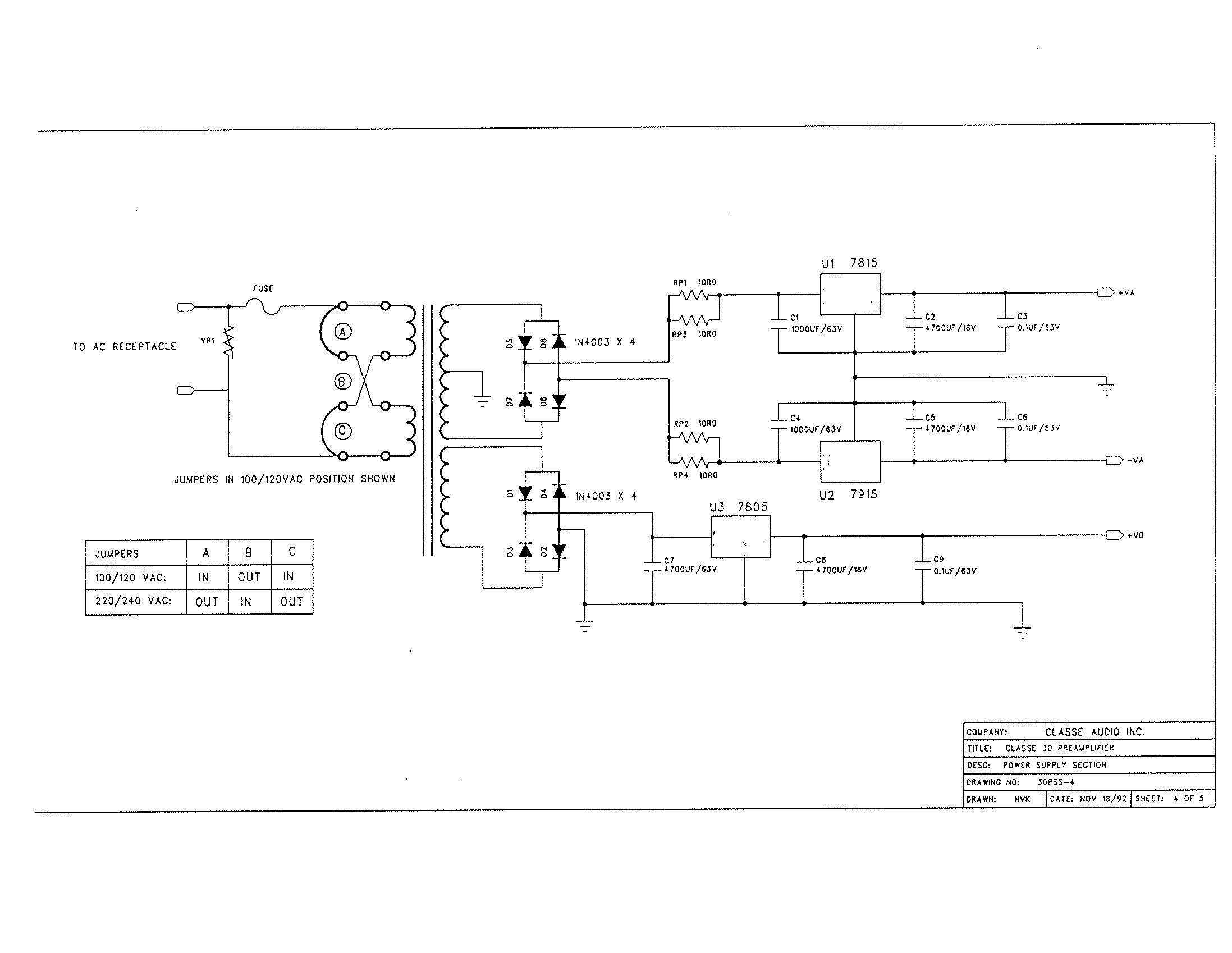

The electrolytics in my preamp are about 20 years old and due for replacement. In replacing the ones in the power supply I thought I'd move up from Philips to Nichicon KZ but the 1000uF 50V cans are a bit large for this space. I could attach via some hookup wire or could try 1000uF25v. Is the 25v likely to be too low a voltage? The Philips they are replacing are 1000uF 63v, but just after that are the opamps which are rated at only 15v. I've attached the PSU schematic for reference.

Thanks- OK, caps to the right of the regs need to be 25v or higher for the 15 volt regs and 16v or over for the 5v reg. Caps to the left, the input side, well I would measure the actual voltage but I suspect 35v is probably near the mark. If the voltage is around 22 then don't use 25v but go for 35v

Hmm, interesting. That schematic is not even what is in there! Can't believe I didn't notice before. The earlier caps on the pos and negative rails is 1000u 63v but measures 15vdc in use. The second cap in the chain is not 4700u 16v but another 1000u 63v, and it measures 28vdc in use!
So the main power rail schematic cannot be right, as the operating voltage is 28v which would fail a 16v cap. But it seems I could either:
BTW: On the 5V rail the spec shows first 4700u 63v and then 4700u 16v, but both are 4700 16v! The first measures 5vdc and the second 10.8vdc in use.
The first cap on Neg input and Pos input measure at 15VDC. But the second measures at 27.8VDC!

- use a 1000u 25v on the earlier caps and 1000u 50v on the second caps on the power rails. OR
- use the 1000u 50v on the earlier caps and 470u 50v (or 100u 50v) on the second caps. The smaller secondary cap might free up enough physical room for the larger caps, though laid on their side.

There is something very wrong with that values. I think it is the other way around. You can not have higher voltage after the regs than before them ! The first filter caps are for filtering ripple and the voltage on them should be at least 3 V higher than the voltage number of the reg. So an 7815 will have at least 18 V on pin 1 and the 7915 will have at least -18 V at the input. If they work like they should you will see +15 V at the output of 7815 and -15 V at the output of 7915. Can't tell it much simpler....these are classic text book design rules.
Maybe you can draw a new schematic with the right values (as built) ?
And please take a picture of the board. If you want to change parts just do it right in one time. Saves time and the PCB.
Interpreting the given values and putting them in the (probable) right context I would:
- use the largest possible value (try if 2200 µF 35 V fits physically) for the primary filter caps of 7815/7915 and I guess you measured 28 V on those so I would choose at least 35 V rated low ESR caps like Panasonic FC/FM. Lots of choice there. For the primary cap before the 7805 I would use at least a 16 V rated cap. It is wise to choose caps that have the same dimensions as the old ones. Better still: measure AC voltages of the secondary windings to check of you are safe with 35 V rated caps for the 7815/7915. The series resistors are there for a reason.
- 10 to 100 µF 25 V standard electrolytic caps at the outputs of the regs and definitely not larger (if you like the regs to behave well that is). Check 78XX datasheets and you will read why. The regs don't fry or something like that but they will not perform any better and they possibly even oscillate at a low frequency with very large caps.
Don't worry about the 1N4003 diodes. They are not afraid of 2200 µF caps. While you are at it you can replace them for the better 11DQ10 diodes. Since it is your device you don't have to "get away with it" like manufacturers do. You now have the choice to make it a good PSU. The difference in price is marginal.

You are right, of course. The lower voltages are the later caps in circuit. I was reading the board backwards to the schematic. BTW: the installed electrolytics (c.1992) were all axial and now most of my choices are radial and so 'fit' the space differently, being 'stood up'. So the NKZ-230 are just 4mm too tall. I'll work it out or go with Panny FC or Nichicon FW which can be stood up without hitting the top of the case, even in 2200uF 50v.
For after the regs, I'll use 100uF 50v, which are pretty small, freeing up a bit of space.
