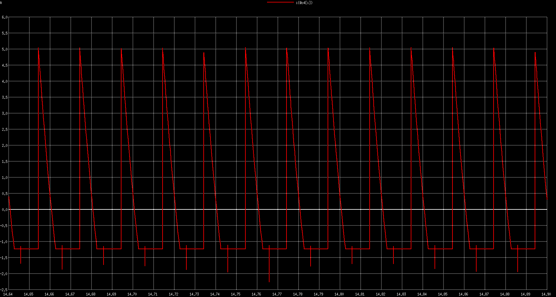

Is there a standard calculation for the ripple current requirements of an output capacitor of a SMPS, particular a boost converter in this case? It's a bit complicated since at maximum output power the ripple current is a non 50% duty cycle steep ramp with a high peak at (in this case) 50khz.
Simulation waveform attached.
The rms value of a continuous, periodic triangle or sawtooth signal based on 0 offset is Irms1=peak value / sqrt(3)=6.25A/1.73=3.608A in this case. But here you have a 0 domain, so the energy is spread to a longer period (T), so Irms2=Irms1*sqrt(T1/T)=3.608A*sqrt(8us/20us)=2.28A. But when I calculated this I introduced a DC content to push the base up to 0, so I have to subtract the power of it, therefore the final value is Irms=sqrt(Irms2^2-IrmsDC^2)=sqrt(2.28^2-1.2^2)=1.94A
The whole formula: Irms=sqrt((Ipp/1.73*sqrt(D))^2-(Inegative peak)^2)
D=T1/T (=duty cycle)
The rules I used: powers (mean square value) of different frequency signals are added,
and energy of signal slices in non-overlapping time domains are also added.
