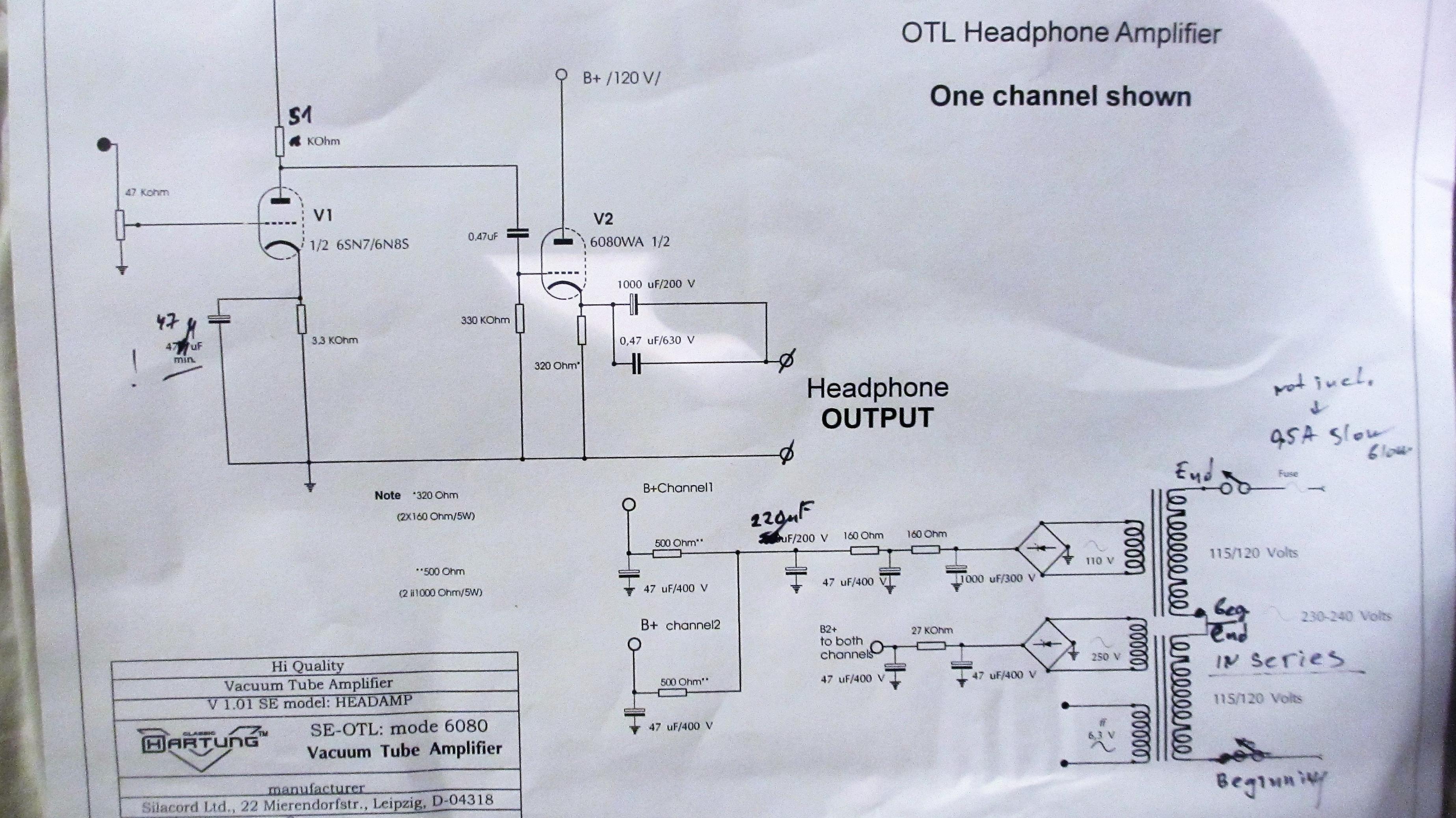

Hi all, I have built this circuit but I have a feeling that the first smoothing capacitor should be connected to neutral of the 3 pin socket and not earth like it is now, please see photo, could someone please tell me which is correct, sorry, I'm still learning and as usual thanks in advance, Ian
Ps, this is 240v, I'm sorry the photo is upside down, please rotate if need be.

Never ever connect anything from the secondary side of a transformer to N (or L).
If the design permits then connecting parts of the secondary circuitry to mains earth is permisable, and in fact this happens all the time in equipment with a grounded chassis where the chassis is tied to the zero volt line of the power supply.
So the answer NO. Never connect anything to neutral. Imagine what would happen if the equipment was connected to a wall socket of reversed polarity, something that is actually a common occurance.

Thanks again Mooly, so the wiring in the photo is correct then?, I'm like your very own stalker, I really appreciate your help and the fact that it's so swift.
Its never easy working off photos, but if the green/yellow wire connects to mains earth then it is safe up to a point (but incorrect) and you should really connect the mains earth to chassis to make the whole unit safe.
The audio circuitry doesn't actually need the connection, and in fact in some cases it can cause problems with audible hum as ground loops are created. Its also common to 'loosely' tie the power supply zero volt line to chassis via a low value resistor but there are no hard and fast rules and each case has to be looked at on merit.
The only purpose of the mains earth is safety and I would say that for safety you absolutely must connect mains earth to chassis for your particular build as shown here.

First off, it looks like that cap is attatched with hot glue😱
Thats BAD!
other than that the earth wire should ONLY ever be attached to the chassis, for safety...

That is dangerously wired as is.
The only connection to the ground lug that should EVER be made is a short wire to the chassis and nothing else! This connection must be made with a very secure bolted-on lug through the chassis. Do not share this connection with anything else if you can help it.
Once the ground wire is attached correctly, then the ground of the circuit is to be attached to the chassis as well, but at a separate location. Either directly attach a wire from the ground of your circuit to it's own bolt on the chassis, or make the connection through a suitable ground loop breaker circuit, like this-

I usually find there should be only one connection from zero volts to earth in all your equipment. Without an earth it can hum and with more than one earth it can hum too.
One other thing i see, and it has nothing to do with the original topic, is that there is no load resistor shown on the output side of the output caps.
If headphones are unplugged while the amp is on, there will be significant DC voltage at the output. At the very least you may damage your headphones. At worst you have a shock hazard.
Put a 1M resistor from the cap to ground.

Its only a low voltage output so doesn't need a resistor.
If the output was on the anode side then I would agree with you.
