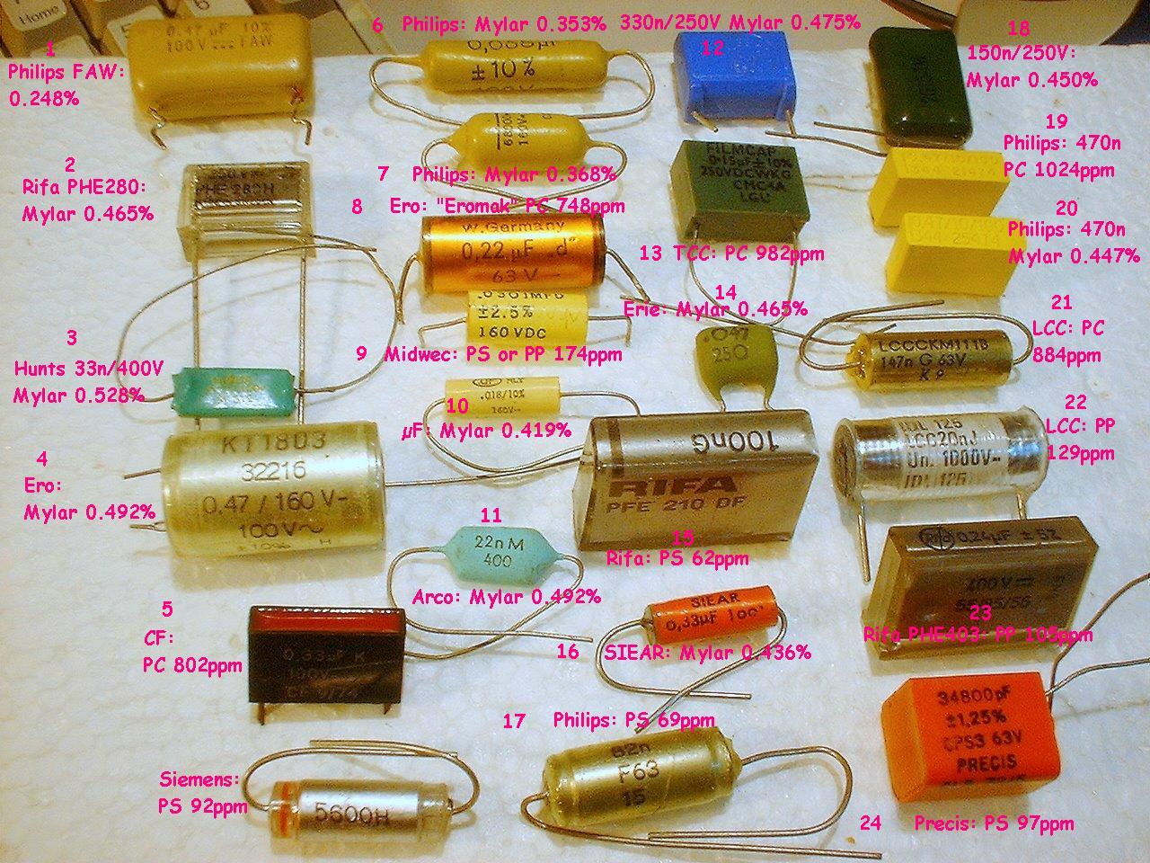

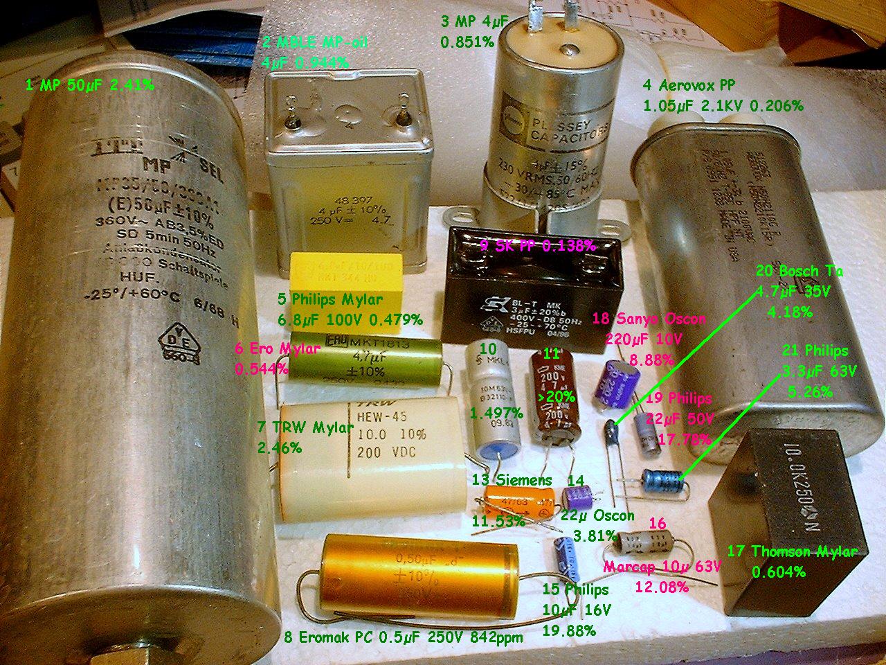

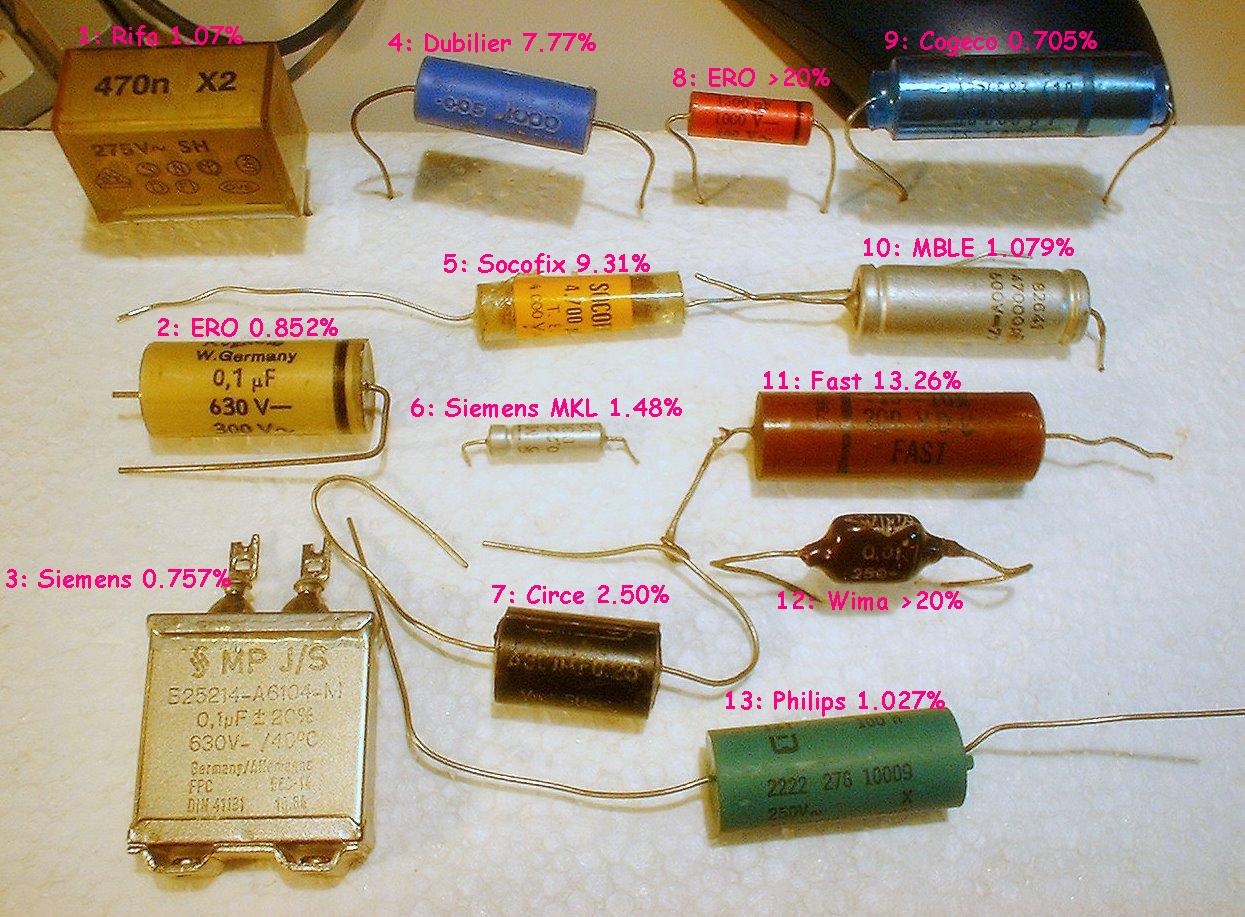

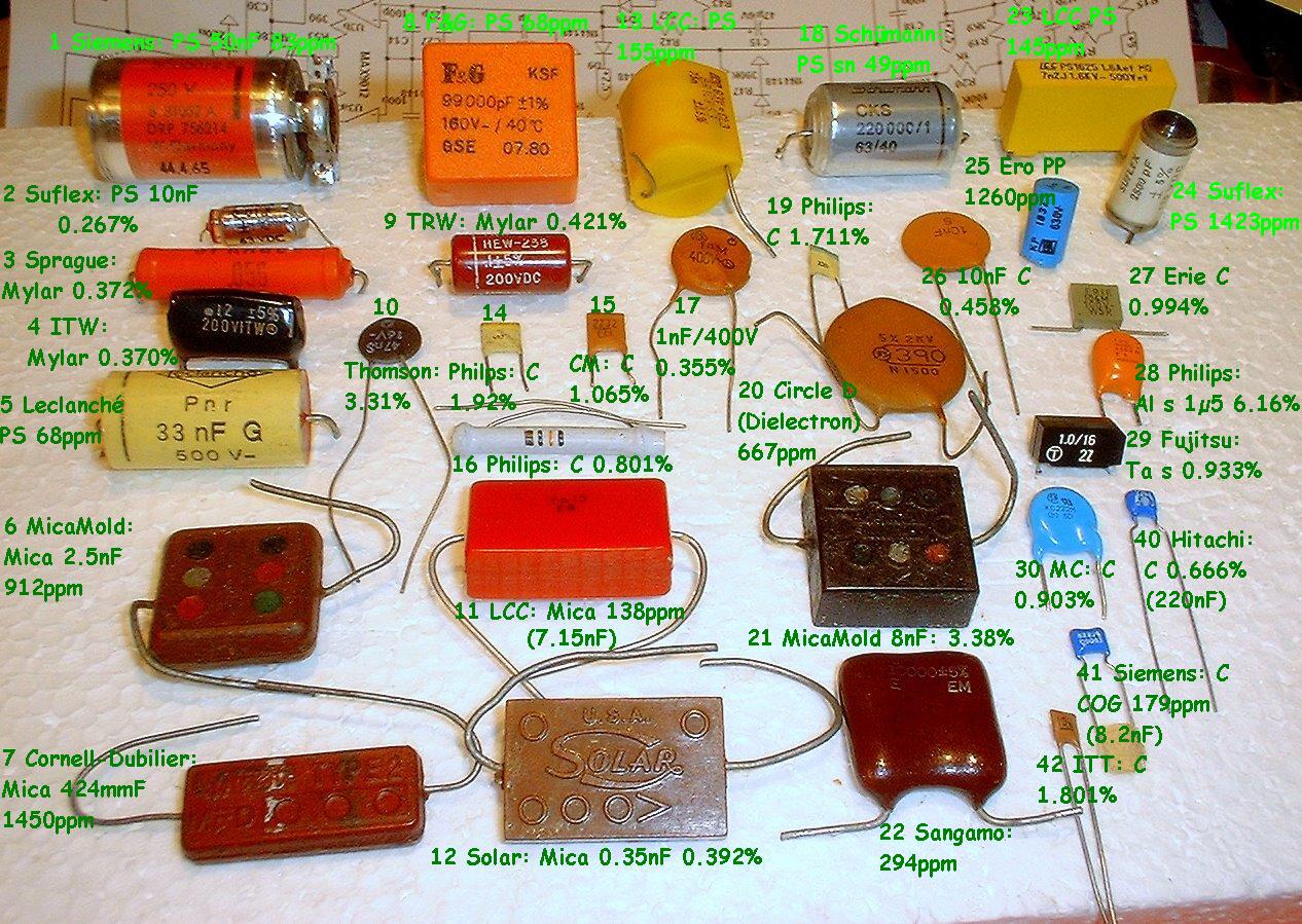

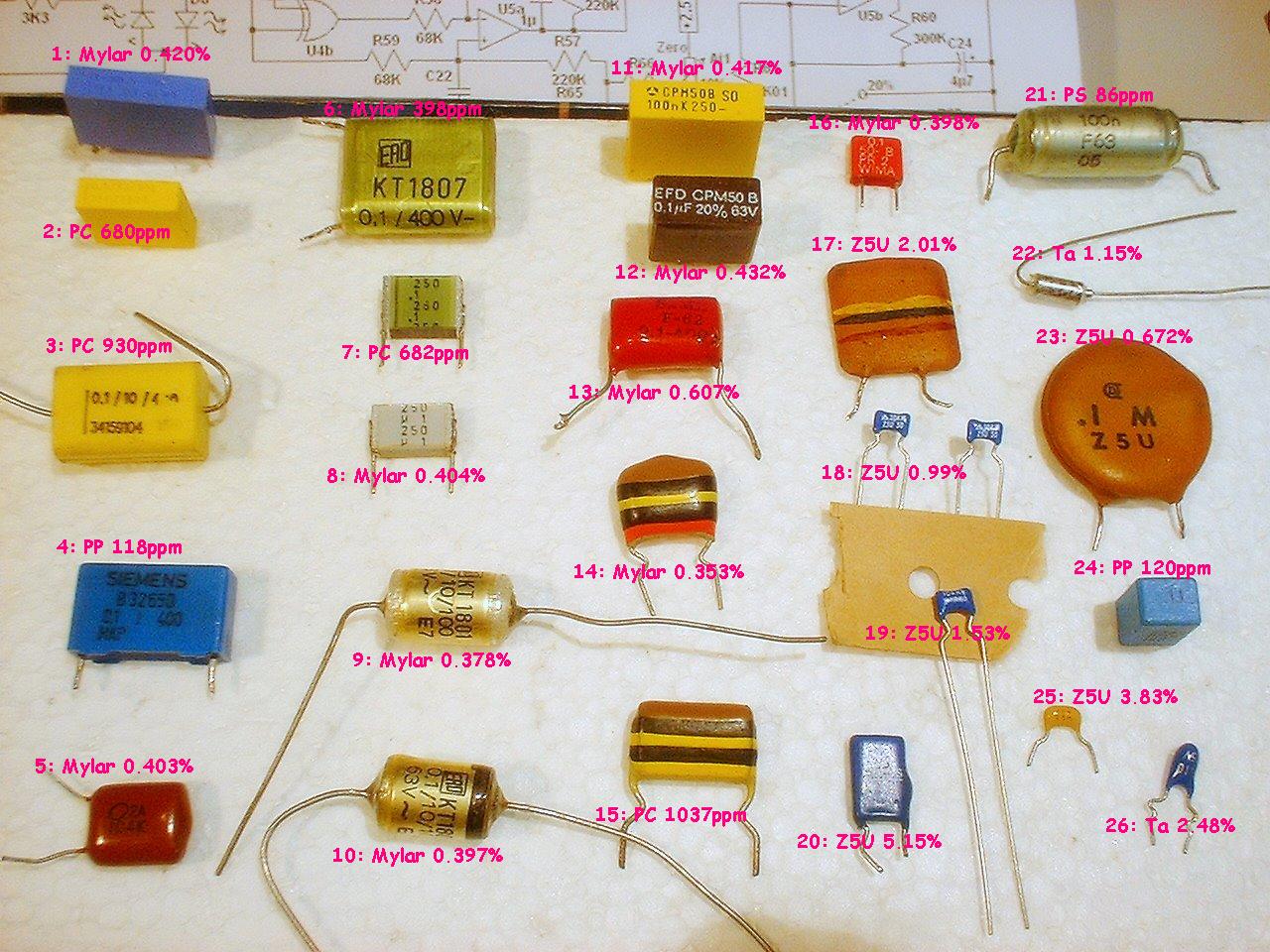

Conrad had also made some interesting measurements in this field.
Hopefully, this post will become a reference library.

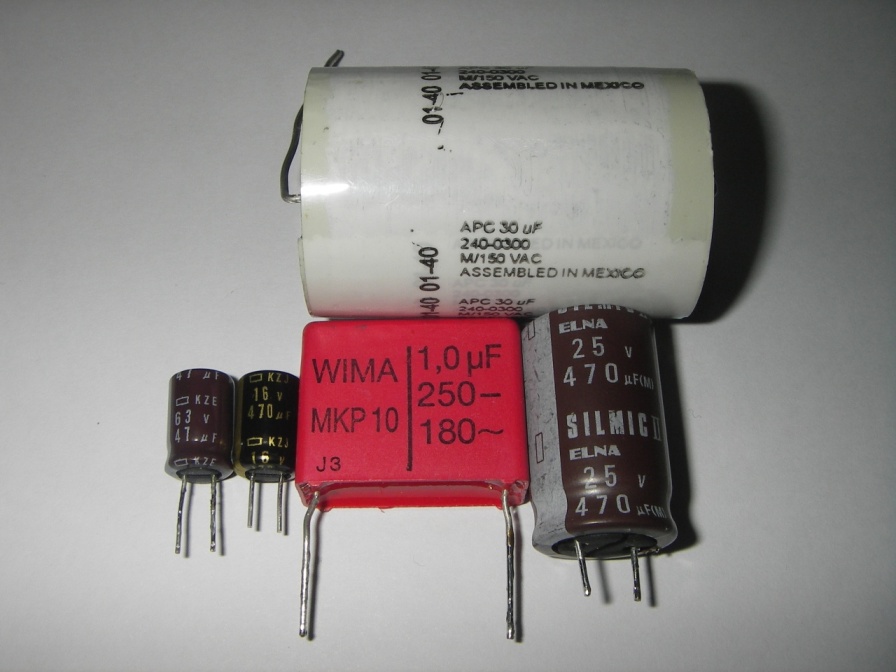

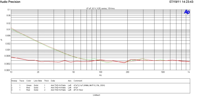

Most people parallel a film cap to an AC coupling/DC blocking e-cap. This is said to lower the impedance and to offset the adverse effect of e-cap such that sound quality is improved. Some people even replace the e-cap with a very expensive film cap of similar capacitance.
I measured the THD of a low-pass filter formed by a capacitor and a 1k metal film resistor. Driving signal amplitude is 10 Vrms. The test setup is taken from Self's small signal book.
A Nippon Chemi-Con KZE series 47 uF, 63 V is used in the first test. The non-linear effect of e-cap is shown by the increased THD in low freq. Shall we add film cap to in parallel with the e-cap. A WIMA 1 uF film cap is employed. However, it does not offer any improvement.

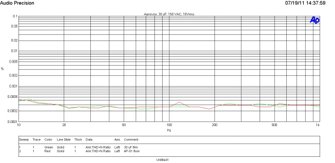

In second test, a 30 uF film cap (mostly like a polyester one) alone is tested. It is effectively distortion free. However, it has a very big axial case.

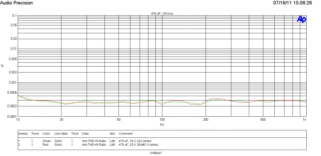

Two 470 uF caps are used in the third test. One is an inexpensive KZJ series and the other is top-end audio grade SILMIC II. Both of them are effectively identical and distortion free. The SILMIC is more than 30 times the cost of the KZJ. Is it worth?

Adding a parallel film cap will not affect LF distortion, as you have found. If it has any effect at all, it will be to modify HF impedance (for better or worse).
A capacitor will only add distortion if it has some signal voltage across it. This will depend on cap value, circuit impedance and signal frequency. For 47uF the distortion begins to rise out of the analyser floor at about 70Hz. Other things being equal, I would expect 470uF to do this around 7Hz. The analyser has a small rise around here anyway so it might not be able to test larger electrolytics.
What you have demonstrated is that electrolytics are fine, provided they have little or no signal voltage across them. This means that electrolytic caps should not determine the LF point of an amplifier, unless this is significantly below the LF limit of the input signal. Alternatively, use a normal cap early on to set the LF point.

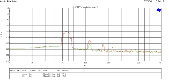

It would be helpful if you added more information on your test like which Audio Precision you used, the settings (e.g. output impedance of the AP generator, balanced/unbalanced, analyzer BW, sweep frequency steps, etc.).. If your AP has the DSP option, plot the FFT at different discrete frequencies in order to differentiate the noise from the harmonics. It doesn't make a lot of sense to limit your THD+N plots to 1kHz when the AP can go much higher. You need to be more detailed with your tests. That's what I'm trying to get at.

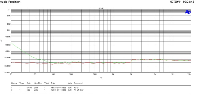

The AP is System One Dual Domain. You can visit AP High Performance Audio Analyzer & Audio Test Instruments : Downloads to download its full spec. In my test, the output impedance is 50 Ohms. Balanced connection is used. The upper audio bandwidth for THD sweep is set to 22 kHz. For the e-cap THD sweep, we can go to 20 kHz and beyond. However, the e-cap is effectively short circuit, distortionless when freq is above 500 Hz as shown in the figure below.
FFT (Avg = 16) for 57 Hz is shown in the next figure. The 47 uF DUT generates measurable second and third harmonics.

Thanks for the link but I'm quite familiar with the AP System. I've used several versions before for years.
AP's strength is on its FFT and multitone feature. Learn how to use it instead of the same old single tone and THD+N routine.
