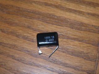

I have the older Adcom GFA 545 amp and need help with replacing a capacitor. The cap is located on the bottem of the two circuit boards, there in not anything else located there. This cap is fairly large in size, it's black and flat, has radial leads, the only numbers are 100v/1k 6502.
It sounds like 1000uF/100V to me, but sometimes the k stands for the tolerance (10%), in which case it could be 1uF/100V, with the 6502 being the batch code. Can you provide the physical size, as that will give a clue. Also is it polarised (any markings of + or - on either end), or any branding?

This isn't the input coupling capacitor is it? Why do you need to change it?
Your missing picture (probably to large) would help answer this question. I have repaired a number of these amplifiers but I am working off memory here.

could the T be short for MKT = terephthalate = metalised film.
As said "k" could be tolerance
Size seems a bit big for 1uF unless 6502 means polypropylene, but that should be even bigger than those dimensions.
As Anatech asked, "why change it"?
I was told this could be the reason I getting a strange noise when I power the amp off. I changed two caps on the board and it improved a great deal, but I still have a slight noise.

No, those are pretty good input capacitors. I think the advice you were given is faulty.
