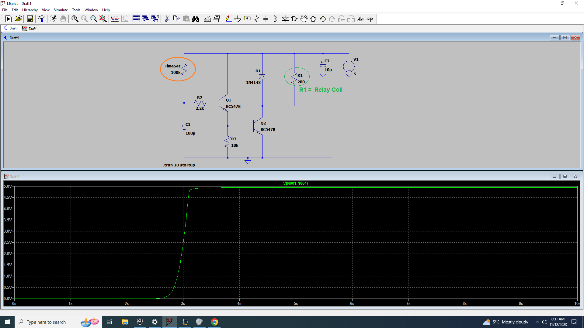

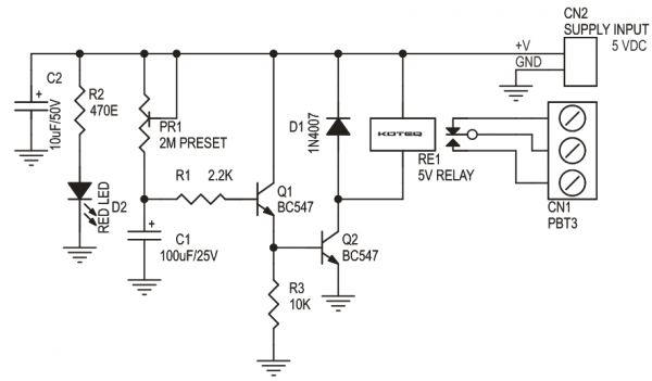

You can use a relay to switch on the output.
Turn on delay relay circuit.
Reactions: rayma
