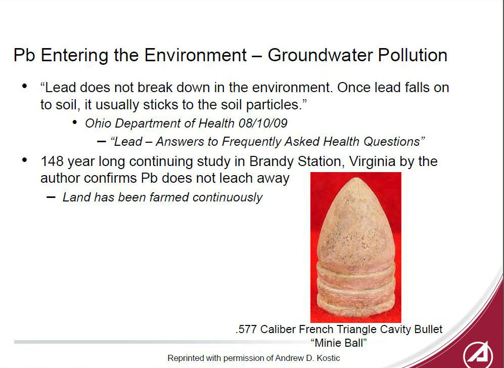

Tin whiskers and other facts about lead free solder.
http://nepp.nasa.gov/WHISKER/reference/tech_papers/2011-kostic-Pb-free.pdf
Summary quote.
"No mitigation technique other than the addition of at least 3% Pb by weight to Sn has proven itself to be totally adequate in the field
–Multiple research efforts to develop effective mitigation for tin whiskers"
Another excerpt.
Lead leaching into ground water.
Summary quote.
Another excerpt.

If an acid is present or the soil acidity is very high, lead may disolve into water. Otherwise if it stays in the metalic form it is not very harmful to the environment. However, I suspect that a landfill, filled with decomposition, might allow the disolution of lead. I am not a fan of throwing lead soldered PCB's into the dumpster bin. Any junk PCB's I have laying around that have lots of solder on them usually gets the solder 'recycled' in one of my vero-board projects.🙂 There is a recycle center not far from home that takes the PCB's and electronic garbage....of course after I have scavanged all the components I think might get recycled.😀
