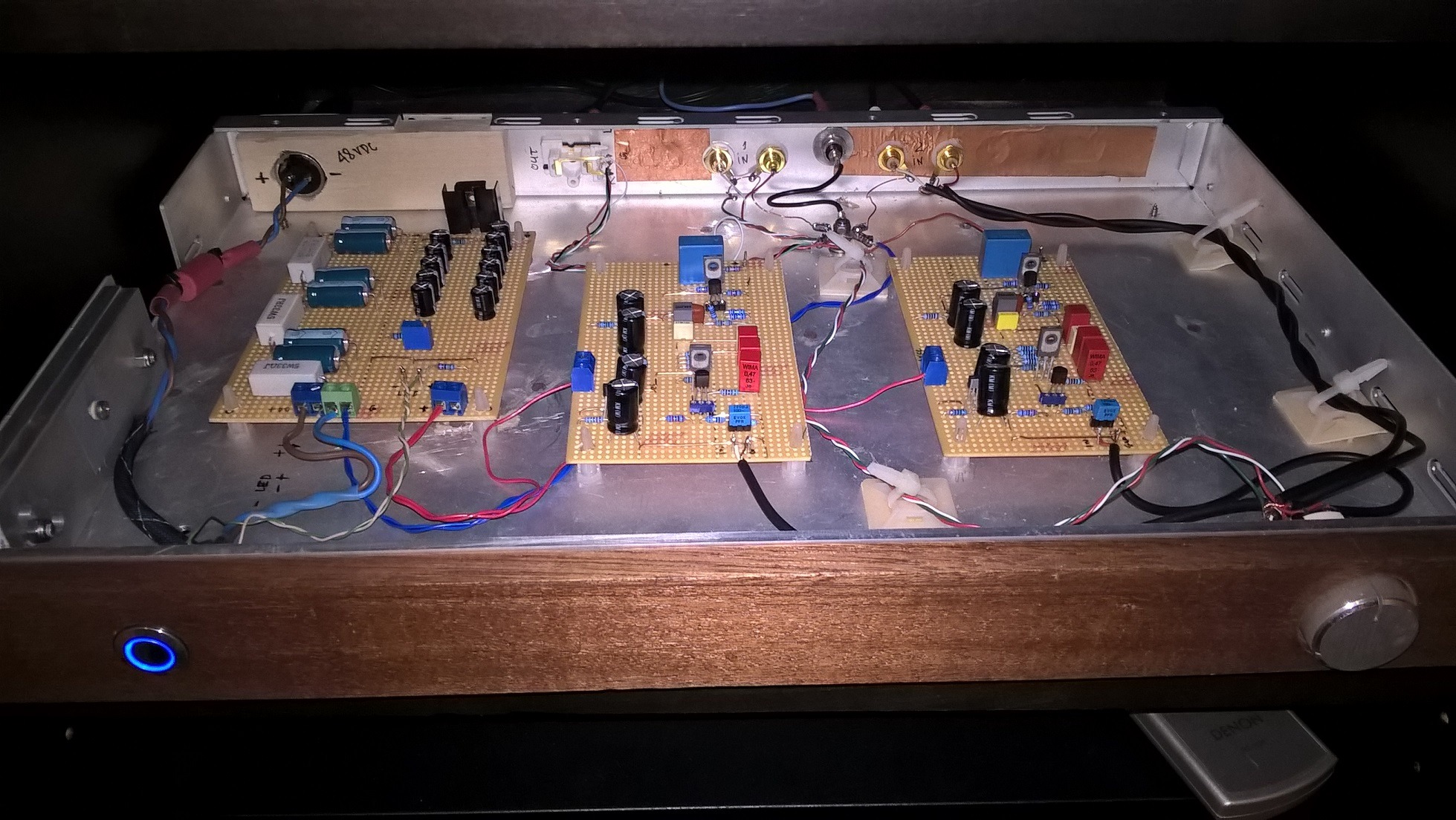

I use CapMx circuits for all my builds, no matter if its linear or SMPS, for solid state and tube projects.
Below you can see the one I use for a Pearl I RIAA pre with a 48VDC SMPS as its input. Works like magic with no noise or hum whatsoever, even when you listen with headphones.
What's not shown is the RCRC filter after the SMPS, preceding this circuit to drop the input to 39VDC.
All fits on a 10cm x 10cm veroboard.

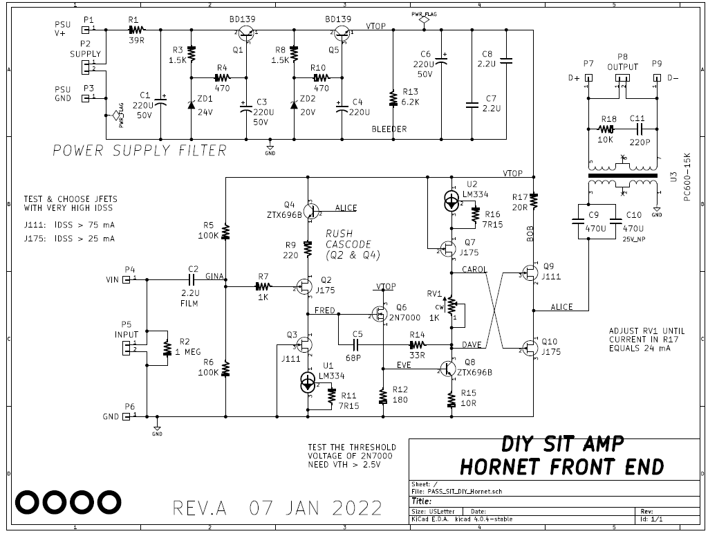

Add the optional components R3 and ZD1, then presto! You get a voltage regulating cap multiplier. As we see below, these can be cascaded for additional filtering. Filtration. Fee Fie Fo Filterization.
