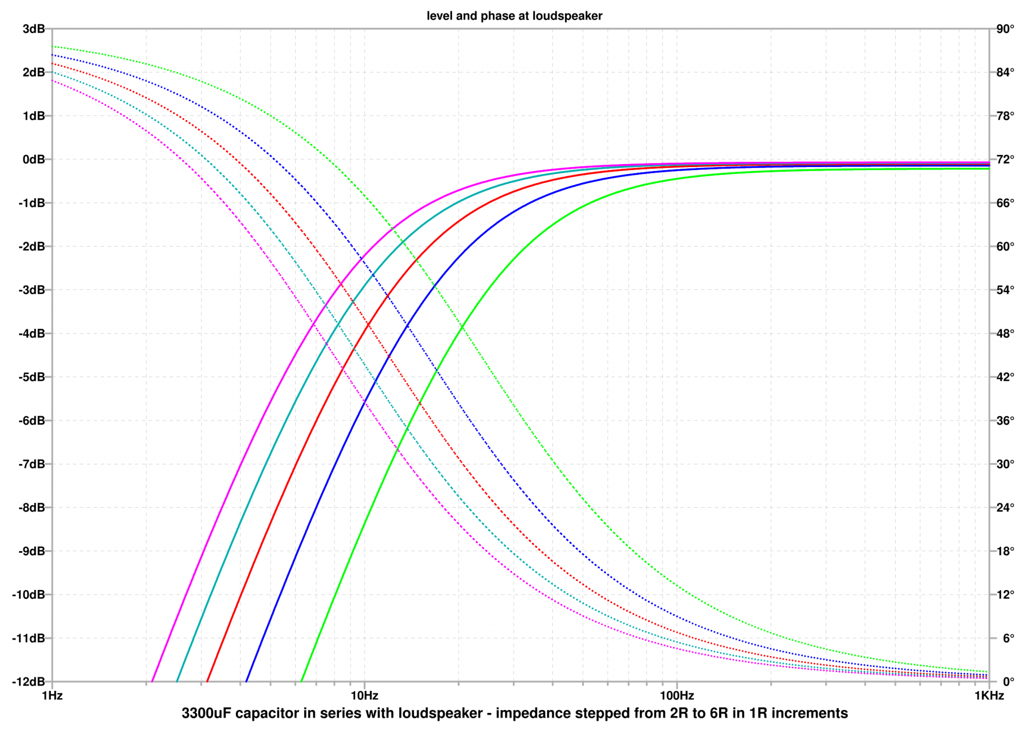

According to some basic simulation in LT Spice, ~3300uF in series with the bass drivers could do the job.

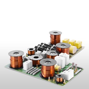

Looking at a (unfortunately low resolution) photo of the crossover, I can see an array of six capacitors on one of the PCBs.
Could be that those are for the DC feature?
Does anybody know something about the Canton implementation (since I'm only guessing)?

The main benefit of a passive speaker level high pass would be a fool proof protection of the bass speaker regardless of any filters in the signal chain. Furthermore, the loudspeaker would survive an amplifier failure putting direct current at the speaker.
With a passive first order high pass filter at loudspeaker level, the trade off would be between rather low attenuation of the unwanted infra-sonic frequencies or unwanted attenuation of the lower bass region. Canton apparently found this a worthwhile addition to their more expensive speakers nonetheless.
My initial plan was to buy Canton Reference speakers, but they were out of stock so I got pretty similar ones (Vento 90) without the high pass (Displacement Control) feature.
The most appealing aspect of the high pass filter at loudspeaker level for me is immunity against amplifier failure. I build my own amplifiers (usually you find me in the solid state forum) and of course I also implement direct current protection, but in case both the amplifier and the direct current protection fail, my super expensive speakers would be toast.
I seriously consider the addition of a series capacitor as HPF as belt and braces approach to protect my speakers and like to make sure this does not have unforeseen side effects.
I don't know much about the Canton Vento 90 other than the cross-over to the mid-bass is around 200Hz.
From other (probably similar) Canton speakers impedance curve, I would guess that the impedance below port resonance could be around 3 Ohm maybe.
Thus with 3300uF as HPF, cross-over would be at 16Hz roughly.
At 200Hz, where the transition to the mid bass driver happens, there is still significant phase shift so probably I should put the capacitor in series with the whole speaker instead of just the bass drivers in order to avoid phase anomalies around the crossover frequency?
Does this make any sense to you?
