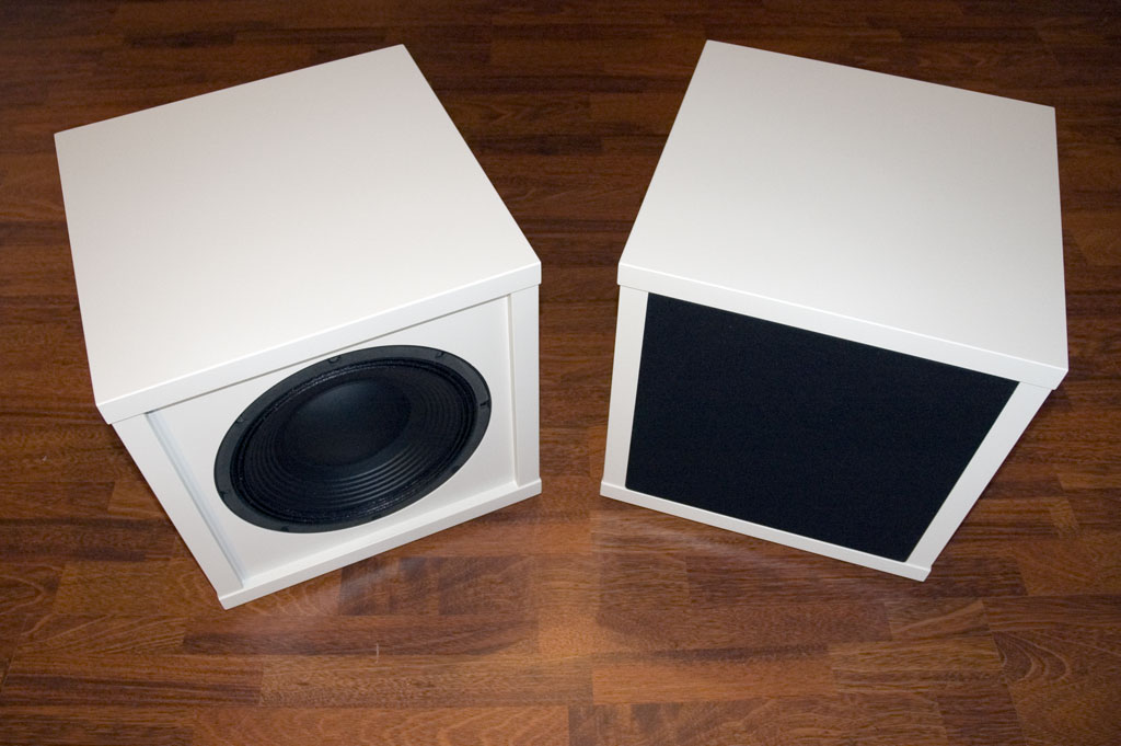

I made a pair that was very good with two Beyma 12P1000nd woofers in a 35 liter cube. I put one driver on each side. DCX2496 for XO and EQ, and 2x250W class-D power. Works very well.

There are many ways to achieve extended low frequency, the approach you (and Bag End) employ is one of them.If you want to build a true ELF, you must put the system resonance above your XO frequency. That means drivers with high Fs and very small boxes, which again means you need lots of power and drivers than can handle it.
High Fs drivers typically don’t have much Xmax, so have much less LF output potential than similar size boxes using low FS, high Xmax drivers.

Its possible to find, but they might not be cheap. The Beyma drivers I used has got 16 mm p-p Xmax, which is fairly ok I think.
