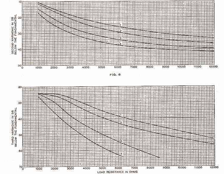

300B distortion vs load and current from WE datasheet.
All curves at 350V anode, with grid bias:
1: 30ma
2: 40ma
3: 60ma
4: 80ma

Authors usually mean second order harmonic cancellation in the articles I've read. If I'm right, under ideal conditions even orders cancel and odds add. My sense is the best that can be achieved in the real world is a driver with sufficient 2nd harmonic content to cause cancellation with the output but with few to no harmonics from 3rd and up. I've played with the technique using a 6CN7 front end driving a beam triode cathode follower into a transmitter tube and was able to get 0.6% at 13 watts SE without feedback. However 3rd harmonic comes up fast at higher powers.

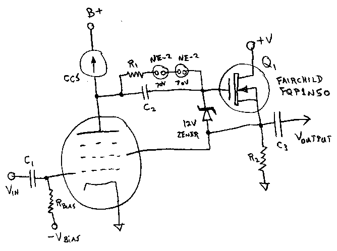

Yet another approach for keeping a constant current thru the tube, with a load attached (attached picture) (needs a 20K resistor or so across the zener - not shown, the Mosfet could be a cathode follower too)
I now view pentodes as triodes with separated output and feedback terminals.
Taking your complementary current source approach further, one can also servo the current source side so as to totally minimize current drawn from the voltage amplifier by the load (will need a P-P voltage amp and P-P current source then). Just put a current sense resistor in the load return lead to the voltage amp pwr supplies, and use the signal to drive the current source so as to zero it. The P-P current source uses separate power supplies so as not draw current thru the sense resistor.
On the "proprietary" linearizer, I am having too much fun right now nulling out distortion from tubes on the analyzer. But I will give you a hint:
I call it 3D bias. It takes the place of the grid bias resistor (for fixed bias case), has two terminals, and 3 adjustments, and uses pre-distortion. Parts count consists of 3 pots, 1 big cap, one low Cinput Mosfet or tube. Think of matching one similar power law curve to another. 3 adjustments are necessary:
1 operating point alignment, 2 operating span match on the curves, and 3 magnitude of correction effect. You have 24 hours to figure out the schematic before this post self destructs!
Don 😀
