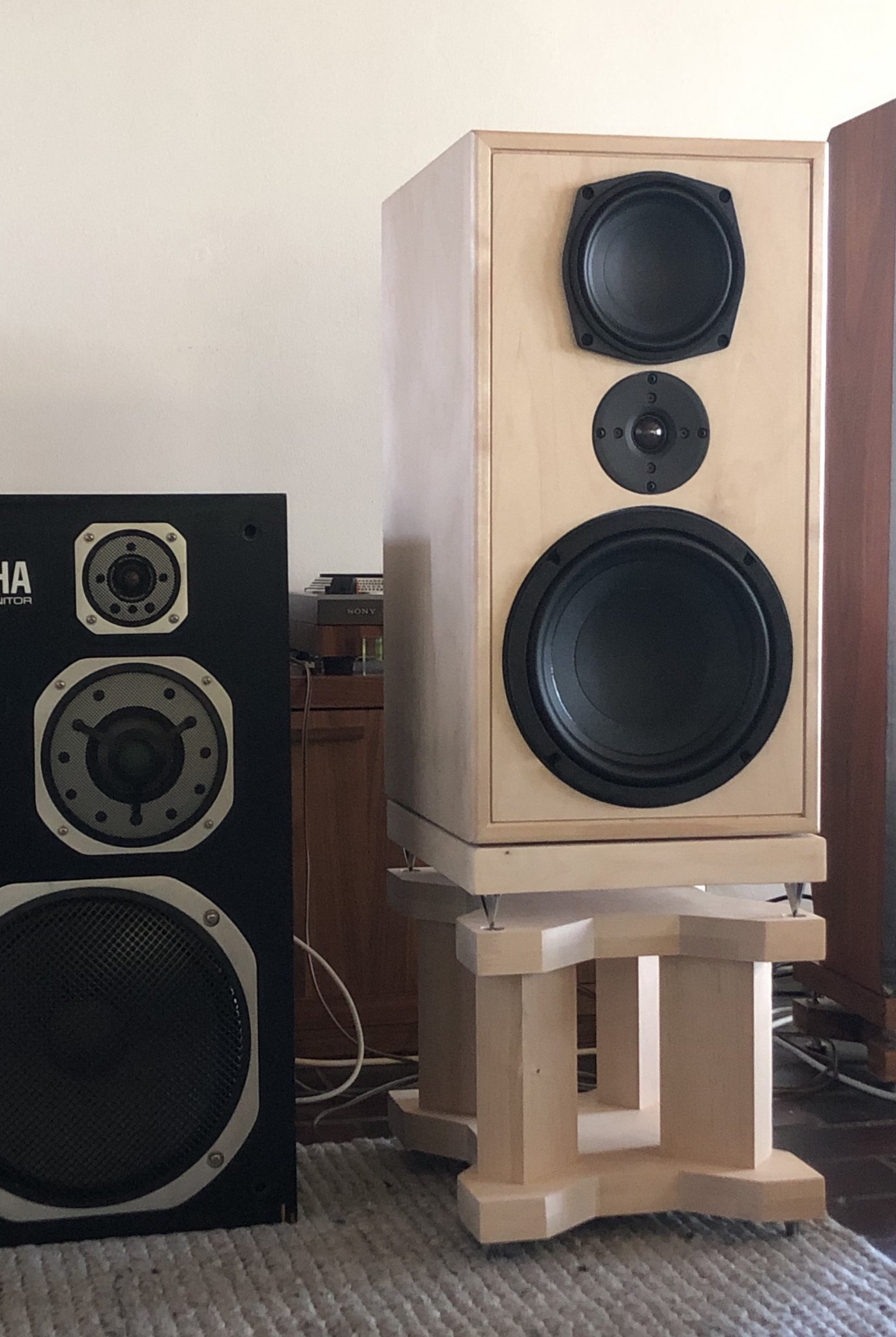

I am building 3 way classic speaker, TMW confiquration size about same as yamaha ns 1000.
My brother owns restored ns1000 and i really like the voices and midrange, though a bit sharp for my taste why i am going for more smoother elements.

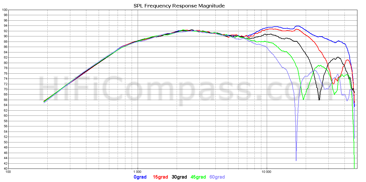

I would not assume the sound of something has anything to do with how it feels to the touch. When I've done direct comparisons within a model where only the diaphragm was different, I came to much different conclusions. I tested the Vifa NE19VTT (titanium), VTC (anodized Al), and VTS (fabric), and the VTT is the smoothest and best behaved, followed closely by the VTC. The VTS was just a bit to sizzly and splashy. Same story with the RS28A vs RS28F. RS28A is very calm and well behaved. RS28F is just a bit too lively, more special effect that faithful reproduction when compared directly with the RS28A. That particular comparison has been done by many diyers over the years and my impression is in line with what others have heard for the RS28.
Where do you plan to crossover? Is the dome directional there? Is there a waveguide available that would match that directivity?
EDIT: looking at that plot of the M74S, I'm not sure you would want a waveguide, it's still radiating widely at likely crossover frequencies.

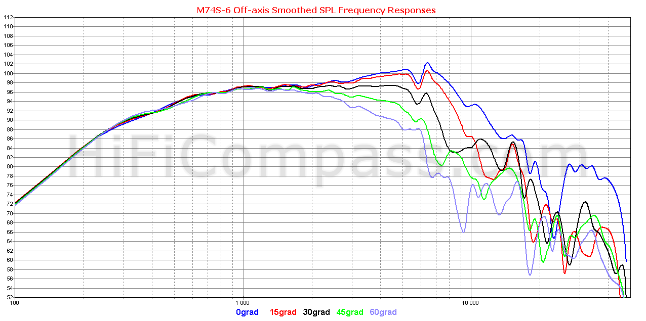

The main purpose of a waveguide is to restricts the tweeters dispersion to say 120 degrees, such that it matches the dispersion of a cone midrange driver at the crossover frequency.
A dome midrange has 180 degrees dispersion at the crossover frequency. To make the tweeter match it, its waveguide should be 180 degrees. That means no waveguide at all on the tweeter.

That would make sense, I've never seen a 3" dome have that sort of wide dispersion.I think you are showing the wrong graph in post #2. I believe you are showing the graph for the T25S, rather than the M74S.
Sorry you are right, i got confused since both are saved on same folder, here is the correct one:

Speaker is already built, it is actually troels faital-3wc-10:
There is a wg ready for either tweeter: t25s (3dprinted) and for tw29txn-b (jantzen wg)
There are no wavequides for middome m74s.
Right now baffle is straight, not tilted.
