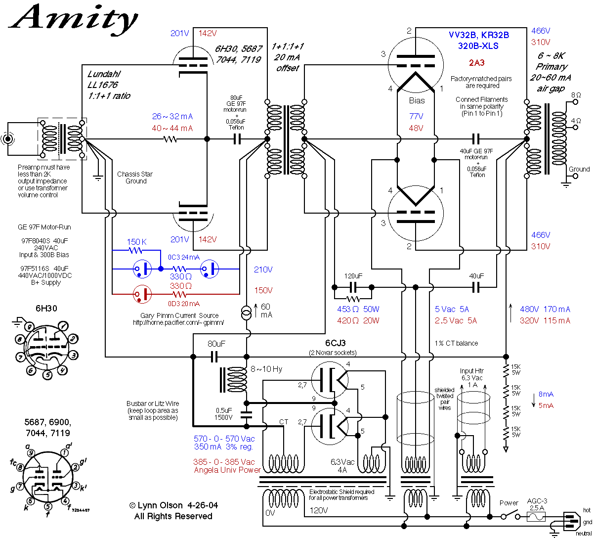

The Amity amplifier has the 2A3 filaments in parallel.... pin 1 to pin 1 and pin 4 to pin 4. The fact that it's a push-pull circuit provides some phase cancellation. However, this might not matter as most later 2A3 tubes are actually dual filaments and grids within a single, albeit separate plate structure. In single-ended circuits, you need to balance out the hum, or use a DC filament supply. I've actually found the older (original) single plate 2A3 triodes to be quite difficult to null out the hum using AC on the filament. In any case, depending on the pair of DHTs you have, some pairs will work out better than others.

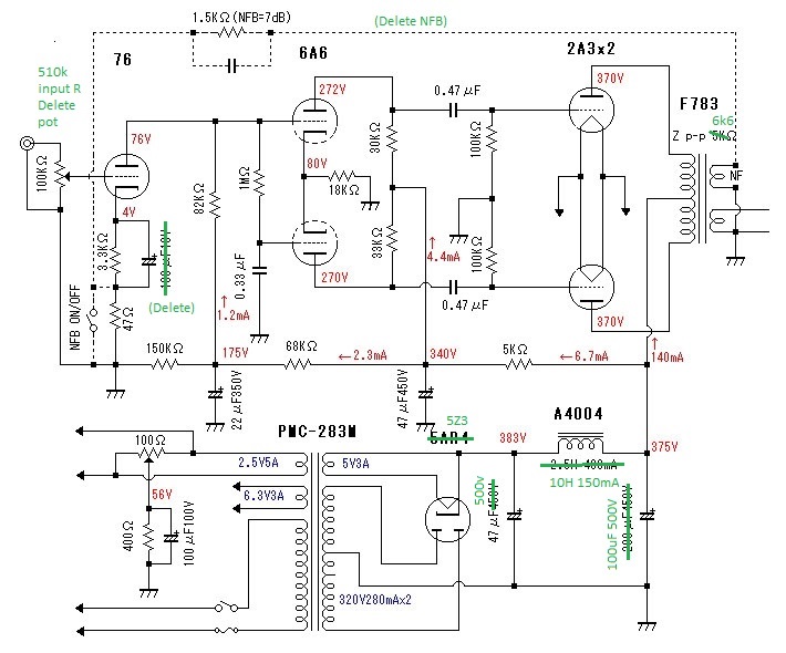

Below is a really nice, simple PP 2A3/6B4G amp that is good for about 10 watts. Ignore the green modifications, they aren't necessary, and the amp is fine without them. I have built this and it's lovely. In place of the 76 and 6A6, I used 6P5 and 6N7, which are the same tubes with octal bases. Both are easily available. You can also use 6B4Gs. Your Eico power tranny should work fine for this in stereo. Just add an extra 6.3 volt tranny for the second channel 6B4Gs or two 2.5 volt trannies for 2A3s.
The only change I might make is to increase the 400 ohm cathode resistor to 700 ohms to reduce the idle current and push the amp more into AB territory. Your Eico power tranny might be happier with this. But you can try it both ways.

That looks like a Japanese schematic?
Any harm in using the amp without the green changes? I might keep the 5Z4 sub and a choke of at least 5H, along with the 6.6K tranny. Maybe sub a 6J5 I have on hand for the 76 / 6P5?
Yes, it is a Japanese design. Personally, I would keep the 5AR4 for the slow warm-up time, especially since the input stage and driver are direct-coupled. A 6J5 would work fine, but you might want to skip the cathode-bypass cap since the gain is a little higher or include it and add the feedback. Watch the plate voltage, again because of the direct-coupling. You will probably need to reduce the cathode resistor to around 2500 ohms. 6.6K OPT would work, as would a 5H choke. You can also experiment with the feedback--leave it out or include it. If you decide to use it make sure the primary leads to the output tubes are wired in the correct phase. The amp will tell you if they are not. ;-) It will howl with displeasure, literally. ;-)
