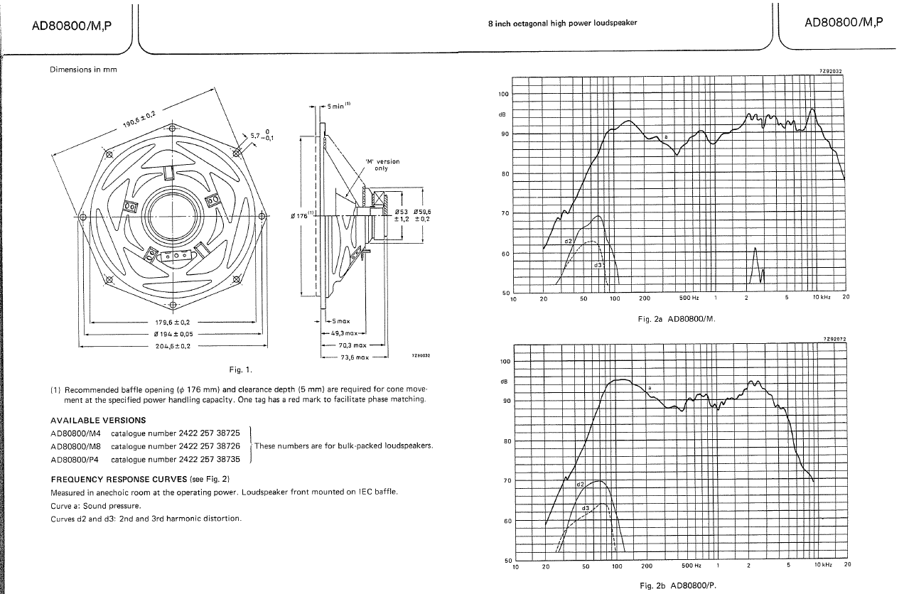

They are 8 inches in size and most likely be a Philips because the box has a badge on the back. I can't find a way to safely remove them and check the back of the speakers to read the letters.
Is anyone familiar with these?
I am trying to get them sound somewhat acceptable, so far i have failed with all my amplifiers.

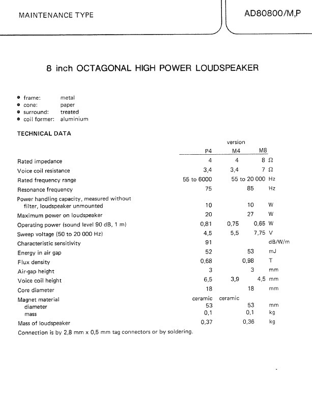

If you mean the driver, it's the Philips AD80800/M8, an 8" fullrange driver from the 1970's. I got some specs on them but as this is an old driver, don't trust them too much as the aging often changes them...
Thanks a lot for the help! I already found out that bit of information after going through google. But thanks again and again for this 🙂

Thanks lot for these information images as well! 🙂
