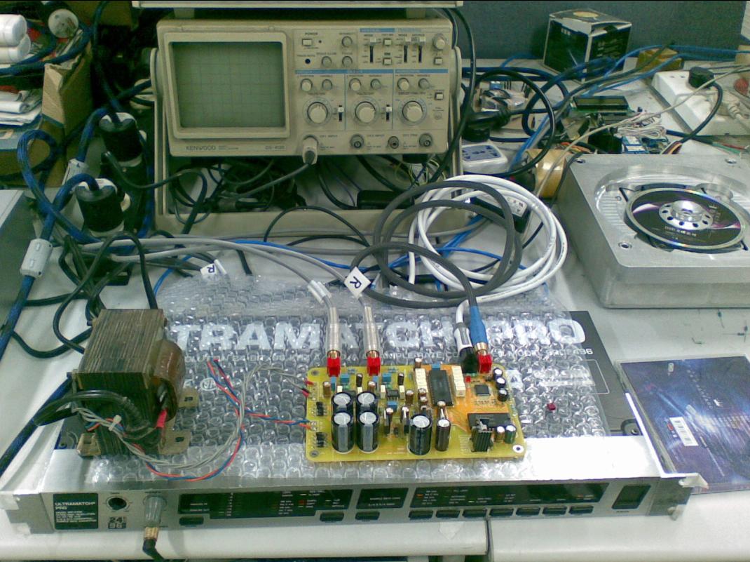

I test my TDA1541 OS DAC KIT http://www.diyaudio.com/forums/swap-meet/152913-fs-tda1541-os-dac-kits.html with my RMAA system based on E-MU 0404.
But I got some question after the testment 😡
It seems that there's no differences with the two method 😕
COAXIAL must be better than the TOSLINK in theory, for TOSLINK must not leave electrical-light-fibre-light-electrical conversion.
If the differences can not be test ? or the diifferences are too smallllllll to measure by RMAA test
Can you hear the differences ?
Test COAXIAL/24BIT ,,,,16 BIT,,,,TOSLINK/24BIT,,,,16BIT
Frequency response (from 40 Hz to 15 kHz), dB: +0.02, -0.13 +0.02, -0.13 +0.02, -0.13 +0.02, -0.13
Noise level, dB (A): -101.3 -101.1 -101.0 -101.1
Dynamic range, dB (A): 98.8 98.3 98.3 98.3
THD, %: 0.0022 0.0022 0.0021 0.0022
IMD + Noise, %: 0.0048 0.0047 0.0047 0.0047
Stereo crosstalk, dB: -99.4 -98.9 -98.5 -99.5
