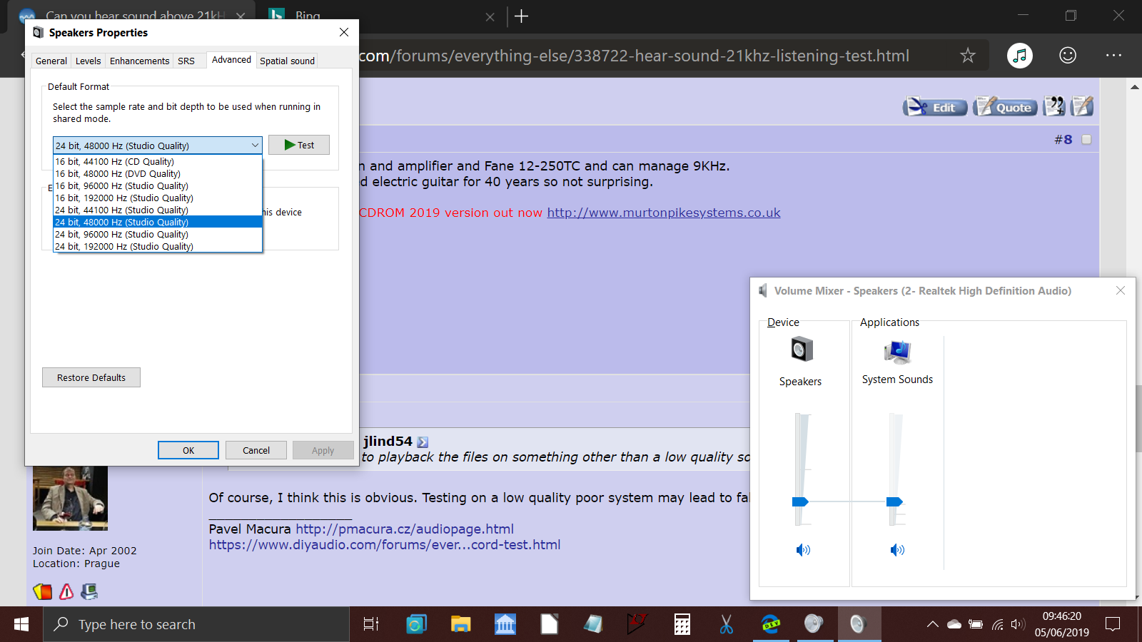

This is the problem I seem to hit with these tests (soundcard quality). The only options I have are these (default setting shown).
For what its worth I had three ABX attempts and got between 14.5% and 35% or so and yet I felt one file had a more fatiguing sound than the other at HF. As so often happens, that couldn't be translated to a positive ABX result.
