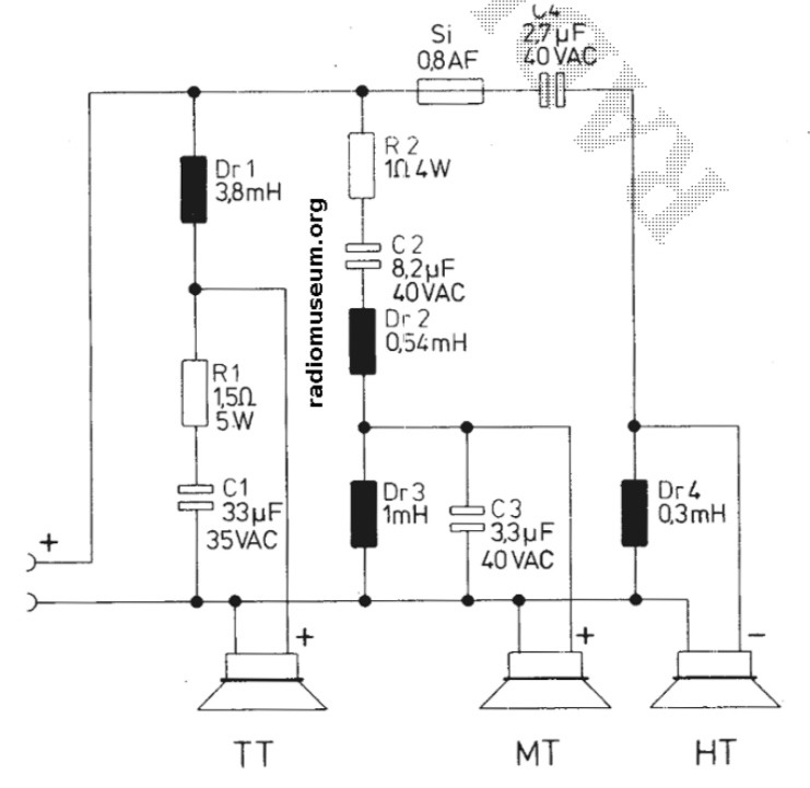

Can we find impedances of each driver from crossover values?
Can we find approximate impedances, i.e., 4, 6, 8 Ohms, of the drivers from crossover values?
If so, attached is the example of crossovers with unknown drivers’ impedances. Could anyone please help to find them?
TT (woofer) = …. Ohms
MT (midrange) = …. Ohms
HT (tweeter) = …. Ohms
In fact, I’ve tried simulations with various values of impedance on each driver, and found so many possible combinations. They made me more confused. So, please help me to get it.

Do you expect us to be able to do it without knowing responses before and after crossing? In other words to work out the filter transfer functions? Even if you did, it would typically be preferable to measure impedance in the normal way.

Second-order filter frequency ~ 5khz/sqrt(mH*uF) independent of driver impedance. So a quick glance gives LPF 450hz and HPF 5500hz. Impedance affects the precise shape of the response curve not its (2nd-order filter) crossover frequency. See the other thread about "lessons for novice".

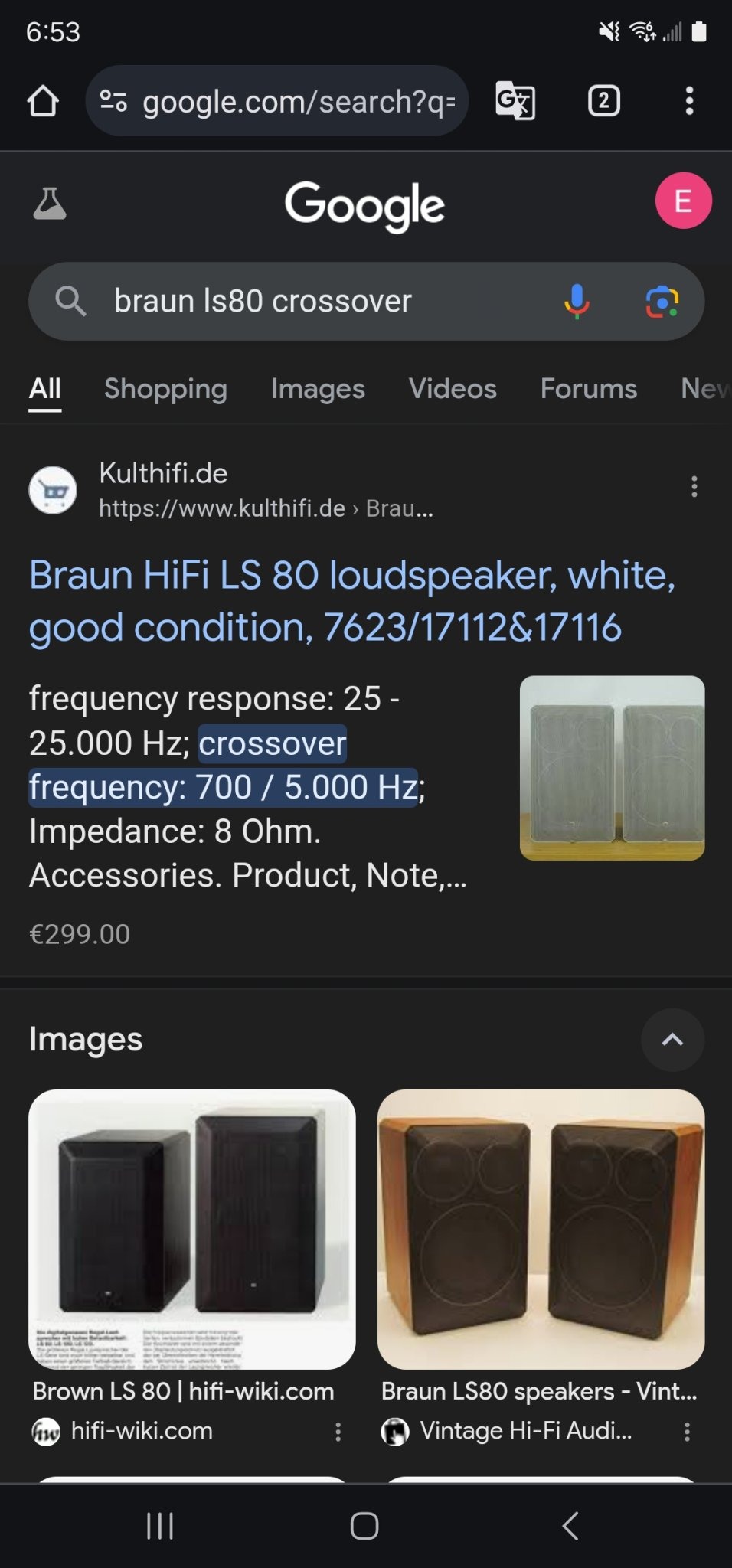

@wchang close, it is 700 and 5000.

All you need to do is google it.

Are those ADS drive units identical to the ones in the Braun LS80? Or if not, do they have identical complex (frequency varying) impedances, and identical frequency / phase responses when mounted on an identical baffle design to the Braun LS80? If not, the crossover network you say you have obtained is totally worthless except a/ in current form potentially stopping the HF driver burning out, and b/ as a very limited source of parts for future projects that might happen to require the component types and values. You've been told in various ways about drive units having different frequency, phase & impedance responses (which themselves vary depending on the box / baffle they are on) over the many threads you've started, but you don't seem to have listened. So, repeating some of the above (and from elsewhere):
  • Loudspeaker drive units are not resistors: nominal impedance values are just an approximate guide, mainly for basic amplifier matching, and the actual impedance varies significantly with frequency. Different drive units have different impedance characteristics, even if they are lumped into the same nominal value
  • Loudspeaker drive units do not have a perfectly flat frequency response from 0Hz to infinitely high. They all vary with design, and in most half-decent cases upward, the actual frequency response of the drive units (which as noted also varies from the IB curve when mounted on a real-world baffle in non-coincident positions) is taken into account when designing the crossover.
  • The notional electrical transfer function alone is worthless, even if you account for the real frequency-varying impedance load rather than some flat resistive nominal, because the frequency & phase responses themselves need to be factored in. It's a combination of the electrical and acoustical transfer functions that we need to work with.

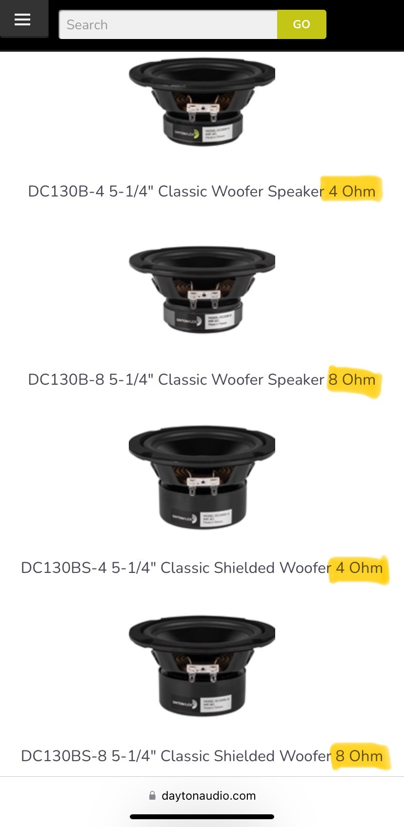

How do you tell the seller about the spec when buying the tweeters at the shop, please? Don't you tell him you need 4 Ohms tweeters or you show the seller the desired impedance graph printed from your home?

The nominal resistance or impedance of a speaker is defined in some norm. It gives you an idea what load it will be for an amp.
If I build a 2-way speaker, tweeter-woofer, I take 4 Ohm chassis. If two woofer are used, like in a M-T-M I pick the 8 Ohm version for having 4 Ohm nominal, after using them in parallel. There are even 2 Ohm and 16 Ohm speaker because of this.
It has nothing to do with crossover building.
If you have chassis without a clean data sheet, measure them yourself or just don't use them. In case of the 40 year old BRAUN chassis, leaving them to the museum would be a good idea, right with the crossover you got.

Well, I will describe again for what I want to do.
I have ADS L780/2’s drivers; woofers, midranges, and tweeters. Basically, all of them are measured 4 Ohms resistance (Re).
Then, I got the crossover networks of Braun LS80 speakers. I’d like to use them with the ADS’s drivers. But, the problem is I don’t know how much impedance the crossovers were designed to be used with each driver. Or, in other words, I don’t know the impedances of each driver in the Braun LS80.
If all drivers of the LS80 are rated 4 Ohms, same as those of the L780/2, I will mate the crossovers and drivers directly/without any modifications (I could accept the errors as I reckon the drivers and enclosures aren’t already identical between those two speakers).
However, if the drivers of the LS80 aren’t rated 4 Ohms for all units; for example, the woofers are rated at 6 Ohms, etc. Modifications on the crossovers will have been required. That’s all.
