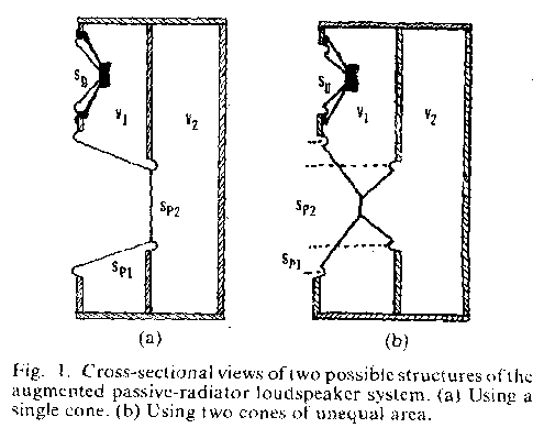

There is a possible solution. This is the Augmented Passive Radiator enclosure invented by Thomas Clarke in the 1970's. Been meaning to build one for some time, haven't gotten around to it. He write two articles, complete with index, equations, etc for the Journal Of The Audio Engineering Society in the seventies.
Here are some posts on the Augmented Passive Radiator System:http://www.diyaudio.com/forums/showthread.php?postid=82564#post82564
Although the illustration would seem to show diffuculty in using this for a bass cabinet, I believe it can be constructed. The Large external PR would be on the back of the enclosure.
This is supposed to match most any speaker to any size box with a 3 dB advantage. The 3 dB advantage can take the form of ¼ octave lower F3 or the same F3 as a ported box of similar size but with a 12 dB instead of a 24 dB rolloff.

Thanks for the update on the bass situation. Still, considering that most 3 Ft³ cabs have an F3 of 60 Hz, (albeit with a lower Fb), I still think that a cab with an F3 of 42 Hz or so is a step in the right direction. 30 Hz F3 in a cab of 97 dB@1W/1M would appear to be out of reach with an unequalized 3 Ft³ cab, at least for now.
Grey:
Are you saying the simulations are not correct-yes, I know the room throws everything off anyway-or that there is more to this than looking up the free air resonance of the driver, sticking it in any size box and expecting response down to the Fs?
All I am asking is that if we simulate a speaker/box combo and it shows the F3 at a certain frequency, do we have a fighting chance of it actually going down and acheiving that F3 in a real world situation, understanding the enormous variations room-to-room?
