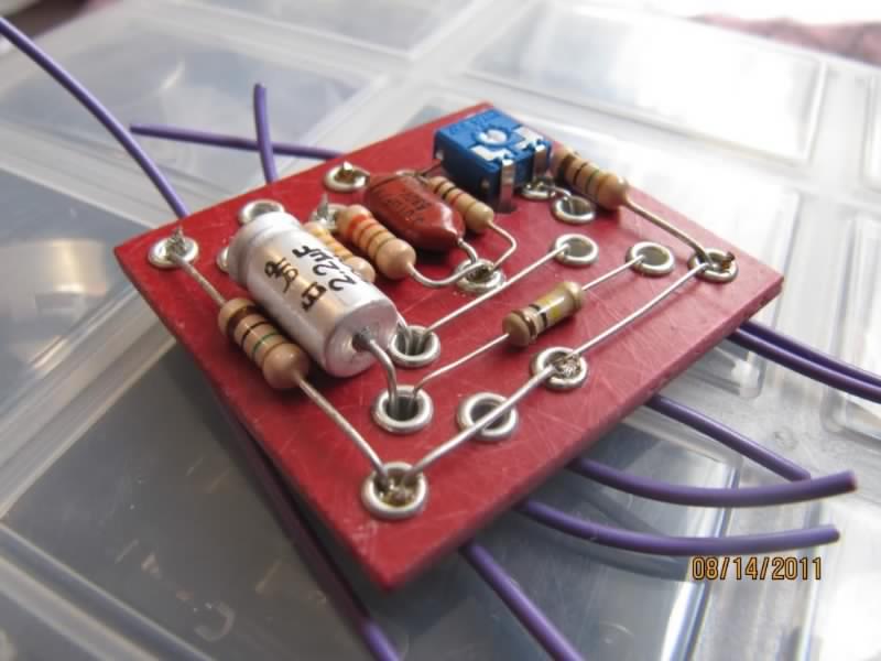

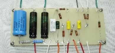

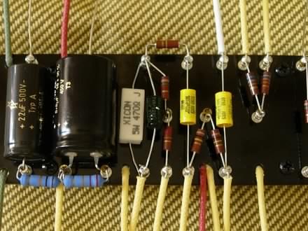

Ive just started getting into guitar pedals and amps. Im a first yr electronics student and would love to hear some input on this odd question i have.
I am noticing a lot of my favourite vintage amps have a certain vertical board layout. Any reason for this? Other than the obvious.
Also, just what are these boards and is there a name for this tactic? I love the look of it.
Pcb's seem to be a lot thicker than most modern amps ive looked inside of, as well.
What also caught my attention was the way the junctions are quite large.
Here are some pics to further illustrate what im talking about.

Those types of circuit boards would be considered eyelet board or turret board, the board in the middle is turret. Almost all of the GOOD vintage gheetar amps were made this way. Easy to repair and modify if that's your game. Easier to make than point to point and easier to repair that printed circuit boards. Fender, Marshall, Vox, Laney, HiWatt, etc. were made this way. Orange amps were PCB even back then.
Craig
Welcome!
Those are eyelet boards.
PCB- the 'PC' is 'printed circuit' which those boards don't have.
