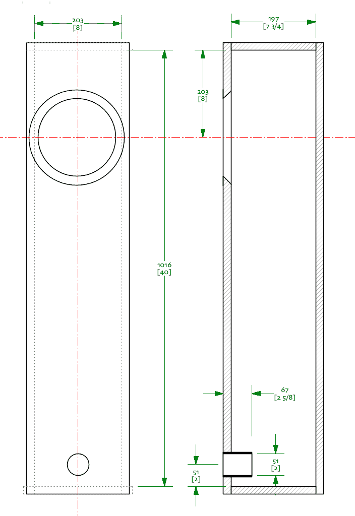

Here is an ML-TL.
attachment.php
We built a set of miniOnkens for the 6.5” version of these Solen house brands. They were quite good (i have a pair of the same in my growin gpile to get out the door).
dave
I should add, quick & dirty as i left out lost of detail including a holey drace from the baffle to the back and maybe a couple strubs at the bottom. That will increase the gross width a bit to accomodate for the brace volume. That has th eside efect of giving the back of the driver a bit more room.
Damping is Woden-standard.
dave

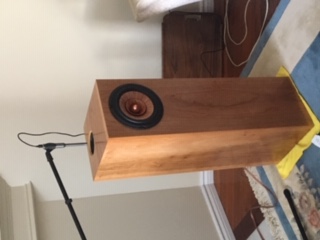

Update: overstuffed transmission line
Here is a summary of what I have done and learned so far. Thanks to all for your responses.
So, I built a set of transmission lines using a full range driver. These things get stuffed with long fibre wool to act as a filter for the upper mid frequencies as the sound passes through the transmission line.
After a break in period, I found the bass was anemic. Not at all what I would expect from a set of transmission line speakers. I did a fair bit of research and got to wondering whether I had overstuffed the cabinet. It turns out I had miscalculated the internal volume so I had indeed overstuffed it by about a third. I spent Friday pulling out the excess stuffing, and after listening concluded the bass was noticeably improved.

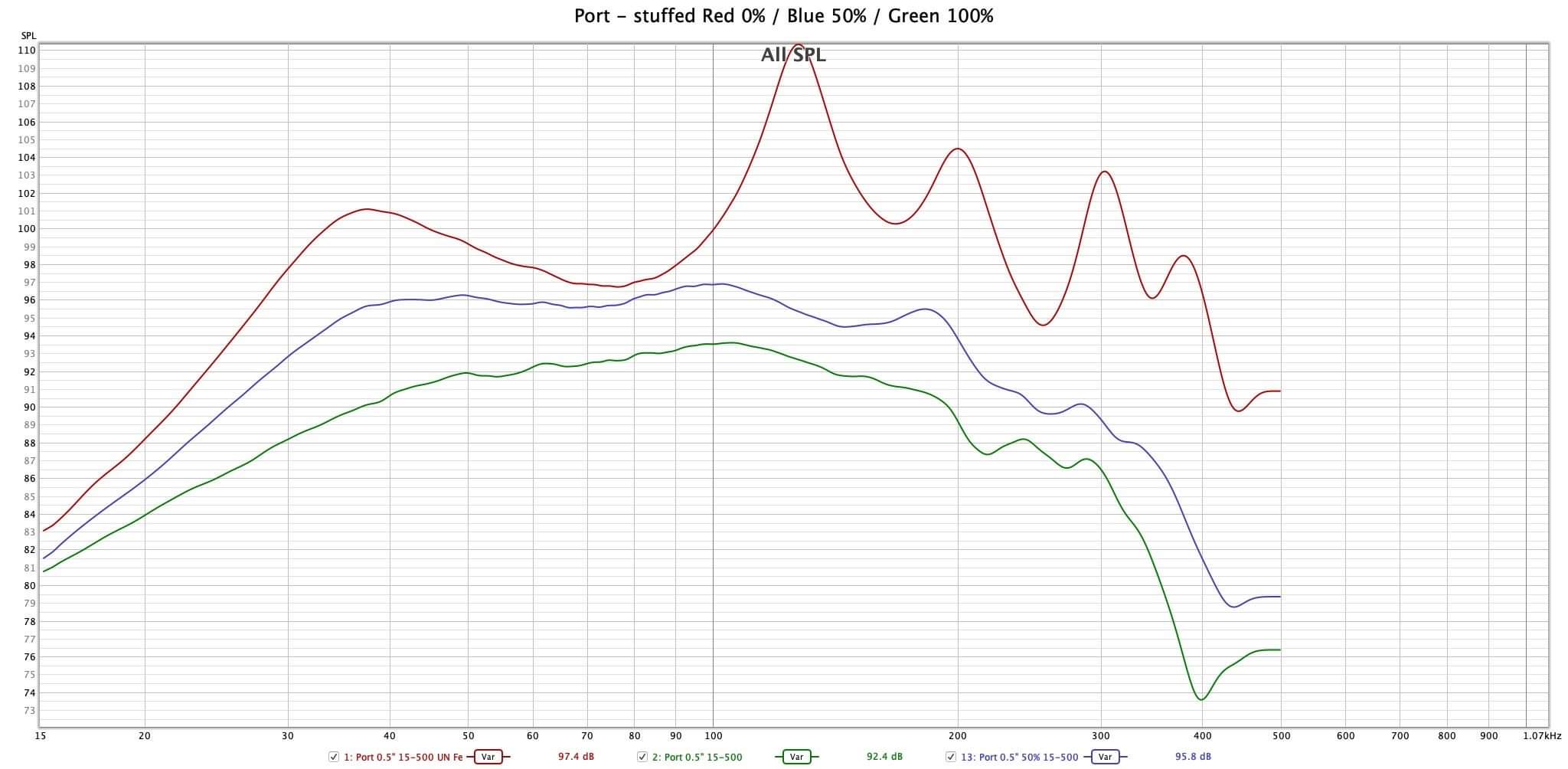

Yesterday my buddy came over, and we went through a series of frequency measurements.
When we ran our frequency response sweeps on the driver itself we noticed a significant dip in the 50 to 100 Hz region. I had read some research suggesting that one need not stuff the entire transmission line, but only the first half. So, we did an experiment.
The port response with all of the stuffing removed showed quite noticeable oscillations due to internal cabinet reflections.
When the cabinets stuffed along the entire length of the transmission line with a density of 0.5 pounds per cubic foot, the internal cabinet reflections are now gone, but in the 50 to 100 Hz range and there is a fair bit of rolloff.
When only the first half of the transmission line is stuffed with wool (with the second half of the line is completely empty), the improvement in bass response is considerable, (about 6 db louder) and the graph is flatter. So, in conclusion at least for this particular driver, one need not stuff the transmission line completely.
Not only that, but when we did a full sweep of the driver, the graph we got very closely matched what was published by the manufacturer. This proves that our equipment is working correctly, and the driver is behaving as the manufacturer states.
Many thanks to my buddy for the opportunity to do this and basically tweak the results of my speaker design.
