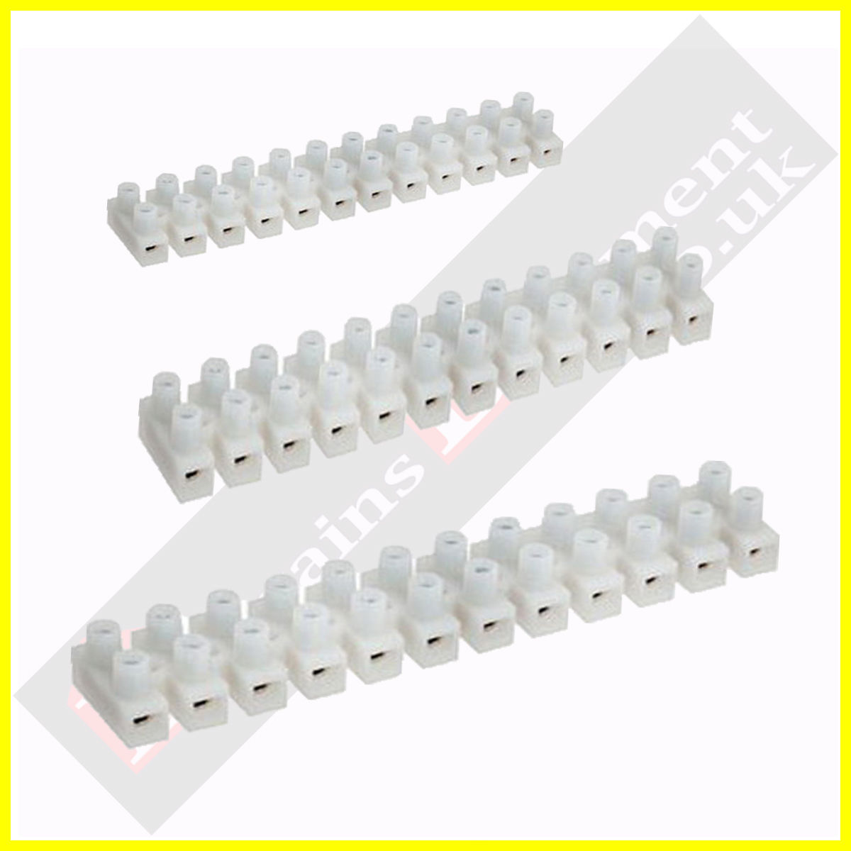

Buy a screw down insulated terminal block. You need 2ways. But they usuaully come in 10ways or 12ways. You just snip off 2ways and keep the remainder for the next time. 5A or 6A is big enough.
If your stranded wire is quite small then I suggest you bare about 12mm of strands and twist them tightly. Then fold that end in half to leave you a 6mm double strand.
That will clamp doen under the screw much better than using the single.
