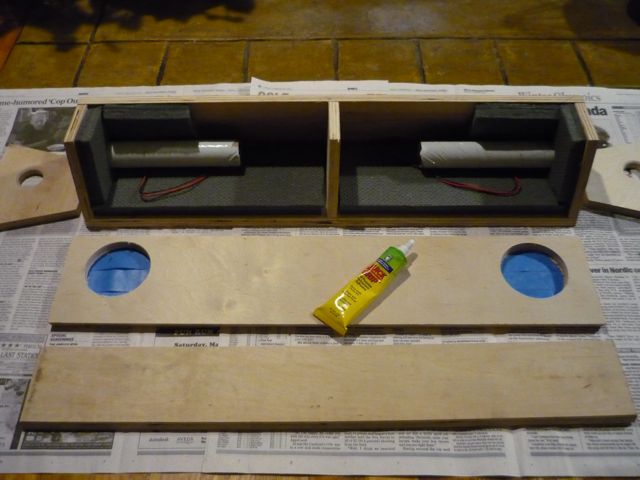

Bringing this thread to a close, here is the completed Soundbar, using a 7.5" cardboard tube as the bass reflex port, and attaching a Dayton DTA-1 T-amp as power.
First pic is assembly details with the internal dividers, port tube, and padding in place. Glue from the hobby store worked just fine.
Sounds pretty good. Lots of bass, maybe just a tad uncontrolled, and lacks "sparkle" on the high end. But very pleasant sound.
And it sure sounds better than the built in speakers in that laptop!
Looks very nice - like the kind of thing you could go out and buy......
If the bass isn't quite right, you might want to experiment with stuffing the ports a little, or playing with stuffing in the box itself.
Chris
Chris
Try stuffing it almost completely with fiber glass to control the bass a bit. If it's still bad try stuffing the ports too. The Aurasound speakers have a highish Q so they play happier in sealed cabs. If you try to model it through WinISD, you'll find that the group delay is quite large when ported.
