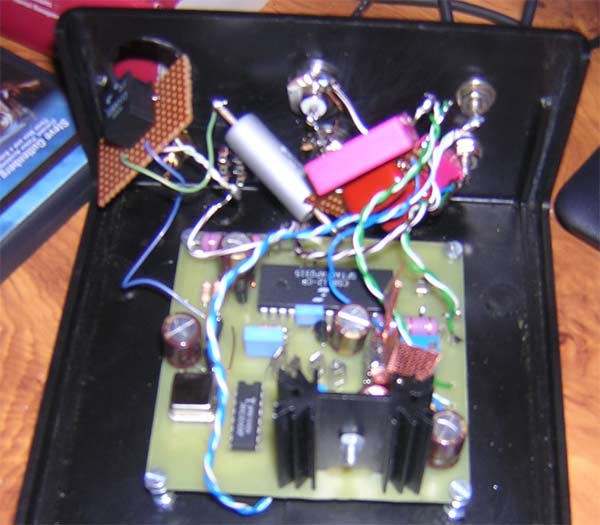

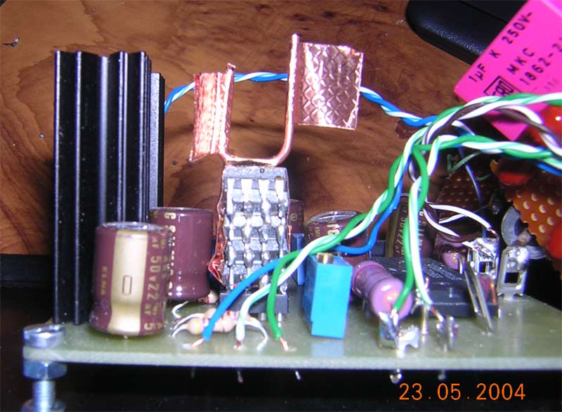

Ready steady .......COOK!
Could have done it better though...but it works!
I made a sandwitch of TDA1543..copper foil...heat conducting foil TDA1543 and so on and so on..one foul all around..soldered together...some copper wire with copper foil flags...works !
Before I had the flags..I left the dac on...left home...only to come back to heavily distorted music...he he..they had gotten too hot
